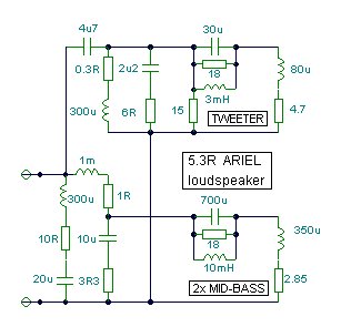

I'd like to do some amplifier testing with inductive loads. Is there any recognized standard that is used for such purposes? If not, does anyone have a typical model?
I lookd at the links and there is a bill of materials for the generic speaker. However there is no schematic. Am I missing something?
