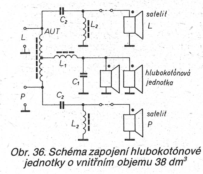

That is pretty much exactly the can of worms I visualized in my head when I typed my post #15. Except that I visualized two individual inductors, rather than two lumped into a single autotransformer, and a third one tacked on for no particular reason. 🙂I have article about 2.1 passive, but it includes custom made inductor.
Since there is a third inductor tacked on, it looks like you could obtain a 4th order low-pass filter (instead of only a 2nd order) by adding just one more capacitor, from ground to the junction of the three inductors. (New cap in a fetching shade of pink in the diagram I just drew up.)
A little tinkering around in LTSpice would confirm or refute my idea.
Note that there are many serious flaws in this scheme as presented:
1) The subwoofer upper cut off frequency is not adjustable, making it unlikely to integrate well (crossover smoothly) with the woofers unless everything is measured with a good measurement microphone, and inductors are custom-wound by trial and error.
2) There are no loudness (sensitivity) adjustments for either subwoofer or main woofers, again, making it hard to crossover well from one to the other.
3) There will almost certainly be a big spike in the low frequency response of the satellite speakers ('satelit'), below their intended lowest frequency, because of the peak in their impedance curves at their fundamental resonance frequencies.
4) That spike in the satellite speaker acoustic response will, once again, prevent the satellites from integrating well with the subwoofer.
In my view, this is a big, expensive can of worms, and one that won't even work well when finished.
It may have made sense a few decades ago, when individual amplifiers were huge and expensive, and winding custom inductors was a much cheaper solution.
But in the era of small, light, cheap, clean class-D audio boards, even cheaper op-amps, and easy active filter design, this old passive 2.1 scheme is best left to gently gather dust in the archives.
-Gnobuddy
The problem with using inductors at the beginning is that they have a low impedance at low frequencies, you'd effectively short the outputs of the amp.
Yikes. You are absolutely right, and I totally overlooked that.AllenB said:...inductors...at low frequencies...effectively short the outputs of the amp.
I would say there is more than one problem with that design, but shorting the outputs at low frequencies certainly takes the cake!
-Gnobuddy

- Speaker level passive "2.1" crossover?
