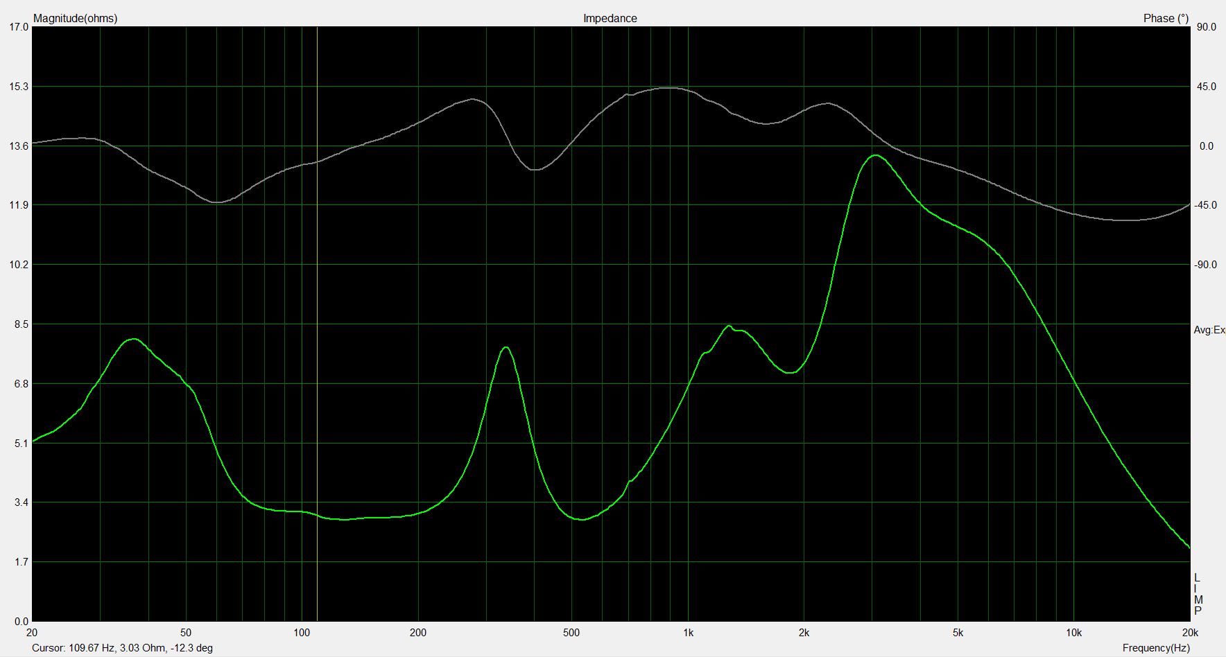

I had built 3 way speaker, the crossover was order form a crossover's professional.
In my testing with ARTA LIMP i find this result ...
What can i learn form that result, good/bad, cutting points etc.
thanks

hi,
The little kinks show resonance issues at those frequencies.
The drop to low impedance at high frequencies is poor, and
indicates to me a crossover design error, it is not good for
amplifiers at all, you want high impedance at high frequencies.
rgds, sreten.
