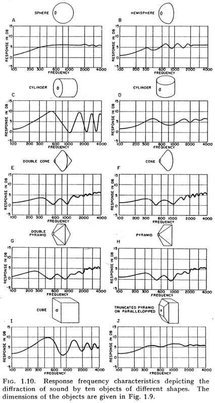

Study these carefully and make up your mind after that 😉...
attachment.php
You'll agree (I hope) that a flat cylinder wouldn't exactly be the best shape.
Thanks for the comment. So looks like the Sphere give the flattest response. Will tray and aim for that in the Woofer.

What is the difference between a flat baffle and (hypothetically) no baffle? If you embrace the idea you might find there is no problem that needs (or can) be fixed by eliminating the front in this kind of design. Anyway, that small mounting surface will be a half space baffle especially at higher frequencies, and doesn't sound like a good idea to leave it like that. You could provide easement at least.

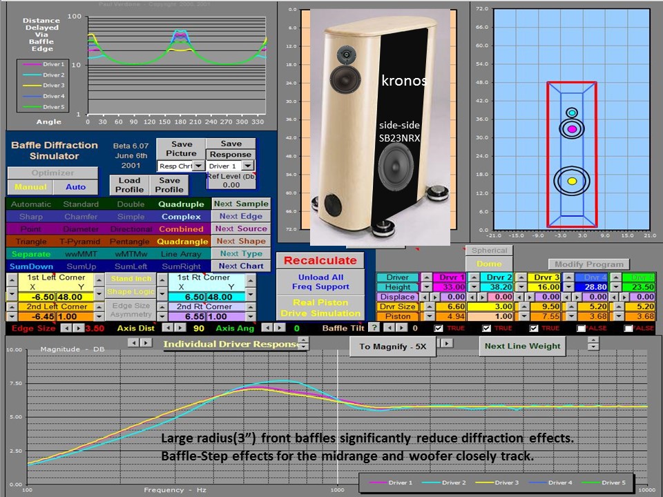

A simple baffle diffraction simulation of large round overs for a T-M-W 3-way baffle illustrates low tweeter diffraction effects through the crossover, which should produce a consistent soundstage through the TM crossover. Below the tweeter crossover, both the M and W generate similar 1.8db slow baffle humps, which then correctly linearly drop with the baffle W*H dimentional effects. Textbook crossovers perform well with rounded baffles. A pair of side-side counter-force woofers can significangly reduce vibration. You can still taper(angle cut) the volume behind the midrange and use multi-hole bracing to reduce bass resonances. Many cabinet shops have a 3" quarter-round cutter. You can purchase 3" to 6" radius molded MDF quarter round edge material. Trans-Laminate construction is probably the best solution for high performance cabinets. CNC + 10 sheets of MDF + GLUE.
---Big round overs = Small diffraction effects = Smooth and Uniform soundstage =??= NEUTRAL?

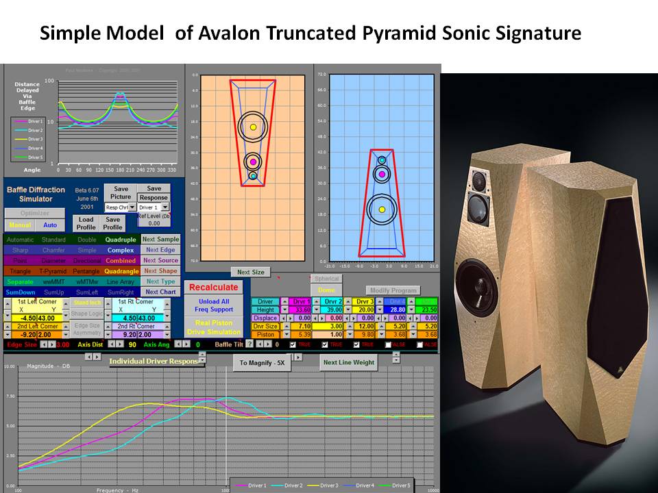

Octavia: The tapered truncated pyramid cabinet constructed and measured in 1950 by Dr. Harry Olson, and marketed by Avalon usually sounds accurate and "interesting" in most rooms. Why? A simple baffle diffraction simulation illustrates how the T and M each produce low but variable triangle-bevel diffraction generated dither in their frequency band.
---Deep bevels = reduced but irregular diffraction effects = comfortable yet interesting soundstage =??= CAPTIVATING?

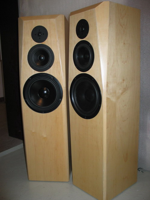

The Visaton website has a diy Avalon-style design with an 8" woofer called Sonja. You can free download BoxSim CAD with all the speaker models for Visaton drivers.

@Planet10.. duplicated by hand from actual measurements I'm presuming.
@Charlie, even if these were 'pre-computer baffle simulations' they contain enough information to be educational.
Flat from 100-4000, you could invert the non baffle affected response and add it to the result.
Olson used a small (2 inch dome) source in the exact geometric center of a shape that was ~24" across. Worst case in all measurements. Putting it slightly off center (or having the entire face as the radiating surface) smooths things out quite a bit.

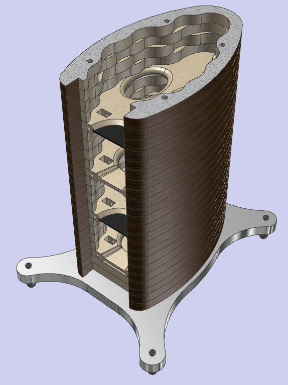

I think the OP is too focused on what is behind the speakers (doesn't really matter much as long as it is damped) and not focused enough on the rest of the design task, which is much more important. Flush mounting, crossover, etc is way more important.
The desire to use fiberglass skills opens up a huge range of possible enclosure shapes.
