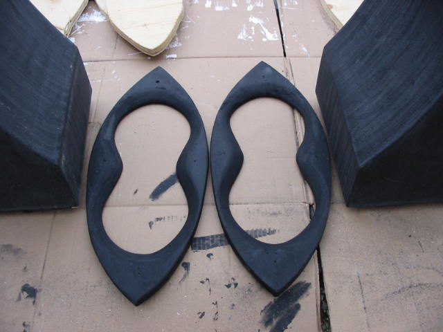

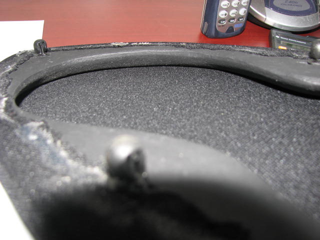

In a sense, 'C' and 'D' almost create something of a horn effect; gently, hopefully, unloading the sound.
But I wonder if the sound passing over the crest of the curve in the 'D' model doesn't see that crest the same as a sharp edge?
Again, I'm just wondering why, when we know the 'B' version has real drawbacks, no one has come up with something better.
People strive to great lengths, rounding, recessing, and beveling, to make the cabinets sound right, only to compromise all that work by adding type-B speaker grills?
I have a pair of JBL towers that use a one piece molded plastic grills that have something of a diamond pattern to them. The advantages are that the edges of the frame are very narrow, but they are also very sharp. Also, all those criss-crossing diamond shapes are all sharp edges.
One drawback to the Type-D is that it might encroach into the space of the woofers. People are making cabinet fronts narrower and narrower. Still a person could so something like you did and cut into the 'picture frame' to make room, the soften the edges by smoothing, beveling, and rounding them.
Unless I am mistaken the edge diffraction is more of a high frequency problem.
Just curious.
