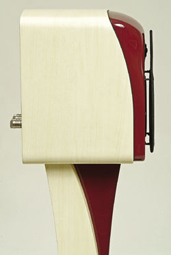

I never heard a difference with the front fabric or without !
I believe if someone can hear Something : this is the frame but not the fabric on it ! also some are not damped (need rubber plugs to attach it on the front bafle) !
You need thick tee-shirt on a tweeter or a mid to hear attenuation ! But in A/B, never see a guy able to make a difference ! And this is the easiest blind test to do !
Anywhay, they should be like the one they made for the Boston Acoustic Lynnfield serie for instance !: no resonant plastic open frame (side frames are also empty )!
WHen Something hears a difference I bet for an off axis of his head : many speakers are directiv enough to sound different with just 1 or 2 cm of lateral or in depth head moving !
http://www.canuckaudiomart.com/details/135589-boston_acoustics_lynnfield_400l/images/155898/
anyway we talk about the tweeter only if Something is hearable ! Maybe AMT and Ribbon, ESL are more sensitive to front wooden frame ! But not so sure : what is the names of the big metal polarized frames on a ESL ? Do you think you can hear less than a wirered stator for instance ??? I'm not sure !
