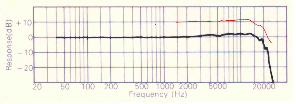

Close 🙂 I used a spark discharge, which is actually a doublet (+6dB/octave) to make this plot. I used it to measure the flattest capsule I had, the CP3 pin-point omni from Nakamichi. If I had a calibrated B&K I'd bet with averaging I could get +-.5 dB or better match. I used nothing but a good soundcard and Audition/Cooledit2000.
My measurement is the red offset by +10dB.
Thank you Guru Wurcer 😎

Scott's got it. Just understanding the fundamental physics involved, a spark will give you an extremely precise and very wideband impulse, from a small omnidirectional point source. No real tweeter (let alone whizzers) could even pretend to match this. Not by a mile. Well, maaaaybe a plasma tweeter. Maybe.
I imagine there are several caveats to setting up the spark gap and power source correctly to get the impulse you want. But it should be fairly easy to get excellent results once it's functioning.
Of course, a spark will only cover the treble. A stick of dynamite should go much lower, and test the reliability of your mike at the same time. 😀
Seriously though, the low end could be filled in with data from a decent cone driver.
