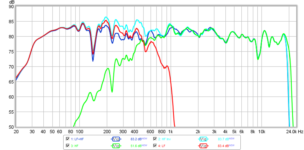

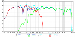

I am working towards an all horn monitor that is of a reasonable size. This one is a 16in cube. Is that too big? What kind of specs are you looking for with Max SPL, bass extension, HD, etc ? The Trynergy has very low distortion and is also quasi transient perfect and good flat phase response. I am not there yet but looking for criteria that a pro mastering engineer would be looking for.

Neat!
For my own tastes though, I'd say there's a bit of a midrange hump. The tweeter ends in a good place, but i'd consider lowering the resposne between 300Hz and 3kHz just a couple of db.
Also can you post the individual drivers with individual phase response? And /or with tweeter inverted? I'd love to see that. You are cheating by doing this all in DSP though. 🙂 🙂 🙂

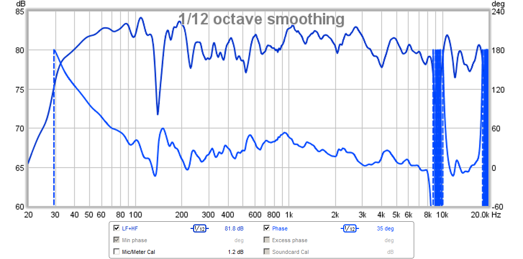

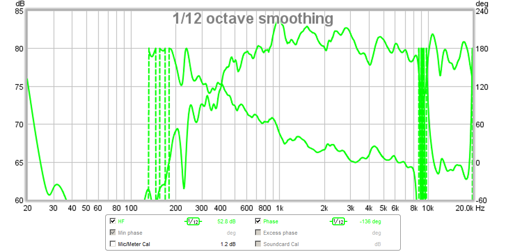

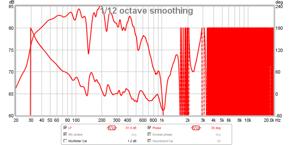

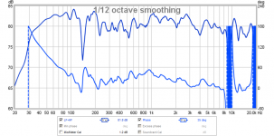

Here is the info you requested. Note that a Harsch Xo does not have a deep null when tweeter is flipped in polarity. It's asymmetric 4th and 2nd order filters with a large time delay equal to half a period at XO frequency.
Tweeter inverted is light blue:
Tweeter phase:
Woofer phase:
Combined phase:
I think I already have a slight tilt of about -3dB from bass to HF - you like more than that? Easy with miniDSP.
