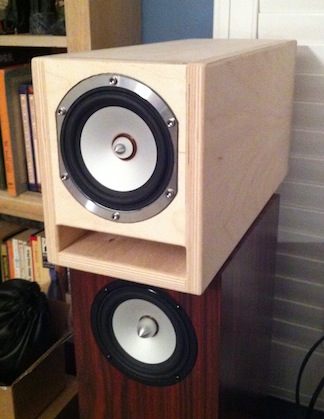

Here one of the finished boxes in baltic birch plywood...they sound amazing.
