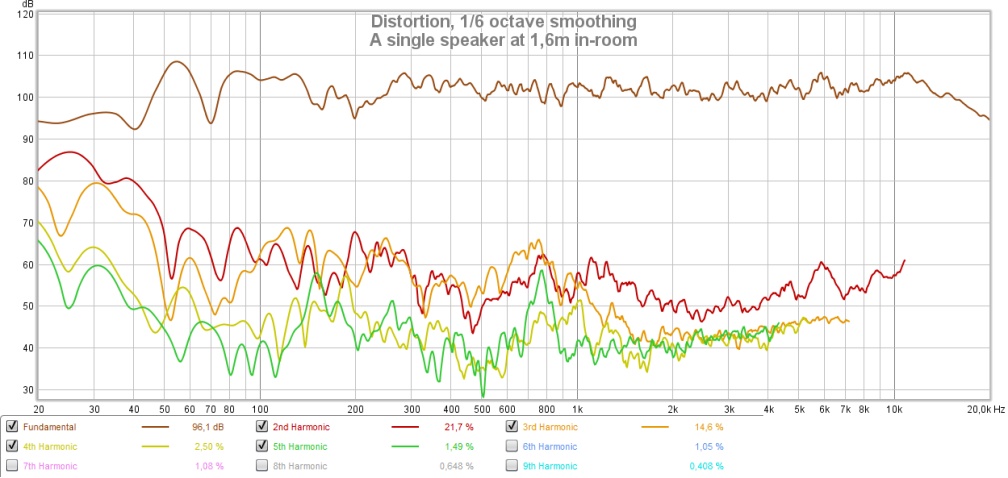

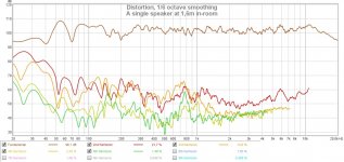

I haven't dome measurements at very low spl, but searched for power compression. This is a 4-way speaker, but a single driver behaves basically alike. Our hearing has diffrent sensitivity per frequency, Fletcher-Munson curves.
Distortion is quite low at typical listening spl and we can read several tests about when it gets audible (frequency dependant). REW can show fundamental and distortion spl simultaneously. Some examples.

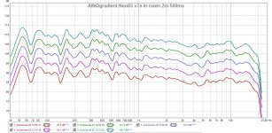

OK I found my DMS37 measurements. These were taken in room at 30cm distance, 16th octave smoothed.
From -25db to -10db (I think -25db was 2.8V) The sweep was high passed at 200Hz. The tweeter was being tortured therefore at the -10db level! I probably should do it again but with a HP at say 1Khz and see if that changes anything.
First is just the plots relative to each other. Note that the -25db I have had to fudge the absolute level, because it was taken with the mic preamp on high gain, and I had to go to lower gain for the other three.
Tony.
Tony.

Yes, the curves look good and all. I have never questioned them. But the whole point with the thread was to point out that flat curves isn't everything. I am not asking whether the curves are flat or not. Or if they change shape with sound pressure. I am asking if the sound pressure increases linearily with input. All I have seen is that if you increase the sound pressure 15dB the sound pressure will increase 15dB. It says nothing. But I haven't seen actual measurement of how much input power that differs between the two.I don't know what you are not seeing in the FR curves that have been shown? It's the fact that they track each other so uniformly that shows they change very little with level
Will a 32-fold decrease in input power result in 15dB lower sound pressure? Or will it be 16 or 17dB lower? The fact that the curves track each other has nothing to do with how input scales with output. Friction and losses to heat are never linear unless you have a completely frictionless system. The question is how large they are, if they matter. Still haven't seen a single measurement.
Maybe there are numbers of input power somewhere that I've missed. But please show where if that is the case.

Another graph for the PC83 that was not done in a previous test. Since SPL (dB) is a logrithmic measure, the corresponding change in voltage must also be logrithmic (dB) to see the relationship. The relationship is linear and the slope is 1.
How did the levels scale with power input?
Any measurements of that?
See attached graph.
Should be able to calculate them. I mentioned in the post that -25db was 2.8V. That -25db is the INPUT volume level to the amp. as is the -20db and through to -10db The graph is what was picked up by the Mic with those input levels. SO if -25db is 2.8V (lets assume the tweeter is 8 ohms nominal) that is 1W
-10 db should be around 16V so that will be around 32W
On the last question, the first three curves are all relative, the last one as I said I fudged, because the mic preamp I had to switch to lower gain when I upped the levels. I reduced it 20db (which is the difference between the low and high gain settings of the mic preamp).
edit: the second graph I subtracted the difference from the -25db level measurement from each measurement and overlayed them to show the differences in response. so the -10db measurement had 15db subtracted.
