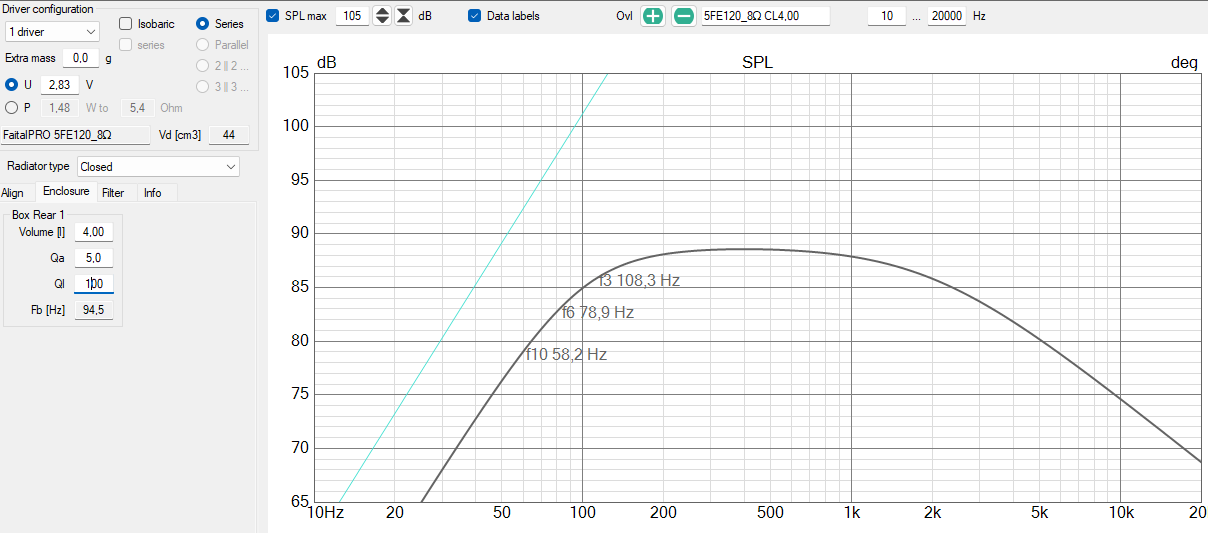

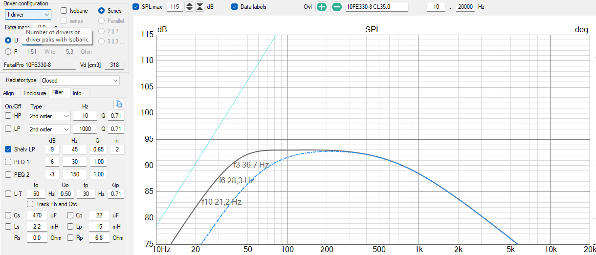

Project 1
I have no direct experience with the these drivers, but they are widely known/tested). I would cross them over at 300-400/2200-2500Hz).
Not a typical sub, but... FaitalPRO 10fe330 in 35L closed box, full stuffed with/without Bass eq. (blue line)
Sat
Midwoofer FaitalPRO 5fe120 (4L closed box full stuffed)
Tweeter Morel CAT378, CAT308
Sat

75L for a sub to play clean and loud to 20Hz is WAY too small.
Woofers with parameters to match will have heavy cones, weak magnets, or likely both. Also, large Xmax in small box = high non-linearity and distortion (ALWAYS).
There is no circumventing physics.
For a 'statement' sub like the one you claim to be after, you'll need AT LEAST double that volume. More would be even better.
Sorry if this isn't what you wanted to hear.
But someone had to sanity-check your unrealistic expectations.
