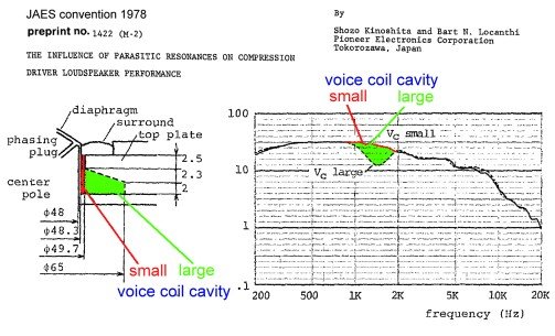

Upgraded phase plug, upgraded Be diaphragm, assembly and connections.
Redesigned motor structure, new magnet.
Since you referenced Jmmlc i added one of his documents concerning the TD-2001, then folowing the picture from the AES paper and research on the TD-2001/4001 by Locanthis/Kinoshita. So you can see some of the other issues that were targeted in the new design.
https://aes2.org/publications/elibrary-page/?id=2932
https://aes2.org/publications/elibrary-page/?id=2990
