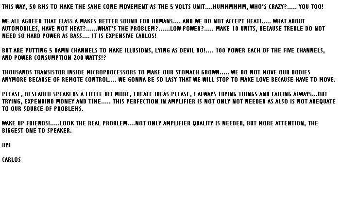

The worst equipment inside an audio chain will determinate the result quality
Speaker is the guilty.
five parts.... you will be nervous, if heart problems, do not read this.
regards,
Carlos
