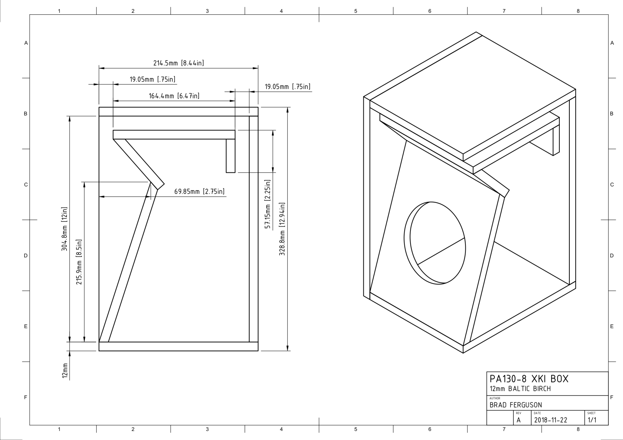

A Dayton PA130 XKi is too little to use for a stool -but sounds very good with a Kinter 3118 ~$20 12 volt amplifier. which has switchable tone controls.
9mm Baltic birch plywood is great - 1/2" cheaper would do as I have one X
Ki with a 12" which does ok (can feel some flex)
I'll have to find that nice plan and edit
20"x15"x15" could be a 10 inch driver XKi

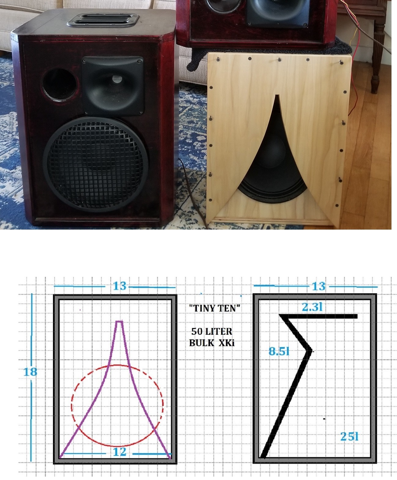

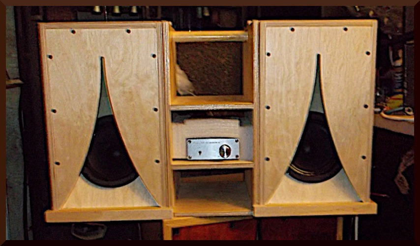

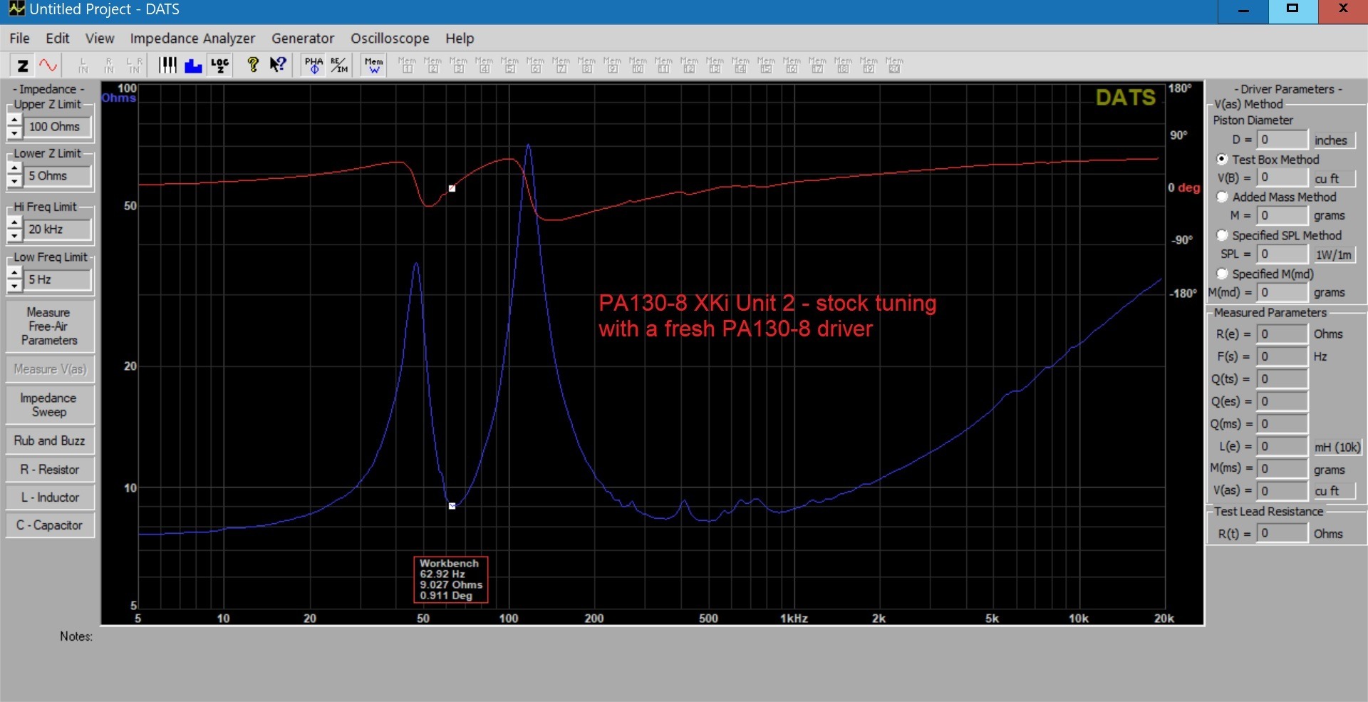

I have an 8 inch XKi made of 3/4" plywood which measures 11.5" wide by 10.25" deep by 15.5" high. Its tuned to ~60Hz with Beta 8cx
