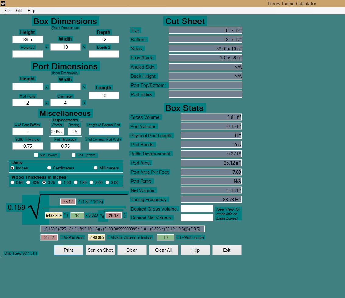

The Torres Box Tuning Calculator is popular with many in the car audio world.
I used it and liked it because it helped me create a slot port with angles for my home theater subwoofer.
I'm a big fan of how it calculates displacement for so many things.
You can change the background and text and box colors.
I preferred green.
