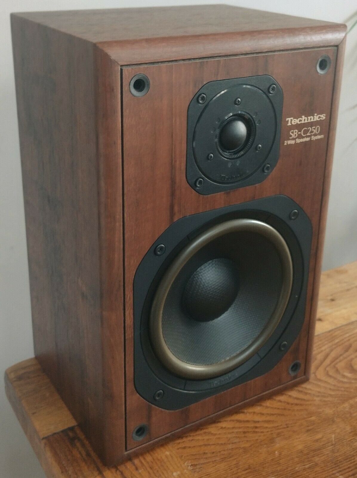

Have just acquired a pair of Technics SB C-250 vintage speakers.
Generally they’re positively reviewed and I’d like to get them performing at their optimum.

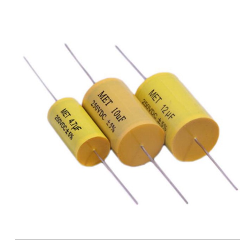

Technics will have taken the ESR of the capacitor into consideration when designing the crossover, so you may be best to substitute like for like.
You may change the sound for better of worse by using low ESR polyproplylene film capacitors instead - only substitution will tell if you like the result.

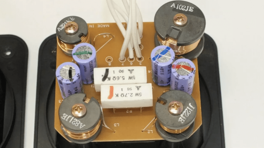

Thanks Galu.
Good advice.This is the crossover for the bigger brother 3 way SB C-350, but it provides a guide to the capacitors originally used.
I can see BP on the side of a couple of these. Does anyone know what's a similar contemporary type to these originals?
These are bipolar (BP) electrolytic capacitors - also known as non-polar (NP) electrolytic capacitors.
There is unlikely to be anything wrong with them as the speaker is not exactly what you would call "vintage".
If you insist on replacing them, search for radial bipolar electrolytic capacitors. Radial - that is if the capacitors look the same on your crossover.
