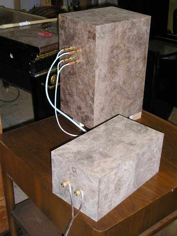

any recommendations on a connector for a 3-way which will utilize a external crossover? I'm probably going to house the crossover in the stand for now by placing the connector on the bottom of the speaker, but will also cut a canal for the wires to be routed out through the back in case the crossover was in my rack. Any reason why a barrier strip wouldn't be a good choice here?
connectors
I've used both barrier strips and banana plug/jack sets. I prefer the banana jacks , gold plated😉 (for obvious reasons), as they are easier to setup and modify.
same xover, different look....

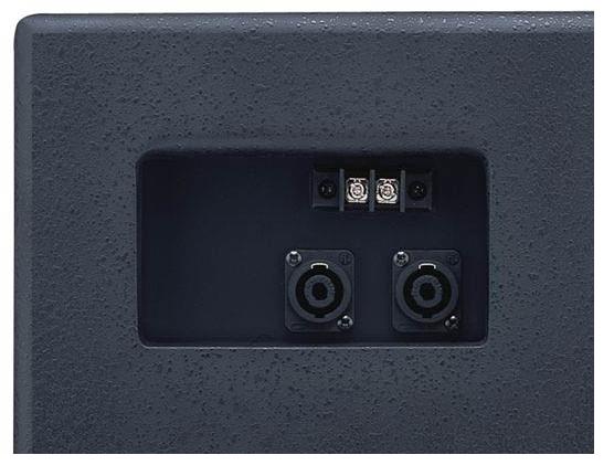

You could always consider the 8 way speakon connectors, as these will remove any chances of shorting, etc.
With the plans I am drawing up for my two ways, I plan to use the 4 way versions to connect the external crossovers to the cabinets.
On my 2 way speakers I use 4 pole Speakons, they are very good and relatively cheap. The only downside is they stick out a long way. they need a cup or an angled mount if you wish to put the backs of your speakers close to the wall.
You could use one of those + a set of banana plugs for the remaining driver.
If you want a single connector perhaps a 6 pin XLR.
