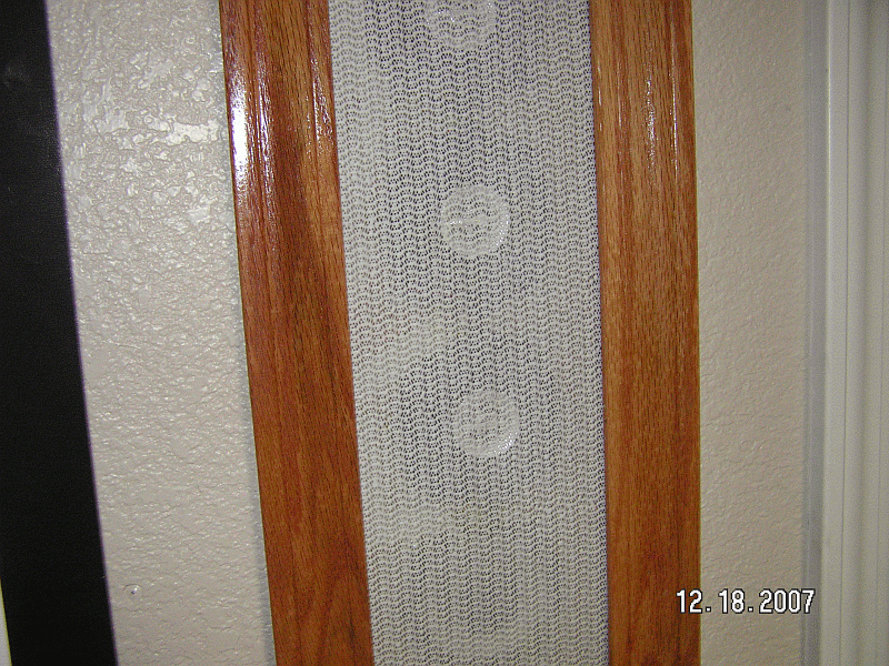

I bought a LA kit from Rick Craig at Selah Audio. This kit was very complete with all fasteners, wire, terminal cups, drivers, and crossover parts included. All I had to do was build my own cabinets. Here's a few pics:
One picture of the final assembly.
My finished Linus III's
