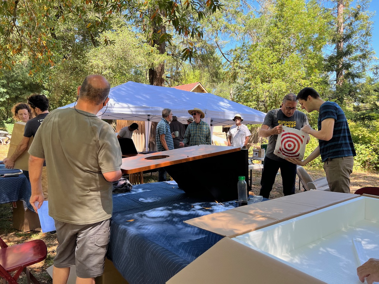

We are getting started on frame assembly:

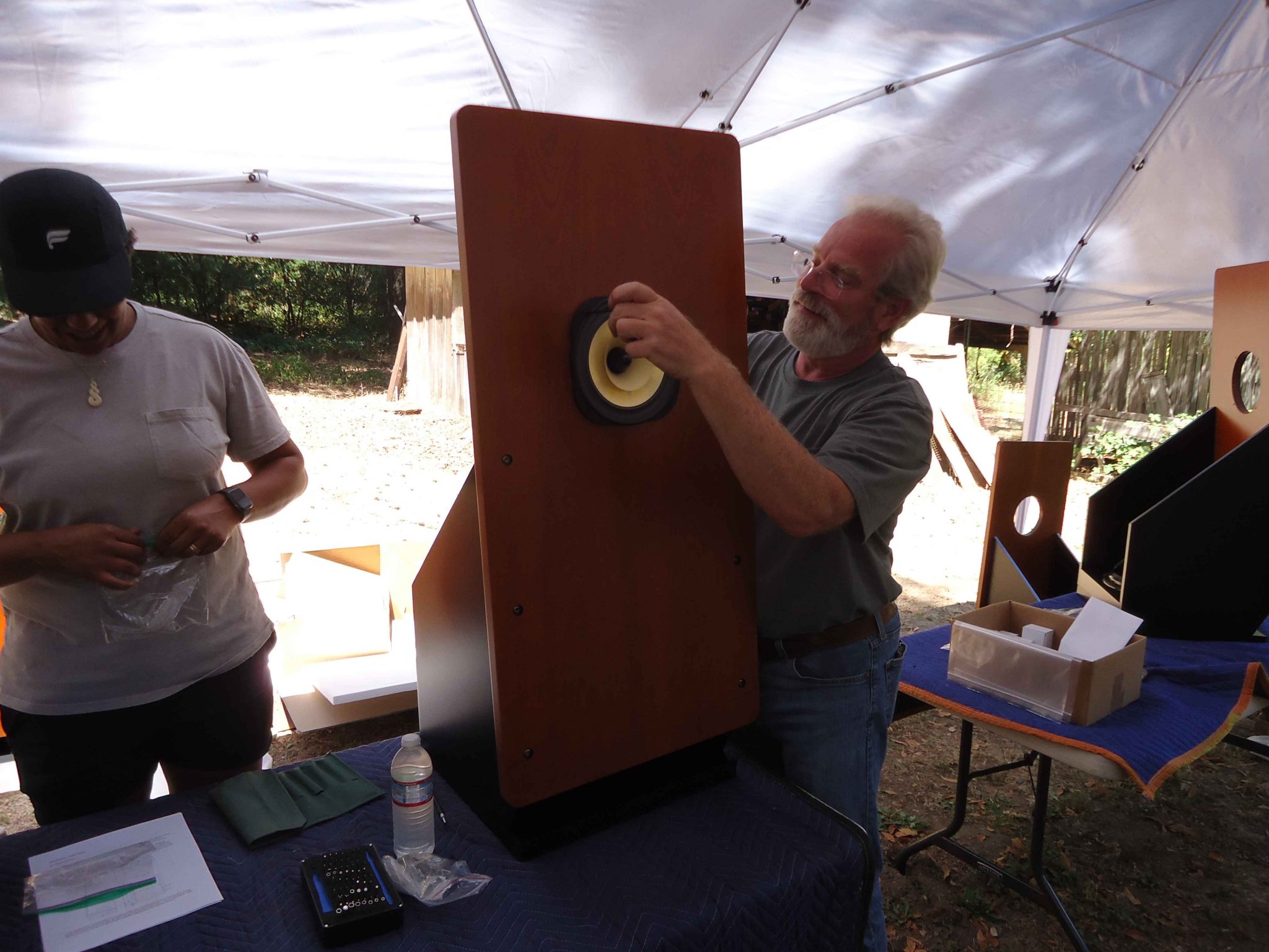

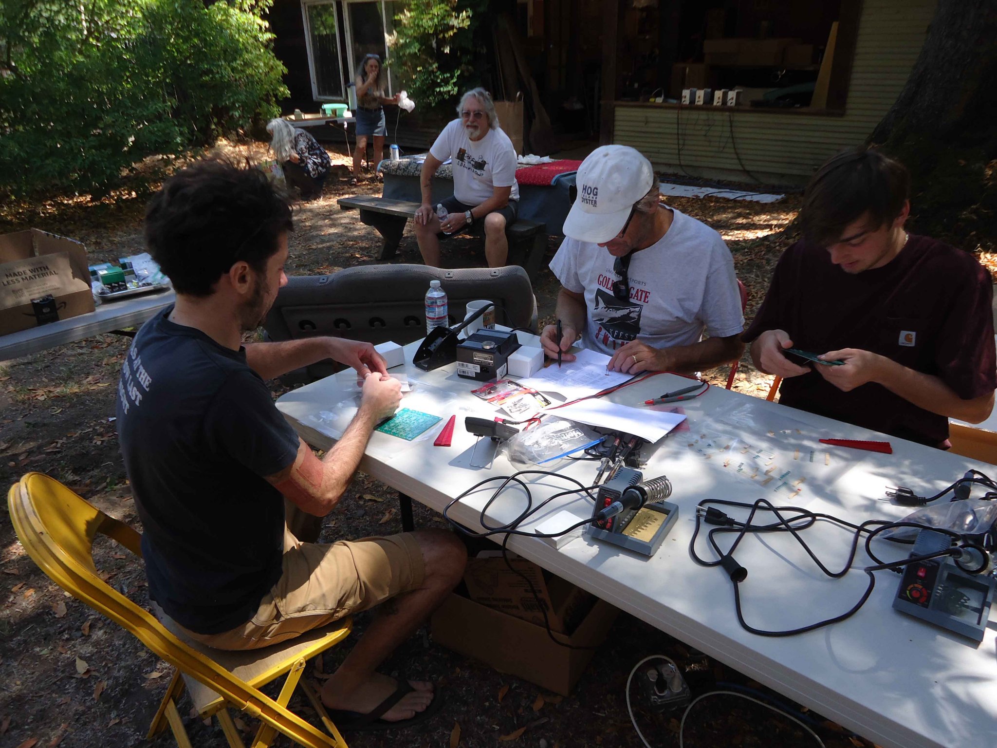

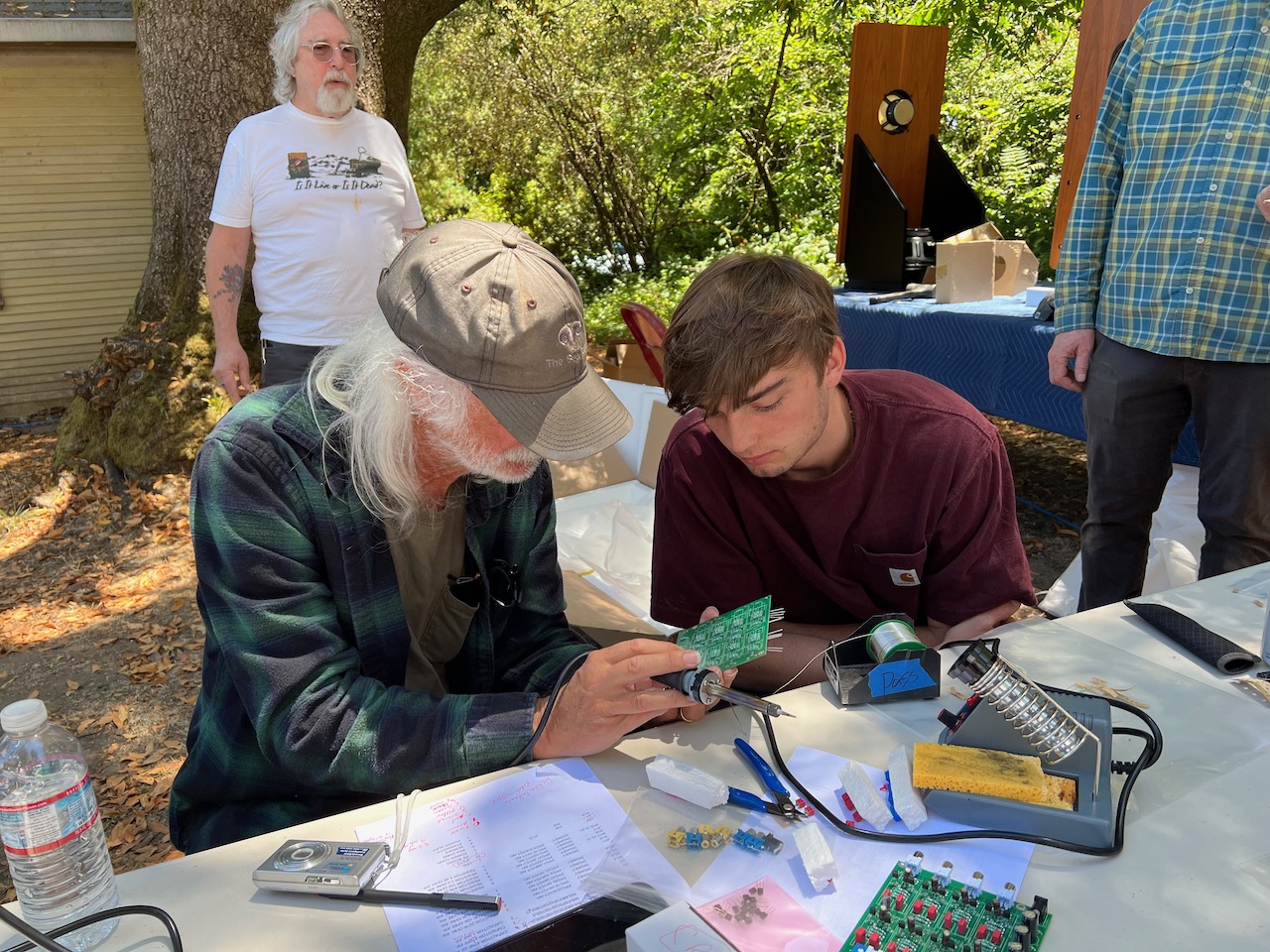

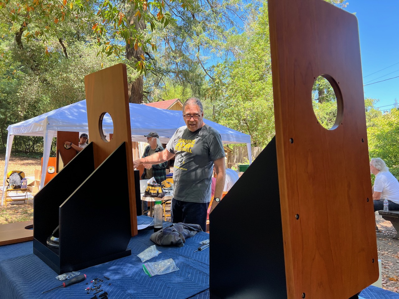

Some pictures from a fabulous day at Casa Brock!
1st: Soldering Lesson. 2nd: Me and my new Moths - Nelson Pass in background. 3rd: Burning Amp luminaries, Variac in checked shirt, Dana Brock with hat, Mario Yrun in white t-shirt, me in BAF t-shirt with Nelson Brock (ACA Redux).

I would have loved to be there and then row back to the Netherlands to save shipping costs for the SLOB + Moth.

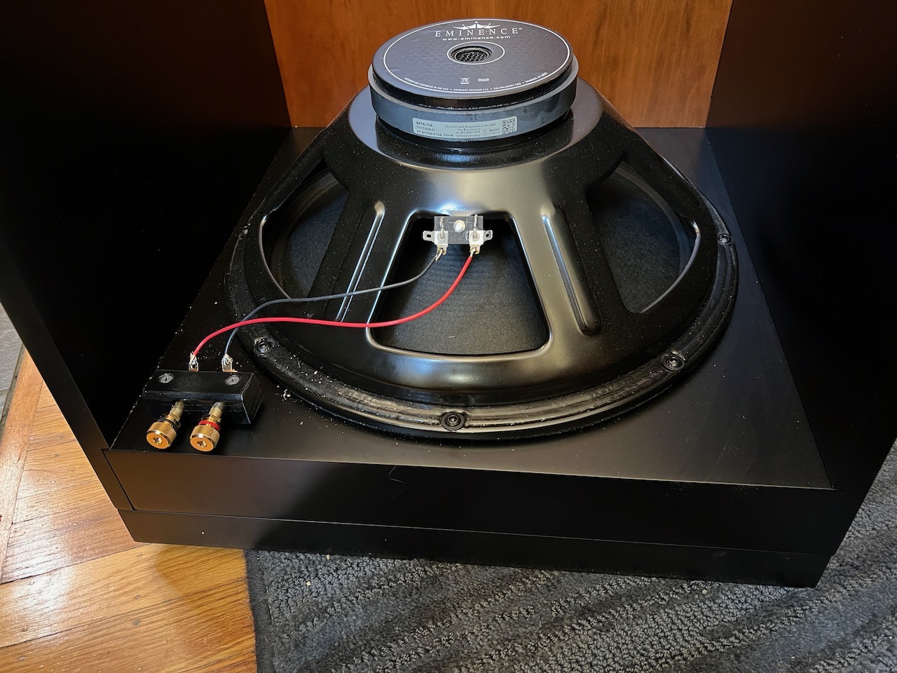

Will have to organize my 1 person speaker camp overhere. So please, what model Eminence woofer is used, cannot find the type however hard I search.
Or what ts specs should I look for to find a suitable alternative.

This was the Eminence Beta 15 inch. I have used similar drivers to good effect - it's not particularly critical.

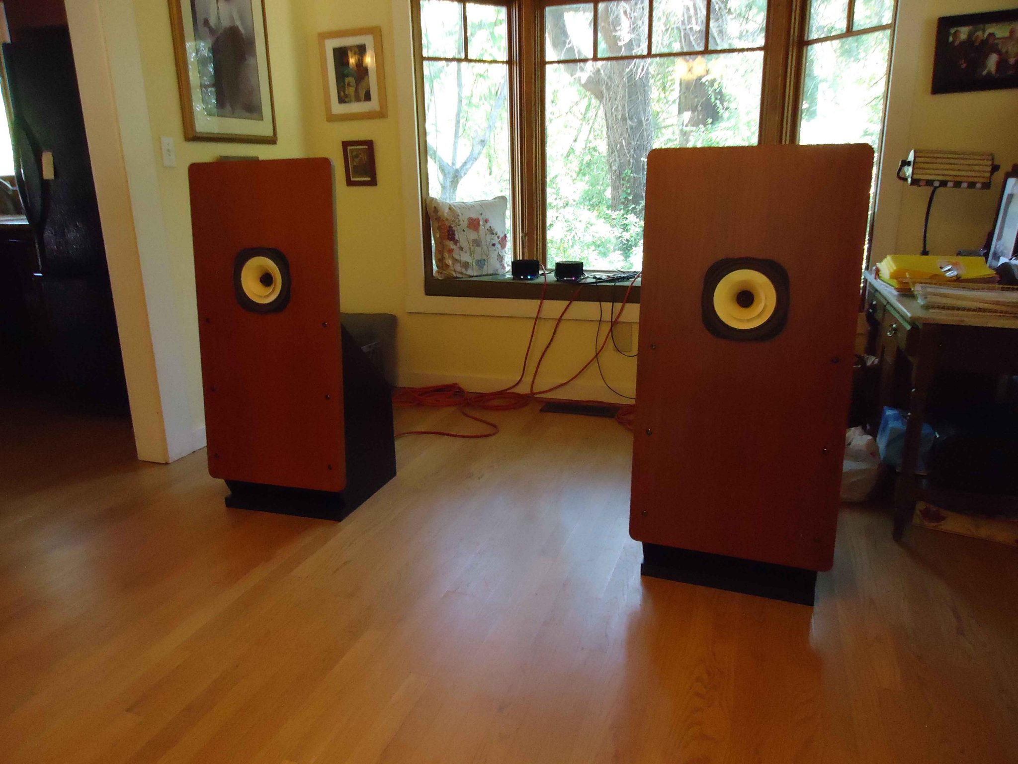

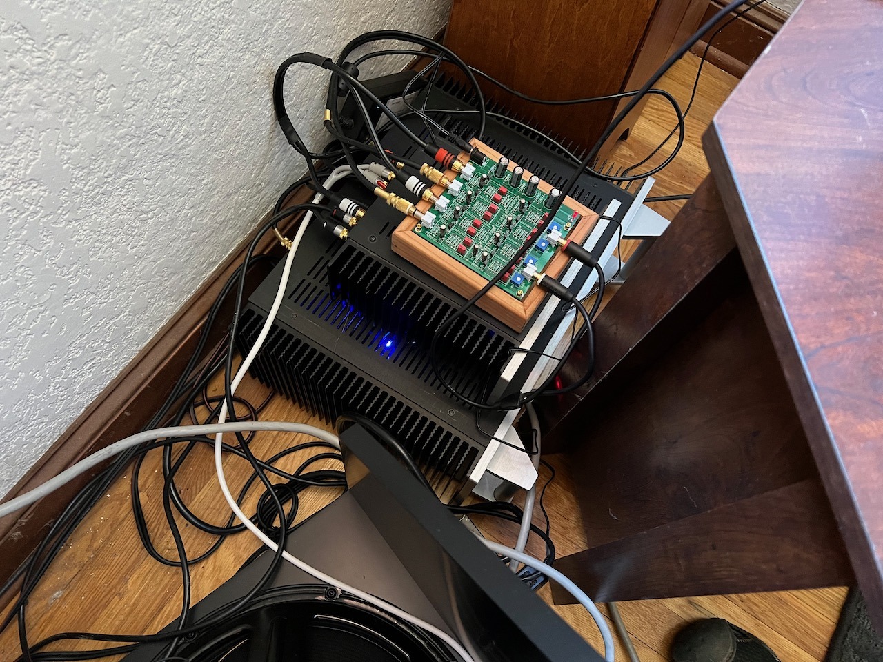

Finally!! I have got my Moths all wired up and stuffed into my too small living room. Driving the Moth's with an ACA and the woofers with an F6. By happy coincidence the pot settings of full on for both hi and lo seems to work just fine.
With zero hours on the drivers they sound VERY NICE!
