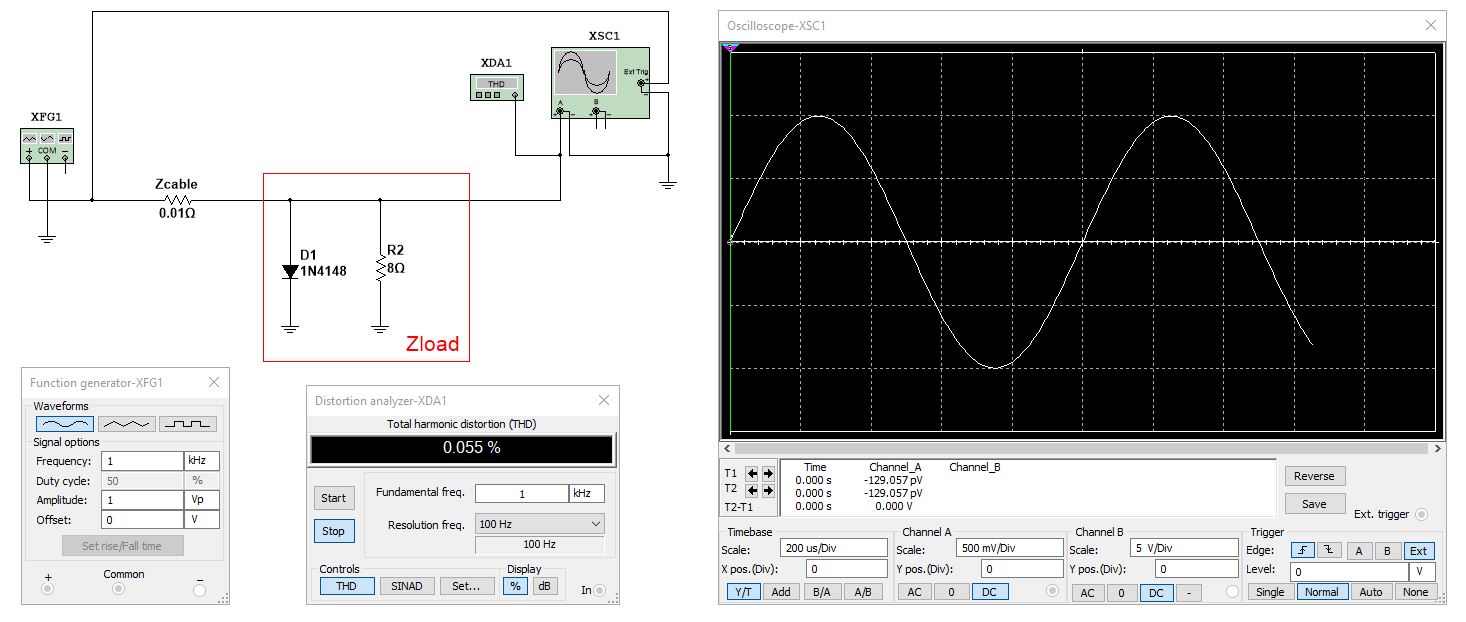

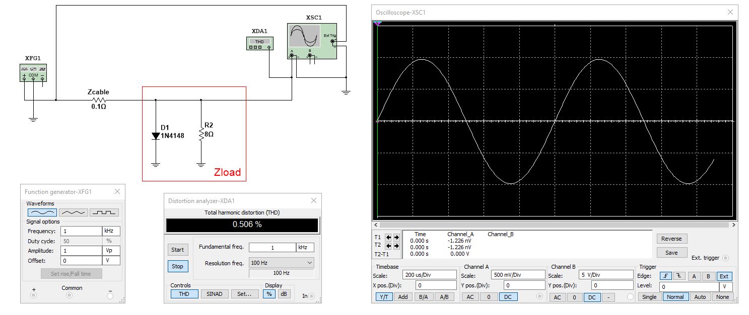

Hi All,
I think I understand what Pavel (BesPav) was trying to explain here.
Let's simplify the setup, assuming we've got an ideal amplifier (Zout = 0) and ideal connection terminals. Let's also simplify the complex Zcable and Zload to pure resistance. Zcable is linear, Zload is not linear.
Considering Zcable + Zload as a voltage divider, we can easily see that influence of Zload's non-linearity is proportional to Zcable / (Zcable + Zload).
Assuming Zload is a constant, the level of non-linearity, seen at Zload is proportional to Zcable. The lower Zcable -> the lower non-linearity is seen at Zload.
Meaning, the better the cable is -> the less distorted signal (Voltage) is seen at the speaker terminals.
A simple simulation, using a diode as a source of non-linearity, is shown in the pictures:
1) Zcable = 0.1R, THD at the load = 0.506%
2) Zcable = 0.01R, THD at the load = 0.055%
Conclusion: assuming the amplifier (linear enough) and the speaker (rather non-linear) are the given constants, we can minimize the speaker's non-linearity effect by using a better (lower Z) cable.
Note1: if the amplifier is not good enough - not linear enough, not low-Zout enough, not providing enough current for driving the speaker at certain swing/frequency - that's a different kind of problem.
Note2: even if we see the voltage at the speaker's terminals being rather low-distortion, that does not mean the acoustic distortion is also that low - a speaker as a transducer is non-linear anyway.
Note3: the higher the quality of the amplifier and the quality of the speakers are - the higher influence of the speaker cables on the quality of sound reproduction will be observed.
