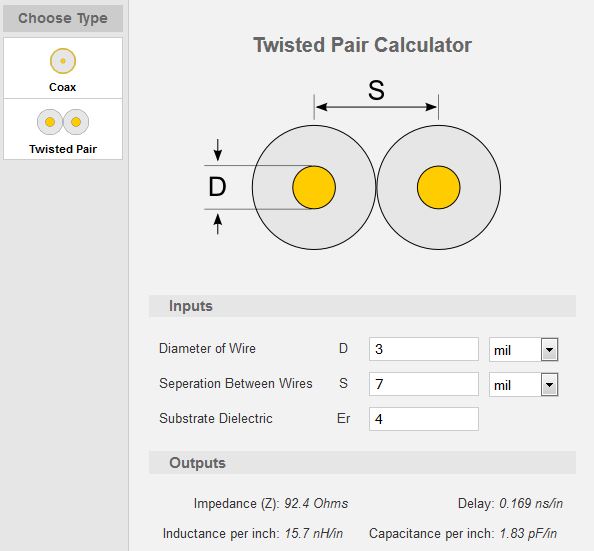

And getting the conductors as close as possible to each other is hardly controversial:
Twisted Pair | Electronics and Electrical Engineering Tools | EEWeb Community
It can reduce interference pickup. Not sure how this is connected with cable lifters, though.And getting the conductors as close as possible to each other is hardly controversial

Whether you use lumped parameters, or transmission line theory, you end up with smallish effects at audio frequency. The most I could get was about 1% tonal effects from the cable. And that's not distortion either, just tonal.
A cable inductance of 1uH really shouldn't affect a 50uH tweeter very much. 😕
The earthing (aka common-mode) problems with a 5m unbalanced cable don't look huge either.
So unless you have a very weird factor coming into play here, I think most of us are stumped by this. But it's made us think. 🙂
