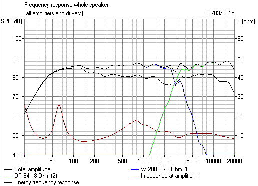

Some of us, from more mathematically informed backgrounds, have actually worked out something in this thread. Get the spacing of the cables down, keep the resistance low. I could add that it does no harm to keep impedance phase angles low if you want to keep a feedback amplifier happy. And keep speaker impedance roughly matched and resistive, which is about the same thing.
This is the correct technique. I'll leave the rest of you monkeys to continue botching it while pretending to be authorities. 😀
One of my efforts. Exemplary impedance, IMO. Uses those sweet sounding Zobels. Ought to sound good with anything.
