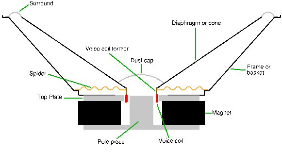

I know you don't want to contemplate it, but the 'buzzing' speaker certainly has a damaged voice coil. As Kay says, changing the orientation of the speaker, as in laying the amp on its face, will change the extent to which it buzzes.
If there was a fault in the amplifier, it would affect both speakers equally.
Apart from a damaged voice coil, other causes of speaker 'rattle' are:
If you are not familiar with the parts of a loudspeaker, then refer to the attached diagram.
- The paper cone can separate from the speaker basket. Make sure the cone is firmly stuck down all around its circumference.
- The dust cap can separate from the centre of the paper cone.
- The corrugated disc (the spider), which supports the rear of the paper cone near the magnet, can separate from the cone or the speaker basket.
