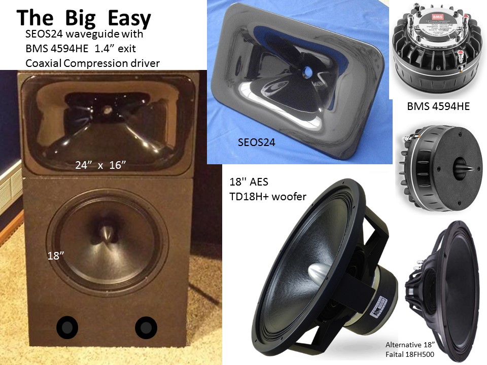

The larger horn on the Model_19 usually earns the winning vote, especially in larger rooms where the listener is over 8' away.
-Check the latest prices at GPA on parts for the Model_19 and Altec 604.
-Newer tech like the BMS 4594ND coaxial compression driver, OS and eJMLC profile waveguides are in the same price range.
-Since you own Pi 4 speakers, you might decide to study a few "big-jump" designs before you make a decision.

Small room go coax. Bigger room use the horn. That's been my experience. Both sound good, but the Model 19 sounds bigger to me. There are some good crossover designs published for the coax,
