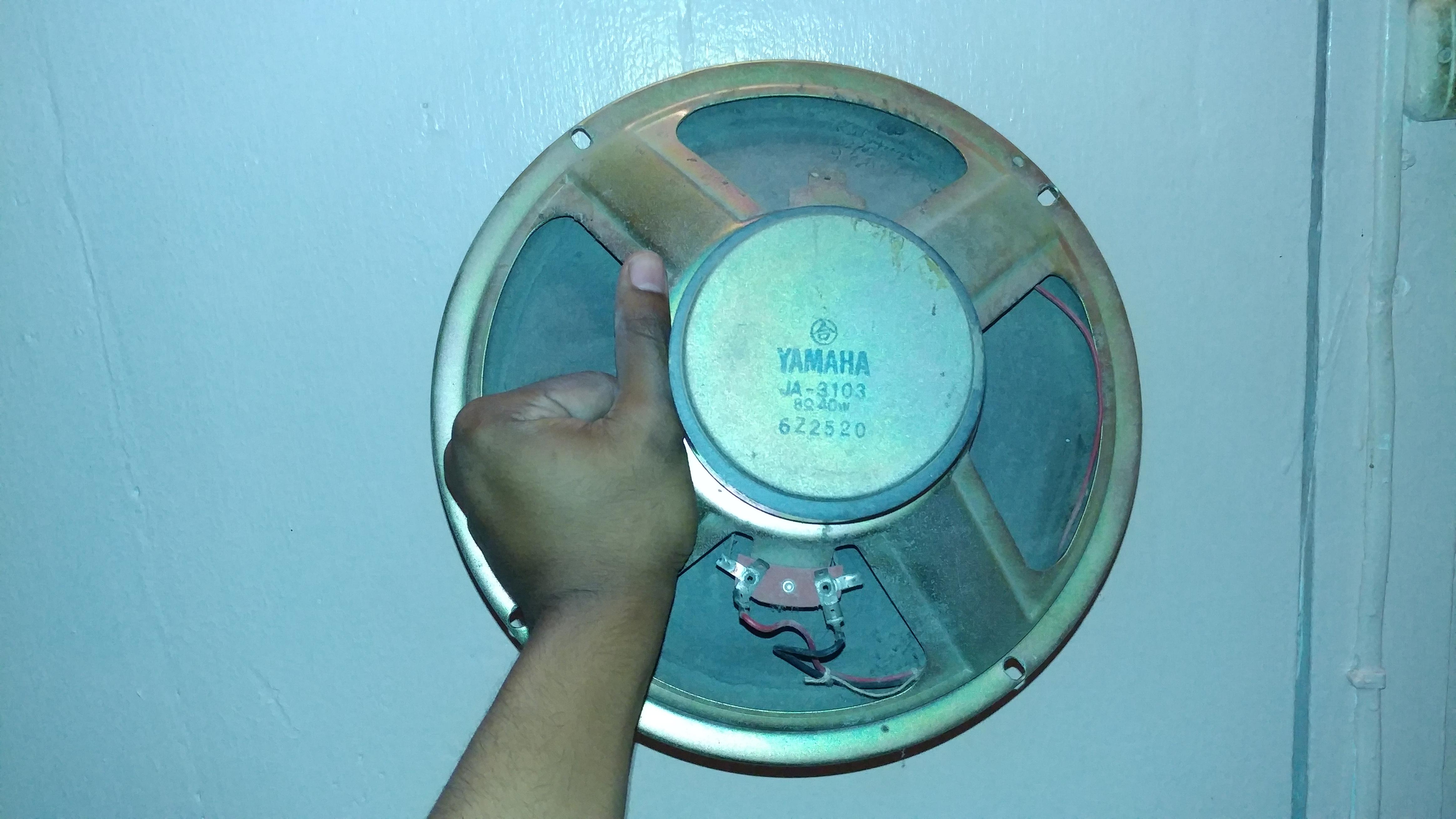

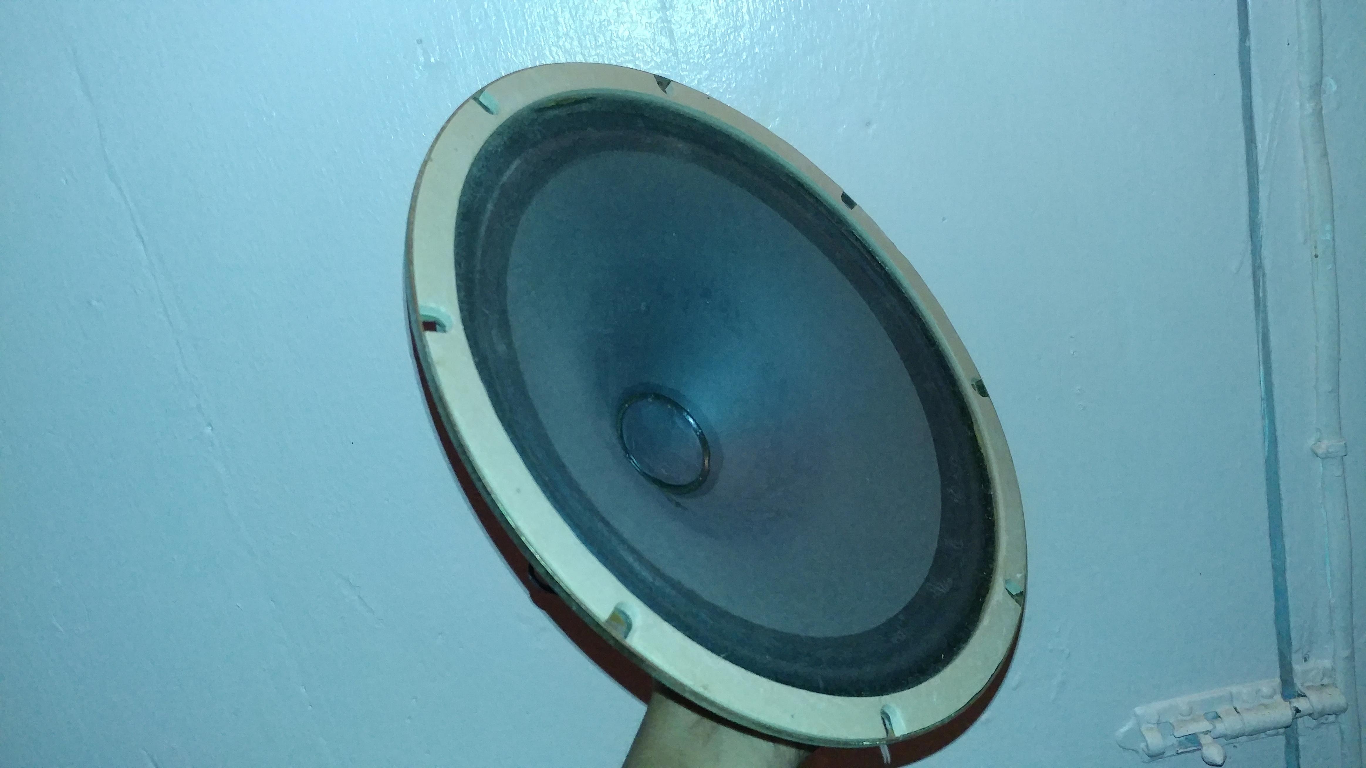

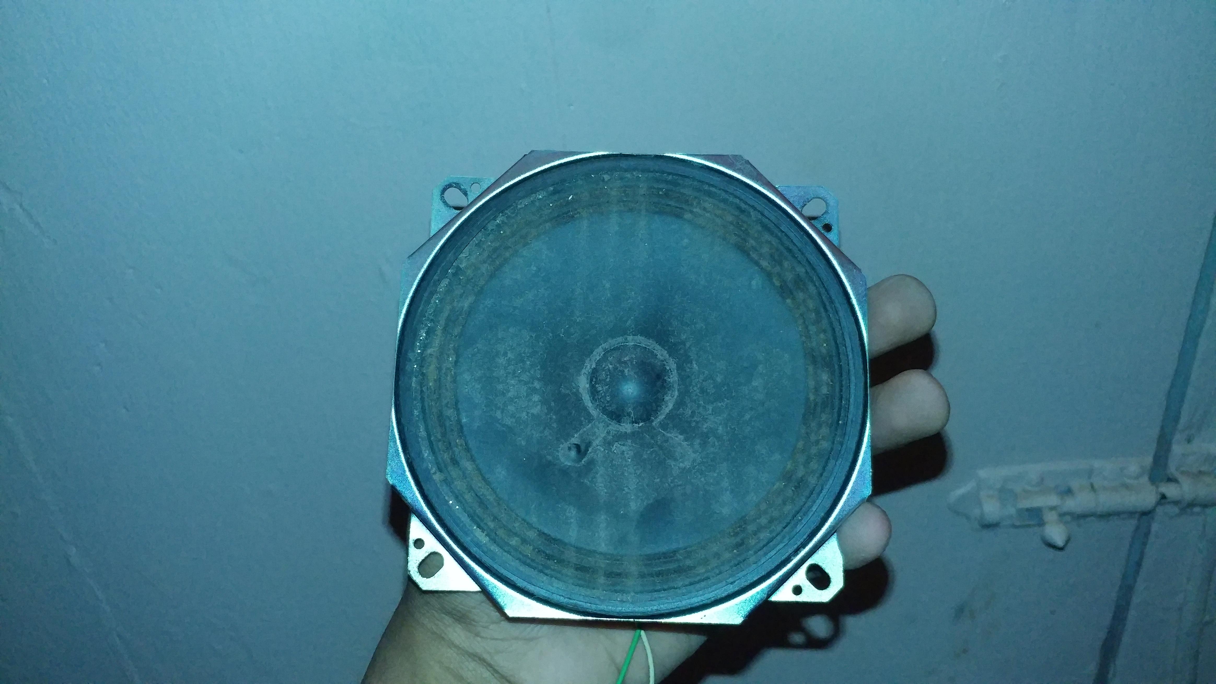

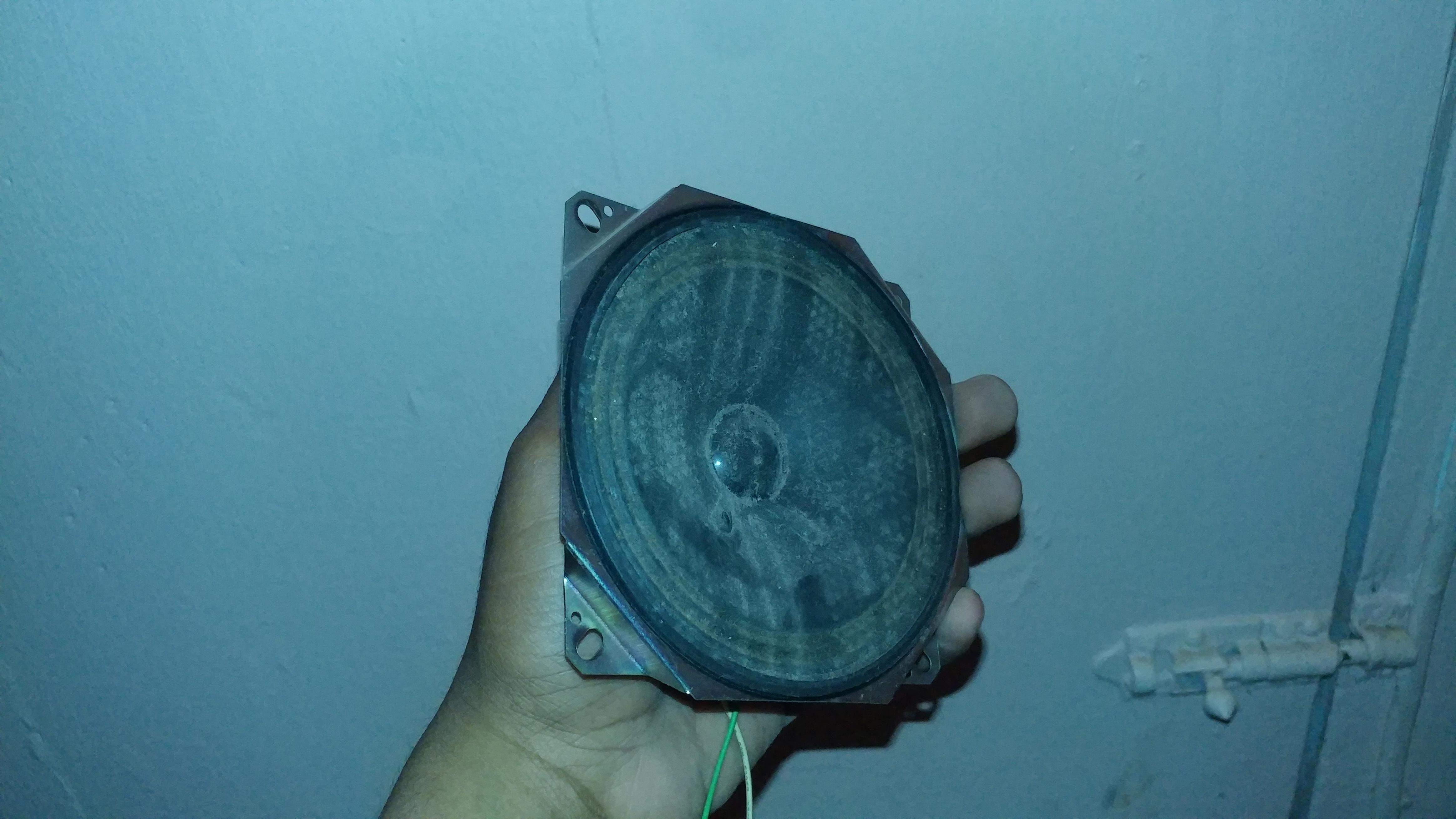

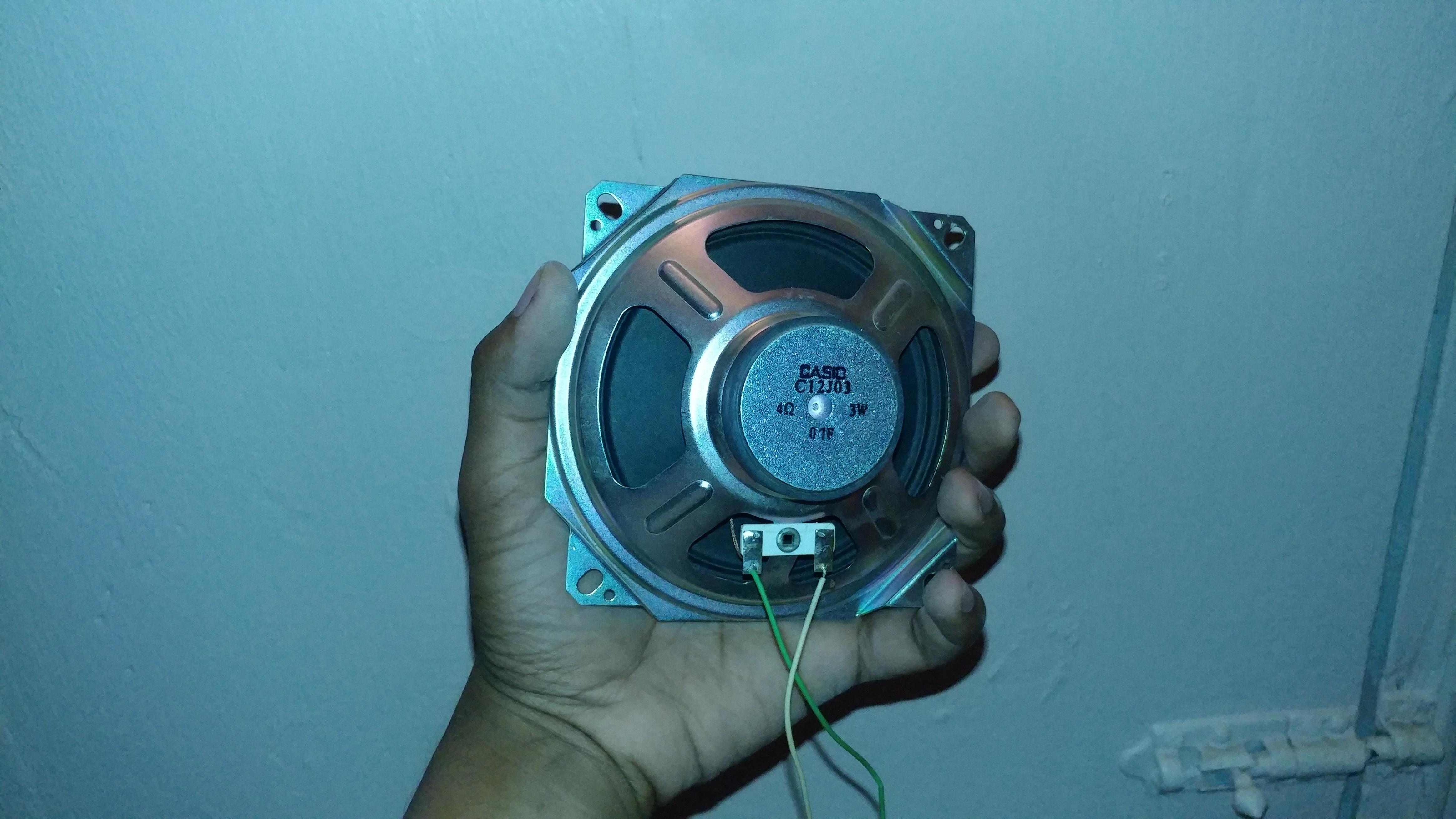

Need photos to know what these drivers exactly look like. Clear shots of both sides.
I attached photos of the drivers, i hope they are good enough...
Whether to do this or not depend on what you want to achieve. If you want hi end sound then this is not the way to get it. If you want to build something because you like making things and think it would be cool to try, or want to learn hands one, then yes, go for it. Whatever the case without any measurement gear it will be difficult to do much. Assuming you aren’t going to have what you need to measure Thiel small parameters, which you would need to design an appropriate box, I would suggest you look up cheap/easy open baffle designs. Tell us more about what your goals are and maybe you’ll get some suggestions.
They look ok. I guess I'd start by putting them each in a box. To keep things simple, you could look at other drivers with the same sized drivers and compare box sizes.

Drivers appear worthy of using. Could not find any measurements on the yamaha, appears to be suited to a 60 litre sealed cabinet. It would make sense to perform impedance and FR measurements, otherwise guesswork. I had a chance to work on a midrange unit that looked like Saba, was a favor for a buddy and it turned out to be quite an awesome vocal performer. Vintage stuff can do quite a bit if you know how to design crossovers.

Not really suitable for use as satellites. They have tiny voice coils, hence that 3 watt stamp on the back of the magnet. Put 10 watts though them full range and they might last a couple of minutes. I take it you only have one of the woofers? The cost of a capacitor to limit the high frequency getting to the Casio driver might be enough to get slightly better drivers.
