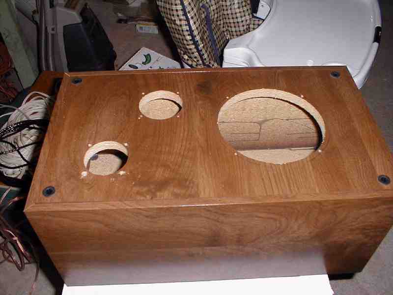

I recently came into the possession of two very well built speaker boxes. I know it is not recommended to start a design with the boxes but I really would like to make use of them. Their inside dimensions are H:21.5" W:12" and Depth:9". There are 3 holes in the baffle; 7.5" 3" 2.75". Any help anybody can give me would be greatly appreciated.

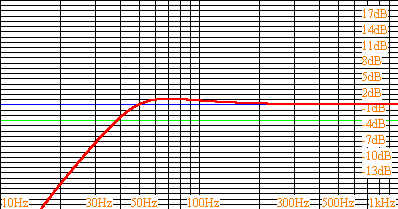

Do you have anywoodworking tools at all? I have a nice 10" spekaer that requires an 8.5 inch hole to fit in. I recommend it a lot because it has a long throw throw for deep bass, plus goes all the way up to 2,000 Hz to meet a tweeter. It also has a symmetrical magnetic system, which is nice.
Here is a simulation of this woofer in a 1.3 cubic foot box. It is the Peerless CSX 10". $63 at Parts Express. Madisound has it too. A bargain.

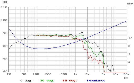

Here is a graph of the unenclosed CSX 10". Forget the lower end-that will straighten out when we put it in the box. Take a look at the upper end.
Most tweeters do not like to crossover under 2,000 Hz. At the crossover point, both woofer and tweeter should be 6 dB down for a 12 dB/octave crossover.
As can be seen from the graph, the CSX 10" rolls off naturally at 2,000 Hz. All you need is a tweeter with a 12 dB/octave crossover and you should be all set.

Vented box, tuned to 27 Hz.
Do you have any woodworking tools at all? You might try a 3" PVC pipe, if it fits. You might also try a flared 2" port, but might have to enlarge the opening. The flared 2" port will give performance like the 3" straight PVC pipe, but will be shorter. We can work out the details later.

Yes I do have some woodworking tools. I'm at work so I can't give you the precise locations but I don't think enlarging a hole would encroach on any others.
When I get home I'll take a picture of the box and post it for you. Are there any other drivers I could check out with my box? I downloaded winISD pro and have been playing with it. Its real easy to use. Just don;t know which drivers to try! I design IC power amplifiers for mobile phones and wlan so I'm used to simulation software thankfully. Anyway thanks again.

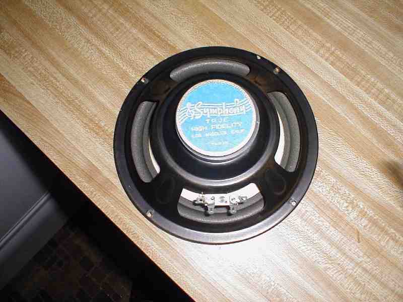

I have attached a picture of the box. Also there is a picture of the woofer that was in the box when I got it. There was no tweeter. I can't find anything about this speaker. Any ideas on it?
Ian

Oops, sorry Kinsale.
You mentioned that you would like rcommendations for other drivers for your enclosure, and I was just sitting back a day or two to allow other members to post on this.
The Peerless CSX 10" is one of my favorites, you see, and when it comes to where an 8" or 10" is called for, I tend to go for that one.
I think your box is an old one. Nothing wrong with it, and no reason you cannot use it, but I think it is an old one. Like from the seventies.
I think it was probably an acoustic suspension system in there-that means sealed, and not ported. I think it probably had a 3-way system, with a 2" or 3" midrange that came in around 800 Hz and a tweeter that came in around 4,000 Hz. That was a common arrangement back then.
We can build a 2 way using the Peerless and a tweeter. Or we can change or enlarge the holes to go to a more modern idea.
