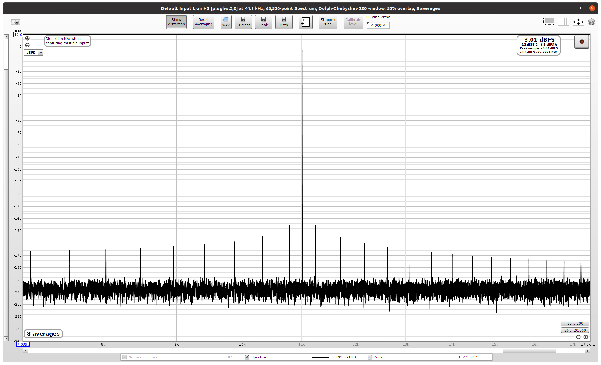

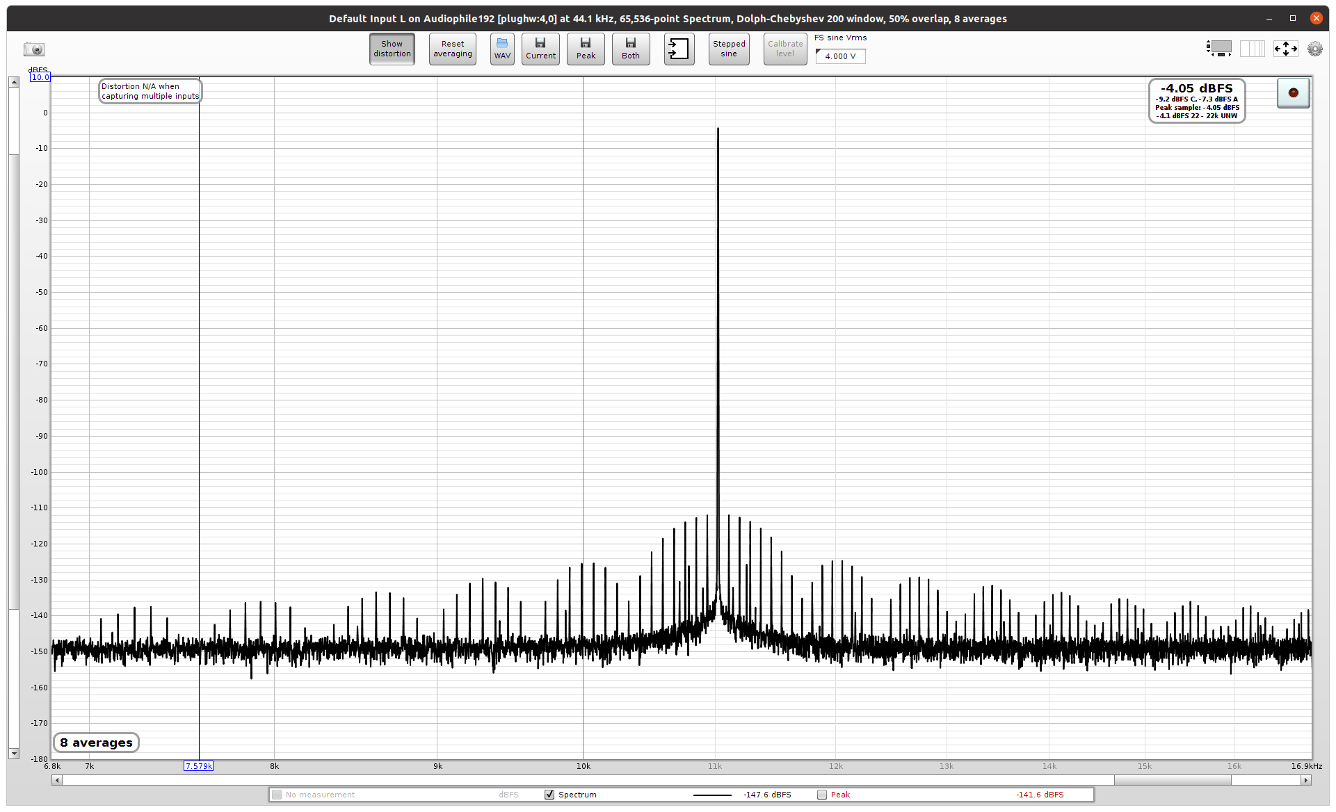

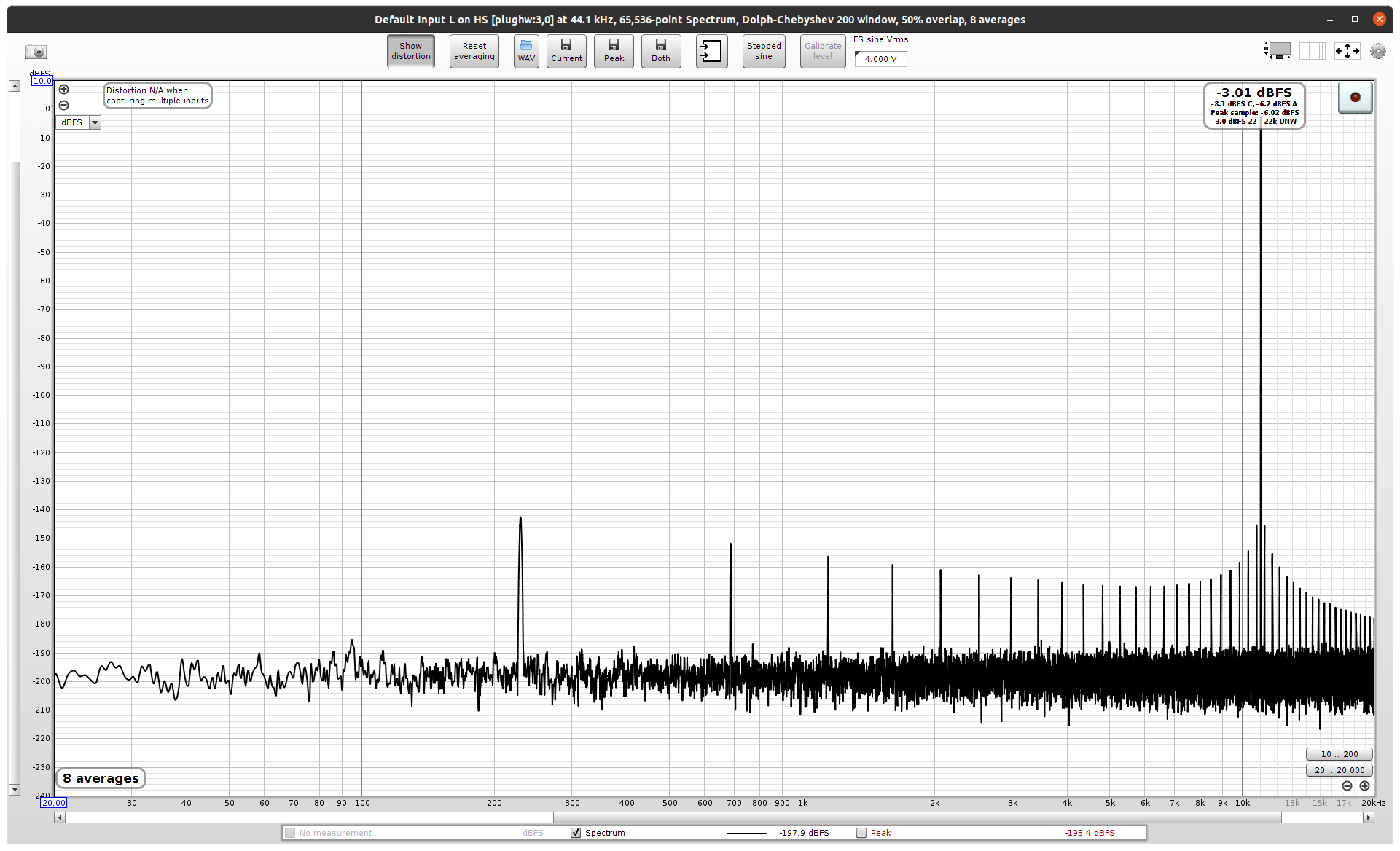

Another thing is that MCK seems to be the most problematic for SPDIF receivers. Here is AK4118 I2S output of 24-bit J-Test without MCK:
Another view of the same:
So not bad at all and may work nicely with DACs that don't require MCK.
However when MCK is used things look much worse (here AK4118 to AK4490):
That is typical of AK4118 without SRC (as in Topping D90).
IMO the easiest way to get clean SPDIF output is with SRC (as in ES9038 or with AK4137).
