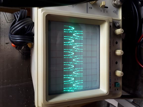

Hi Guys,
I bought a COD from twisted pear audio many years ago and i have changed the PCM1794 for 1798, because it's more easy for me to built a discret IV converter with a smallest output current. A few months ago i bought twisted pear spdif transceiver and i have a problem in output of COD, this a 1Khz and 400Hz with a 392ohms iv resistor. Someone can help me?

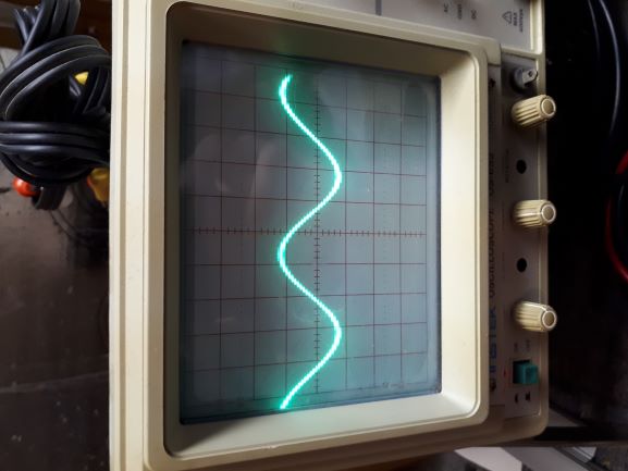

since my last post I did some tests. first I connected my pcb DAC with a pcm1798 that I had made to work on my I / V stage and it works with the spdif transceiver in 24Bit i2s. Second, I changed the pcm1798 because I thought it was burnt and unfortunately I still had the same trouble🙁. So I reinstalled the COD in my old YBA CD player and set the DIP switches to 16BIT and it works fine. Now I don't understand why the COD and the transceiver don't work together in 24bit I2S, the transceiver works with my 1798 pcb in 24bit I2S and the COD works at 16BIT in my cd player.
Someone can help me?😕

If the unit is not performing according to the data sheet for the PCM1794A as implemented in this description, it’s probably damaged.
