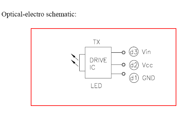

I've soldered wires onto the spdif and gnd pins of the tos tx. I managed to work out which pin was the 5V (D2 in diagram below), so by a process of elimination the other two must be the spdif and gnd 🙂 Only question now is which wire is connected to the gnd and which to the spdif... The tos tx is part of a sealed unit so inspection isn't going to help, and no datasheet online, only this diagram:
http://www.ude-corp.com/uploads/cust/photograph/big/20080611211803.pdf
Any advice here?
