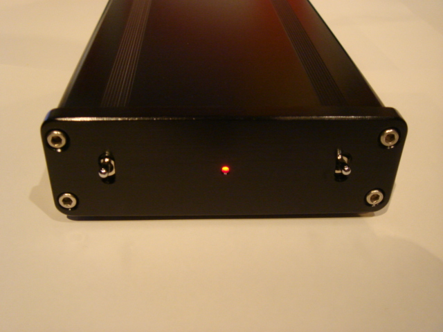

I have measure my SPDIF out + the cable + my receiver, and the cable is not the cause to the raise of phase noise. At the end, the jitter rms 10 hz - 4 Mhz is about 2.2 ps. And the the major contributor to jitter is the low frenquency under
In french,
TVC Audio- Audio Numeric Performance
This is a very good perf. Better than the original from Wadia X32 and X64.
