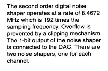

I was interested in modding a player with the SAA7341 DAC.
In the specs, it states that the signal is cliped toprevent overflow.
So I guess the output is not bit perfect.
( The SPDIF is taken off before any upsampling is done .)
Andy
