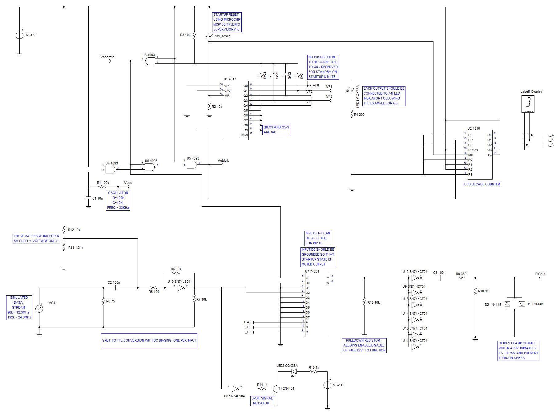

I designed but did not build a very similar project. I will attach the schematic. Maybe you will find some inspiration. Feel free to contact me if you have questions.
Here are some links about different parts of the circuit. You will want to read the epanorama web page on SPDIF interfacing.
hardware:svnimages:irspdif_single.sch.png [Projects]
epanorama.net/S/PDIF Interface
www.netstuff.org (see SPDIF Master)
Pushbutton Relay Selector Circuit Diagram
Essentially it takes SPDIF input, converts to TTL levels, then uses a TTL MUX that is controlled by a neat little pushbutton activated selector via a BCD interface. The output of the MUX is converted back to SPDIF. This was going to be used as a digital preamp input selector, and I just got stalled out on the project. If anyone wants to help me and contribute something, I'd love to actually build this.
This concept has been used by several people who built successful projects, so I know it works up to 96kHz.
-Charlie
