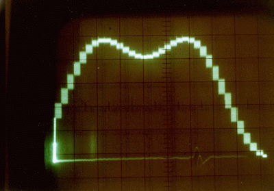

Have you ever looked at the output of a DAC? It’s a stair-stepped ANALOG of the digital input. If there is jitter in the timing of those stair-steps then there is jitter in the analog output of the DAC. You claim to be able to hear 1ps of jitter. If the jitter didn’t cross the boundary that separates the digital and analog domains and appear in the analog output of the DAC, how can you hear it?
Look at the data sheet of most any multi-bit, audio DAC and you will see a spec for settling time. That’s the time it takes for the analog output to reach the level that represents the ANALOG of the digital input. The TDA1541, Thorsten’s favorite, settles to within +/- 1 LSB in 1 MICROsecond. Although the Philips spec doesn’t give the range settled, the norm for settling time is a one-half of a full-range current swing. The settling time varies depending on the numeric distance between consecutive samples and, in some cases, the number of bits changing. A smaller current swing will settle in less time. If two successive samples are identical, the settling time is zero.
Fact: The TDA1541 typically takes up to one MICROsecond, or longer, for the correct current to appear at the output of the DAC.
Fact: The actual settling time depends on the data.
Conclusion: It looks like data induced jitter to me.

Of course you don’t hear the effects of settling time because it is omnipresent. You would probably recognize it once it’s gone.
Settle time illustration
Pictured is a highly stylized representation of the effects of settling time. The dotted lines show the output of an ideal DAC. Samples 1 and 6 are both zero. Samples 2 and 5 are same and are a little higher than zero. Samples 3 and 4 are the same and are a lot higher than zero.
The solid lines show the output of a real DAC. The pairs of samples that should be identical are not. They differ in the time to reach the correct height, the average height during the sample period, and the area under the curve for each sample period.
I called the aberrations caused by settling time “intrinsic jitter” because jitter seems to be the only digital aberration discussed in this forum. Also, the effects of settling time are similar to jitter. Jitter, as you all know it, changes the time a sample starts and stops and that changes the area under the curve and the amount of work/energy that sample imparts to the resulting output signal. As you can clearly see, the effects of settling time also affects the area under the curve. And like some forms of jitter, settling time aberrations are related to the data.
In the old days of parallel DACs, S/H registers were commonplace. Because the DACs were expensive and required numerous latches and support logic, the left/right channel data was decoded by a single DAC and the left/right channel output was separated by S/H registers. The use of S/H also eliminated the effects of settling time and all upstream clock jitter. In fact, recommended S/H delay times were part of the DAC chip specs.
As DACs got faster, settling time became less of an issue and the pressure to reduce costs led to the serial interface, stereo DACs, upsampling, etc. and the S/H was eliminated. With the renaissance of non-oversampling and the rediscovery of ancient DAC chips, like the TDA1541, I am surprised no one has resurrected the venerable S/H.

The settling time of a DAC can be split into two types: linear settling and non-linear settling. Linear settling is primarily determined by RC time constants inside the DAC chip and/or the time constant of an external I/V converter. It is exactly equivalent to lowpass filtering the DAC output, typically at a fairly high cutoff frequency (time constant << DAC sample rate). As long as the time constant is short enough linear settling does not degrade the DAC output and is in no way equivalent to jitter.
Nonlinear settling is most commonly caused by slew rate limitations in the I/V converter. Proper design of the I/v converter WRT large-signal bandwidth and output swing can minimize the effects of slew rate. A well designed DAC will have negligible nonlinear distortion.
There is a possible signal-dependent jitter source inside the DAC chip and that is internal clock skew on the sample clock. Typically the sample clock needs to be gated and routed to a number of analog switches (transmission gates) which have some physical separation on the chip; if the clock does not arrive at precisely the same time this can cause a jitter-like effect. The effect is highly dependent on the DAC topology. In any case, careful physical design (layout) of the DAC chip can bring the clock skew down to the picosecond level (or better).
