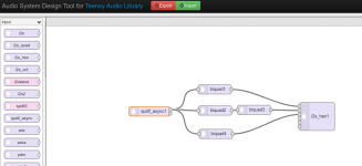

Thanks, my intention was to decode the SPDIF into a usable code then implement the digital filter so that I have three frequency streams followed by digital attenuation for each stream.
Finally each stream would have a dac unit for input to each of the three analogue amps.
So I guess I would have to install my own dac units within the amplifier casing.
I will have a look at the SPDIF receiver unit that you mention.

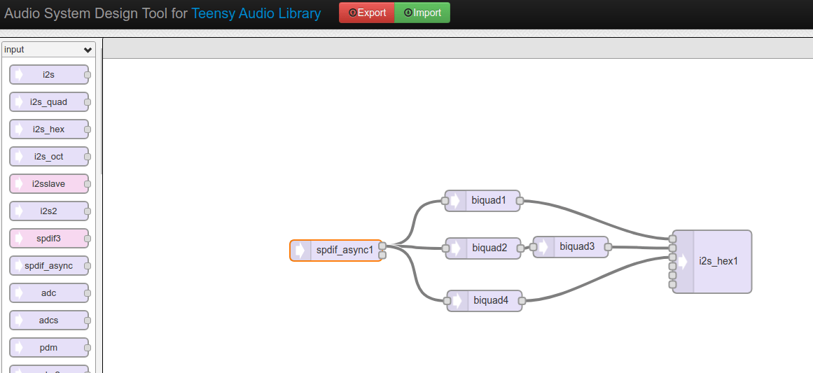

with the Teensy audio lib you would setup something like this: (one channel shown)
and connect 3 dacs to the I2S output, i would begin with 3 x TDA1387 , can get at 20ct from Ali...
so it will cost about 30 $ to make the real test. (no drama - right?)
