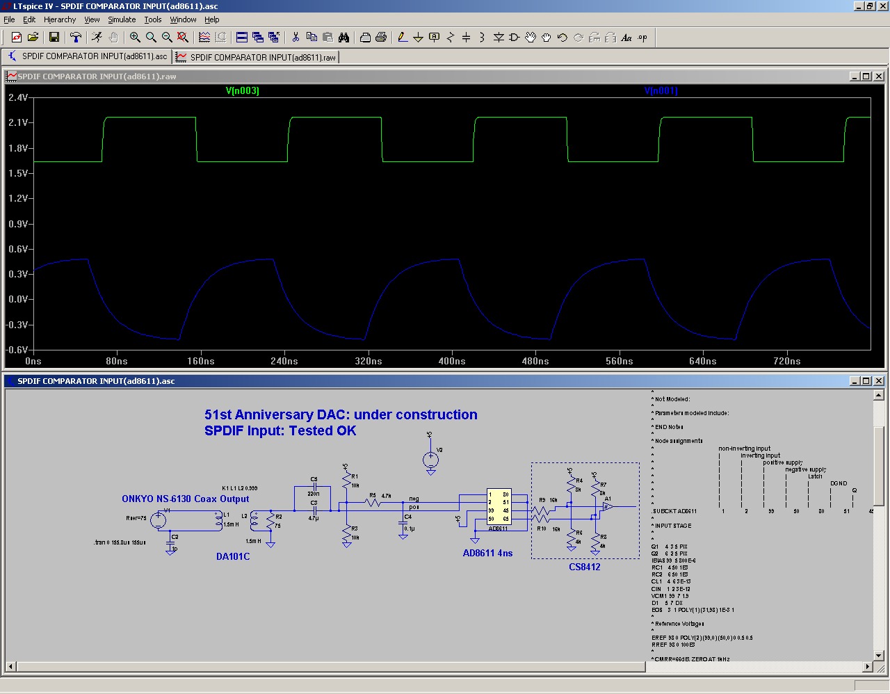

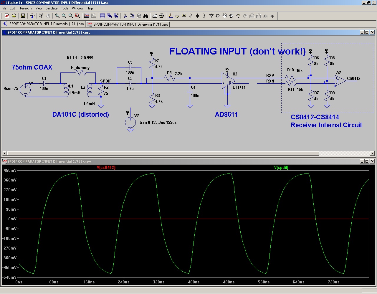

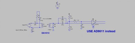

Thanks for the replies.
After massive internet and DIYAUDIO navigation I think I will adopt Quanghao’s configuration, that uses a pulse trafo and a comparator. (also reported in this forum somewere)
I have simulated importing AD8611 model from ADI and other LTC comparators in LTSPICE with success. Attached. It works great!
1) I would decrease the input resistance in order to lower input noise (and increase capacitance accordingly, to 220nF). Is this right or should I have to stay with 10K+10K voltage split?
2) I would put a zobel on input…mmm I don’t know if it is correct and beneficial
3) BIG QUESTION: at the inputs of CS8412/4 should I put just the positive comparator's output to RXP and ground to RXN, or it is better to input to RXP and RXN the differential signal between positive and negative outputs of the comparator?
NB: I'm ready for LIQUID MUSIC and this is my first DAC construction

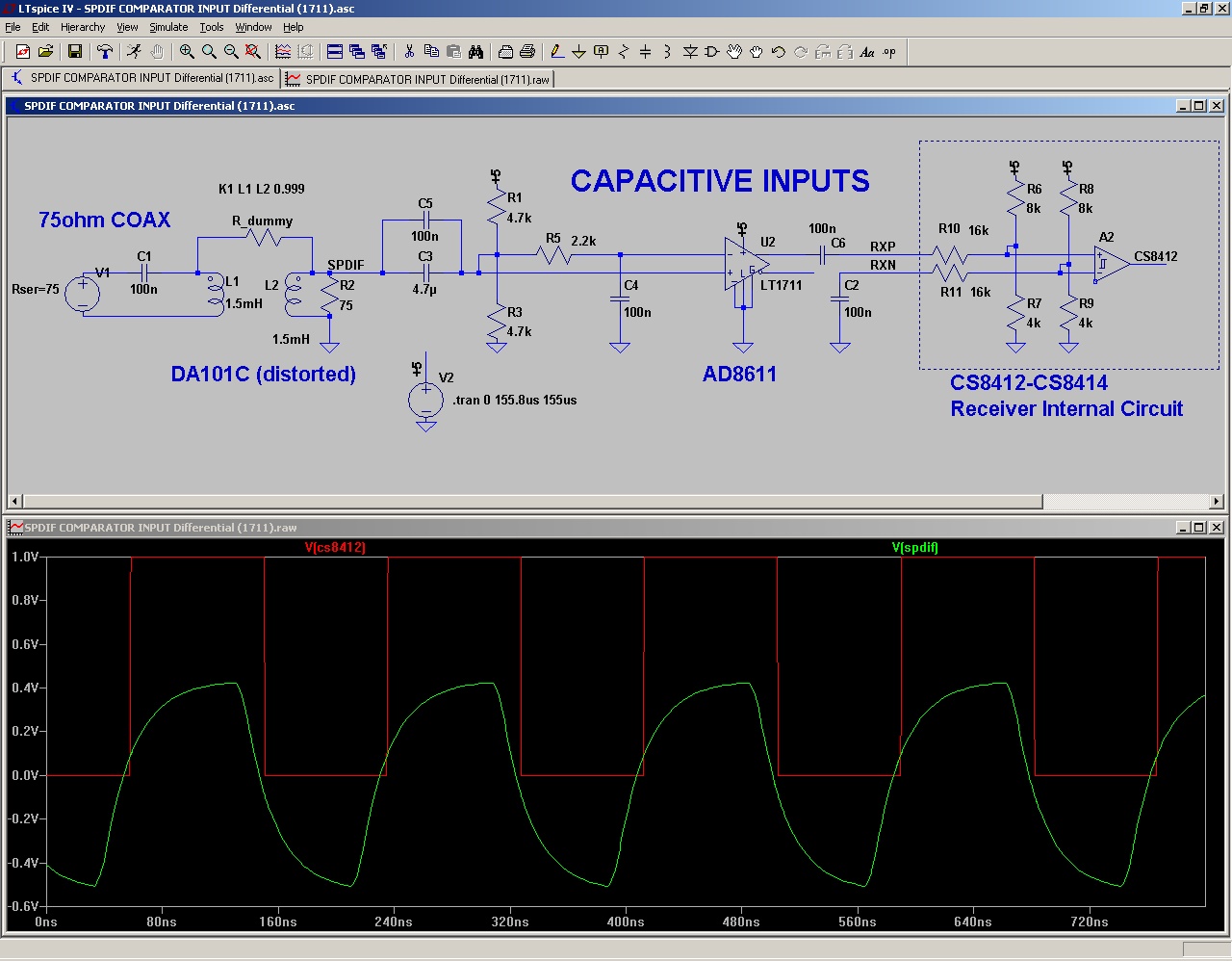

Having C2 rather defeats the purpose of the transformer. Sure you've still got isolation at DC but it's going to let through a lot more noise than the interwinding capacitance of a typical pulse transformer.
The zobel as shown on your schematic isn't such a good idea - at higher frequencies its just another termination resistor but you already have one in R2 so this is going to mis-match your cable.

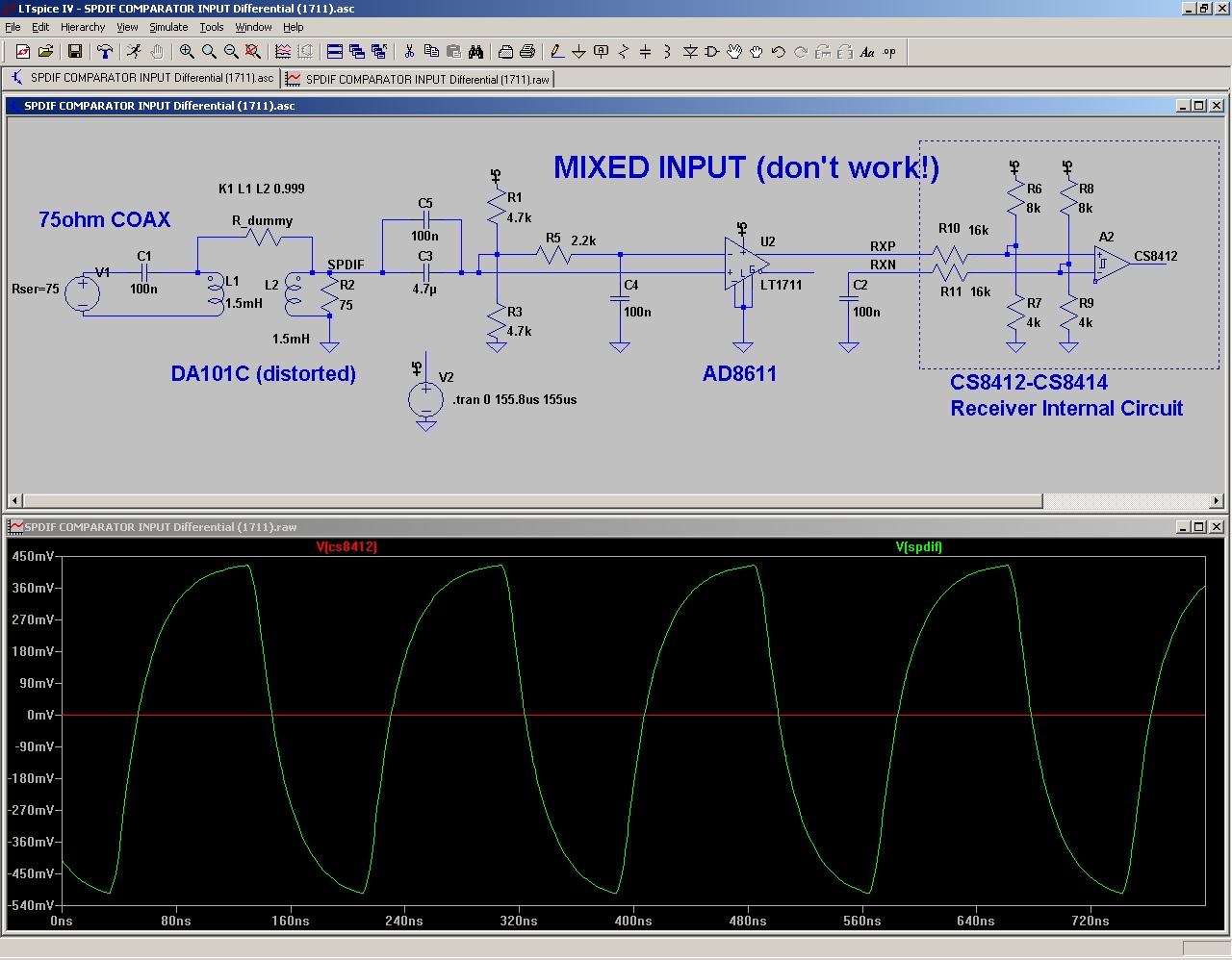

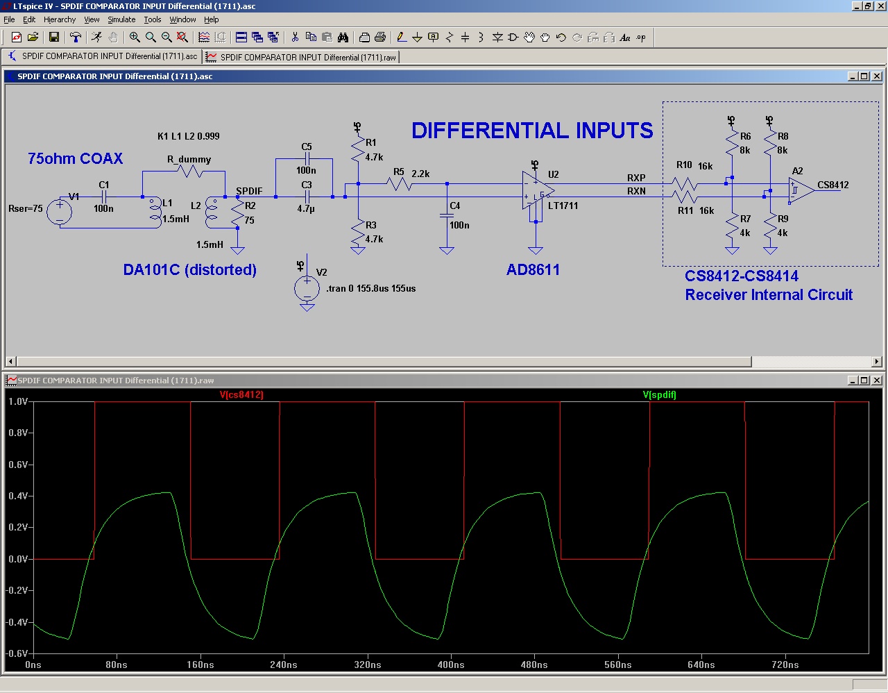

Thanks, but ... this does't reply to my original question....;)

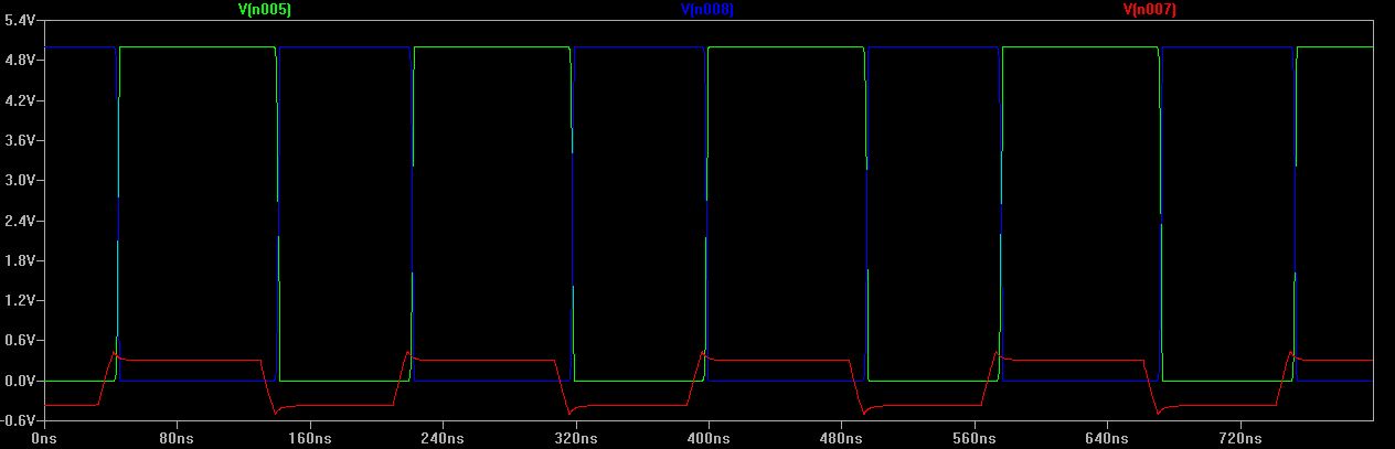

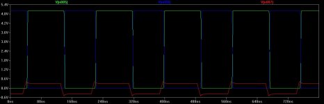

Another time LTspice helps: it looks like that Differential, Unbalanced and Capacitive inputs work fine, but not floating.
So I think I will test by ear at least Differential and Unbalanced, as I read here (
Digital transformer ) from Elso Kwak that removing caps sounds better! And Elso used direct coupling of both comparator outputs. So I think "differential" could be the best sounding interface.

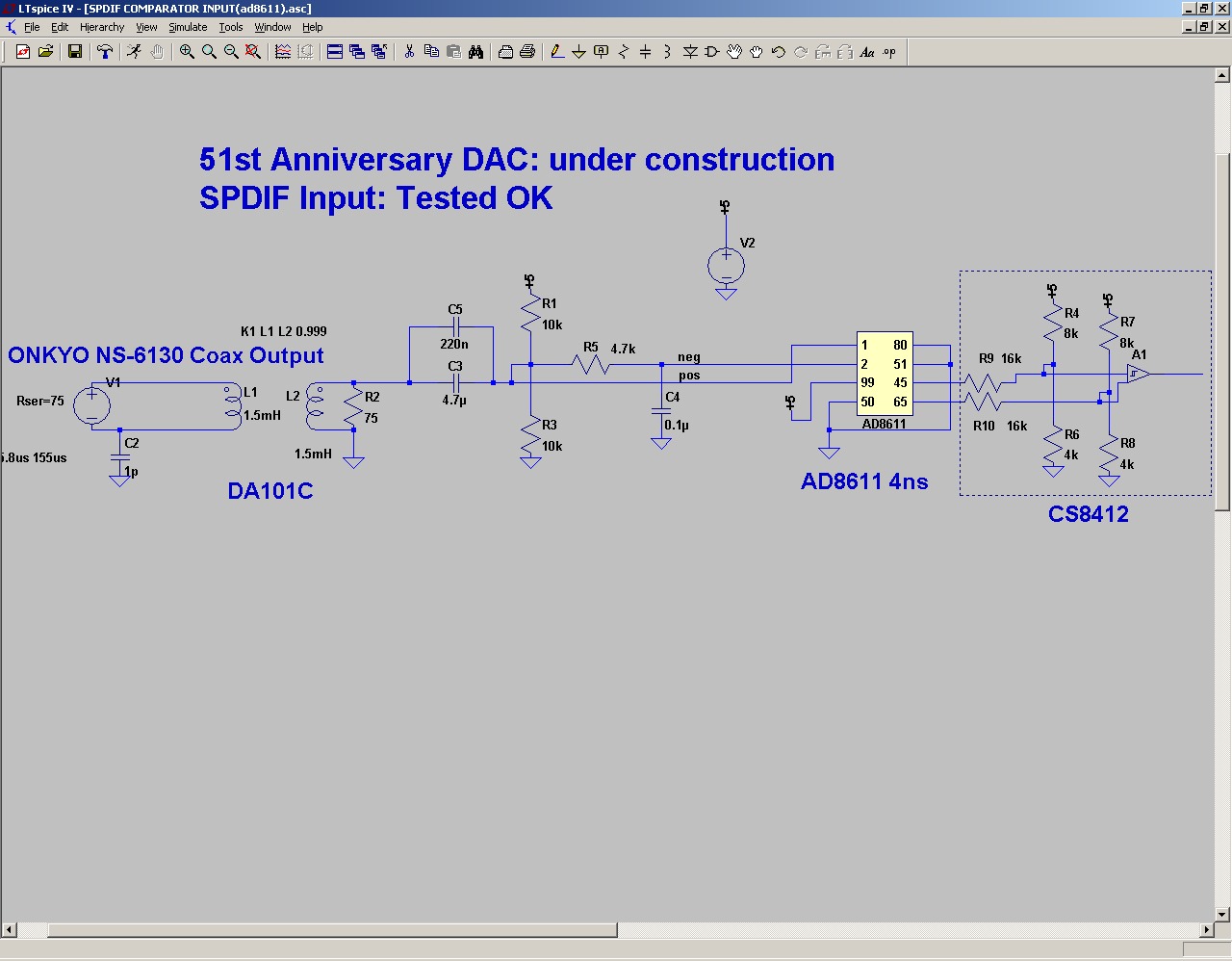

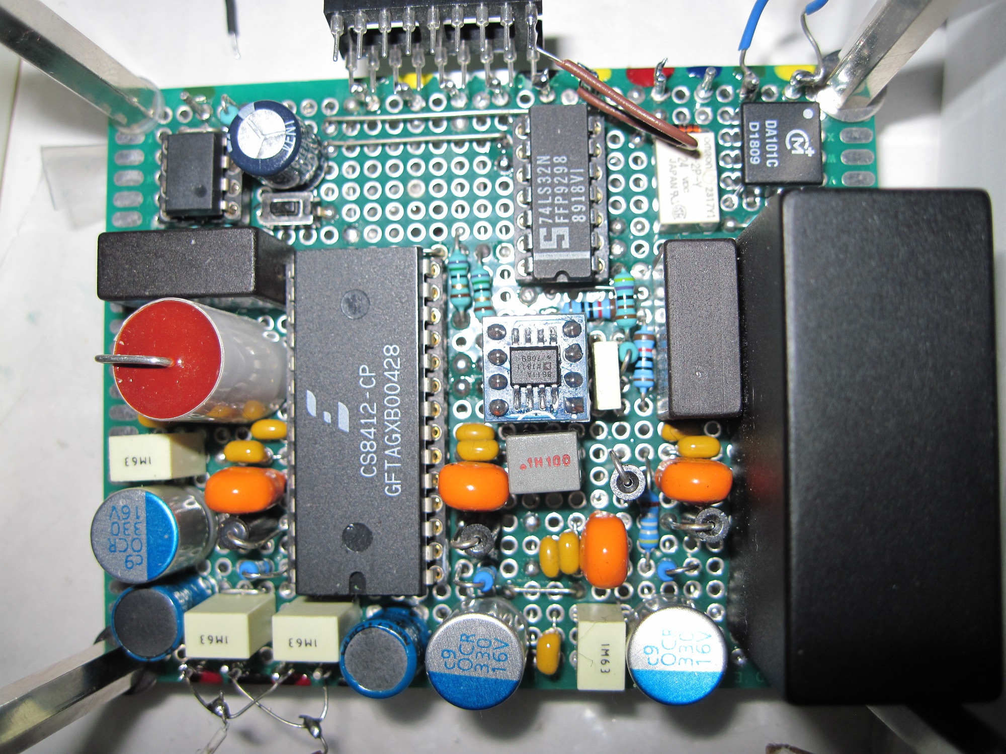

Hi, no I just build (attached) the differential version with AD8611, and it works great!
Being the current fastest single supply comparator in SOIC (at only 4 ns), I don't have any reason to downgrade to 74HC (9-17ns).
I'm working now with 74AS logics for PLL, reclock etc.. (with 1kohm pull-up at the output to match CMOS levels), which are dip and have few ns of delay.
Attached actual schematic (to be fair: not mine but a mix of two circuits found in google images and forum).
(FYI I built also the reset circuitry for CS8412).
