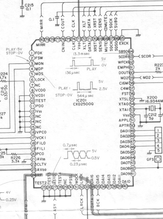

I have a CD-player with this Sony control chip onboard. I have had a hard time to get this player to play MUSIC!!!......it just end up with something hard, and harsh, with terrible sss-sounds. :bawling:
If I want to go the I2S way I must probably choose the TDA1543A chip, or a combination of cm's EIAJ to I2S converter, and a standard TDA1543/1541 chip.
Will the simplest way be the way to go ?
Would it be wise to go for/try the TDA1543 tower for increased linearity, conciderering this mod is intended to be carried out inside the CDP-box ?
The fact that it is a TDA1543A chip doesn't change the possibility to piggyback these chips, do it ?
I also read somewhere in the forum that it was the C4M (pin 57) that decided if the signal should be oversampled or not.....does this mean that i could turn the OS on and off ?
If I want it permanently off I just connect it to ground...yes ?
And finally (for now... 🙂 ): will a player with a really! decent drive, and this Sony chip be able to play as good as a player with a CDM-drive when going the I2S way ????????
Many questions, but I would really like to know what to do before I do it............
Lyra
BTW: what are the pins that I have to use to get this work named. Seems to me like little different markings compared to the TEAC VRDS (CDX2500AQ) unit in another tread ( my chip is named CDX2500Q )
Ooooops!!! I just looked inside the CD-player an the chip is actually a CDX2500AQ !. Does this mean that the pins have different names, just because this is a Denon-player, and the other one was a TEAC ????, or is it me that need some sleep ????

What I was hoping for was some way to get my player play wihtout harschness. The player now uses the built-in AD1862 DAC's.
Don't know if theese could be unsoldered and still be working, and use theese. But then again, i'll need something between the CDX2500 and the DAC. I was hoping to make it simple.
Anybody with a really GOOD schematics regarding a simple DAC with theese AD1862's ??
