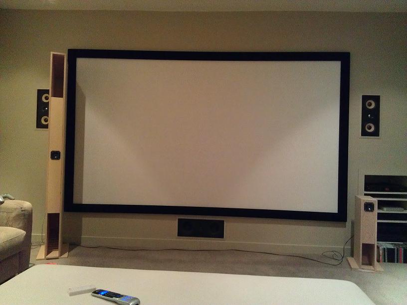

After a quick email to Dave, I decided that whilst waiting for my Fostex's to arrive in NZ, I would have a play with the design to see if I could make this work with a 3 inch Peerless 830986 driver. From the specs, I wasnt holding out much hope, but I have these in a BLH for the FE87E (I know, but they sound wonderful in this enclosure), so having a quiet day on Sunday, thought that I would throw one together to get a feel for the cabinet. A couple of hours later I had the cabinet built and glueing, now here comes the first of a number of errors, firstly, being in a rush to appear busy so that I didnt have to mow the lawns, I selected 13mm MDF instead of the 18mm that was stacked next to it, I made all the cuts and started glueing and when I came to the last two pieces, noticed my mistake, having come this far, I decided what the hell and carried on, then came my second mistake :( I glued the baffle on without the felt, what else can go wrong? Well, I placed the cabinet in my room and hooked it up (not expecting much to be honest) and fired it up. Well, what can I say? These baby's go deep! as deep as the same speakers in the FE87 BLH, but with a lot more punch. I will need to go back and re-make them, but with the correct thickness of material and felt. These are quite a forgiving design, but will be relegated to my study as they have little WAF!!!!
I will complete a full and proper build thread, as I think that much can be done with this enclosure design.
Thanks Dave :)
Fringy75,
Looks like you're having fun :) Which box did you exactly build?
Hi Zia.
I took that basic design of the Kongō and very unscientifically changed the sizing to work for the Peerless 3" driver (Dave would kill me if he could get near me I think) :) When working on the re-sizing, i looked for similarities between the 3 sizes for the Fostex FE126En, FE166En, and FE206En, and noted that the enclosure for the FE206En was twice the size of the one for the FE126En, then I reduced the size of the Kongō by a third!, so internal width is now 98mm. The one on the right is the BLH for the FE87E :)
I am having a great time just playing :)
