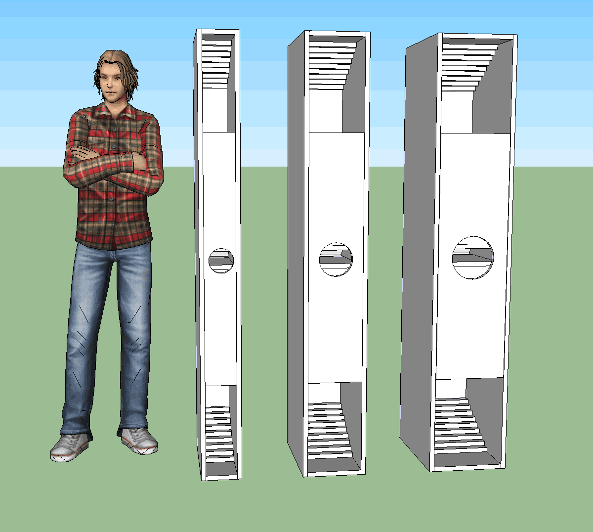

Here is a family portrait.
Wow, Tysen has grown a lot. They sure do sprout up quick, don't they, eh? 😛
He's not quite that big yet... but yes, they grow fast.

and I'll wager the wardrobe and attitude might well match the SIM model

which?
With my more serious hat on tuning (~42Hz) is set by the path length, which is all but identical in the three enclosures. The larger cabinets are impedance matched to a lower frequency of course & have progressively greater dynamic range.
