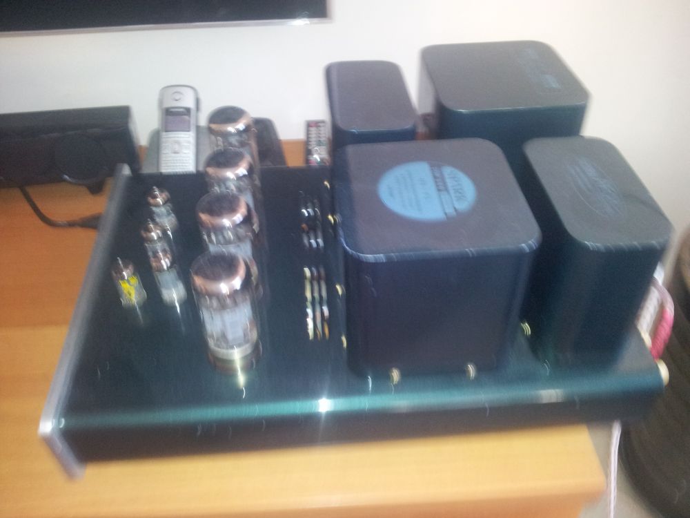

A friend has bought Spark 810, it's 15 year old or so, and needs recaping and retubing. The link you quoted leads only to the text (google translation):

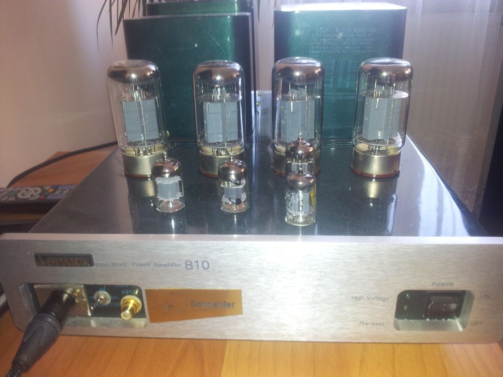

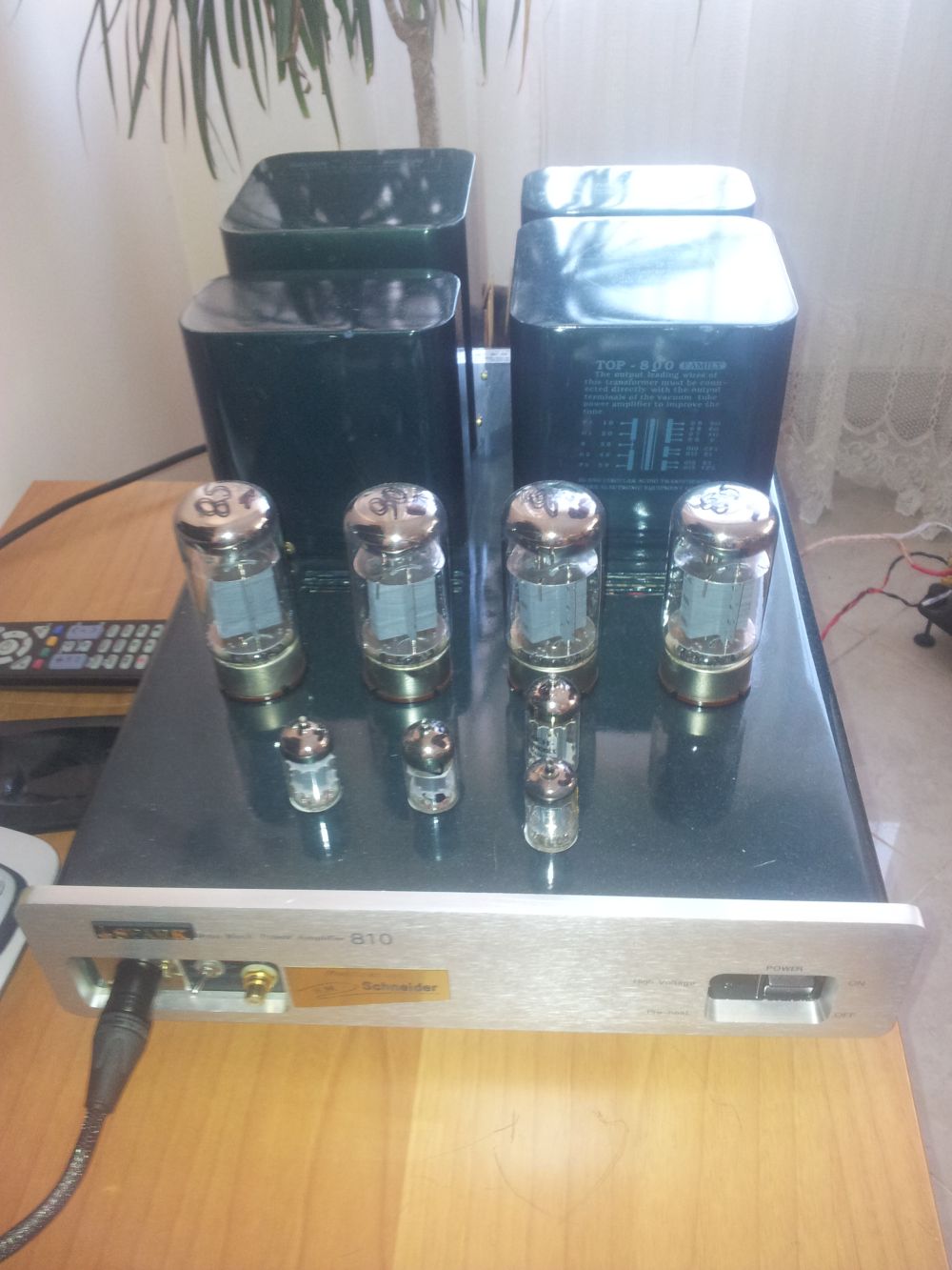

Here are some photos:

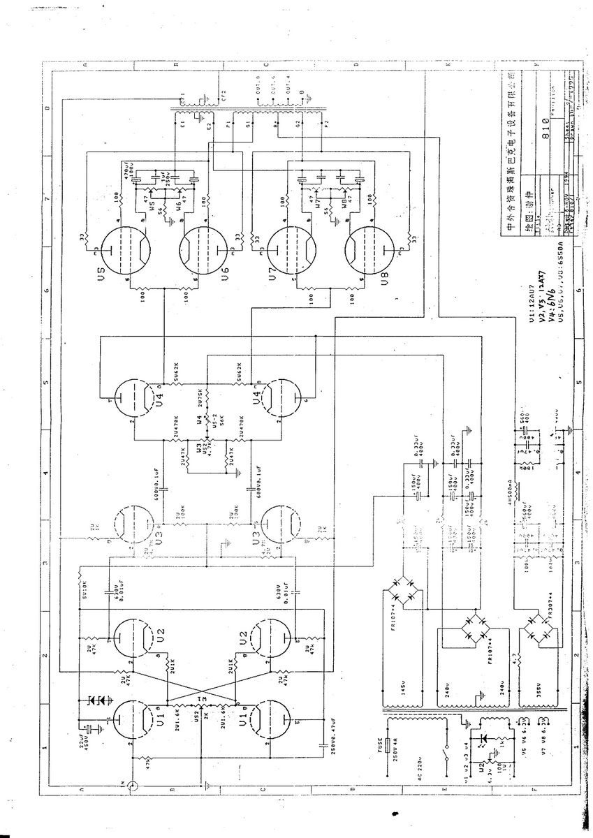

Hi Andy:
I should have the circuits will look today and if I find them scan the circuit.
I found they had design faults around the out put stage, very simple you just need to change a resistor, the way they are if one resistor blows, destroys the tube. With original Chinese tubes; the kt 100/88 used to short out very often no trouble with Russian 6550's or KT88's

Hi Andy
Circuit for the 810.
I found when the amps were using chinese tubes they would often blow the resistor on the plate 33R and leave the SG intact destroying the tube, so you need to make sure the SG resistor blows before the plate 100r. With Russian tubes never had any problems. wonderful amps.
