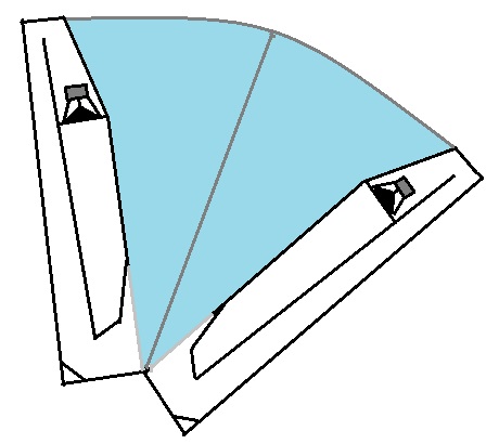

Taking inspiration from Bill Fitzmaurice and the V-Plate, I wondered how far can you take this concept in the battle against Hoffman Iron law. Good horn subwoofers require a big mouth and you can't cheat by just rapid flaring in the last few inches of cab. I'd expect this design to have poor low frequency loading as a standalone, but pair two cabs with piano hinge and a top plate and you have yourself a big horn subwoofer that packs down in the van.
Anyone else experimented with designs that use the outside of the cab as the final flare of the horn?

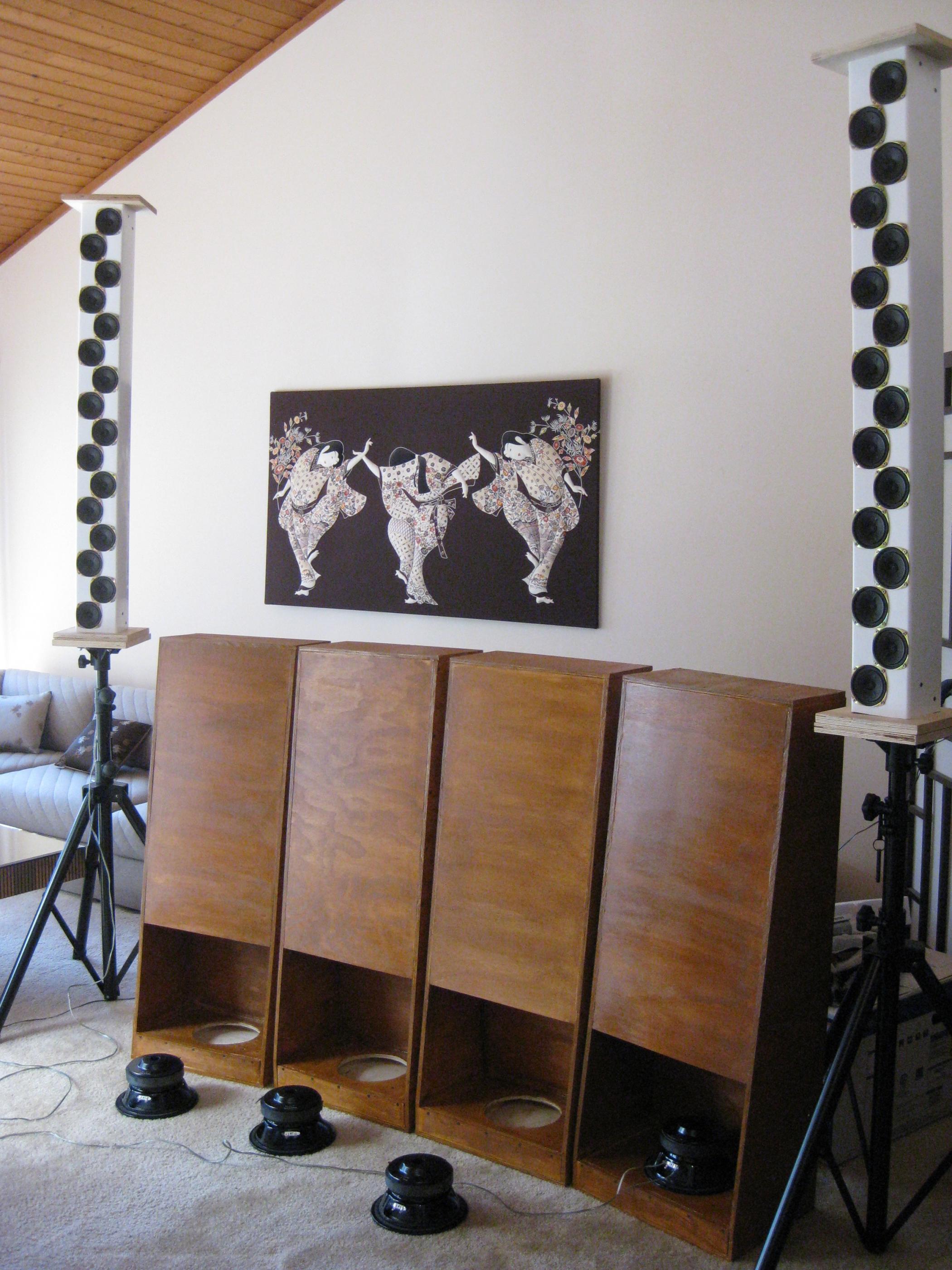

I built 4 of them, and used them side-by-side without v-plating. The floor and their fronts made two sides of an extended horn. Worked very well.
Joe L. said:
Actually, they do not do too badly as shown in my picture. The floor forms one side of the final horn, and the standing cabinets the other side at 90 degrees. The four cabinets side-by-side result in a horn width of 72 inches by 44 inches high.
Joe L.

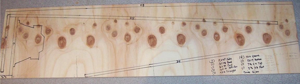

This picture from earlier in the J Bell thread had an outline with a hand-written parts list with dimensions.

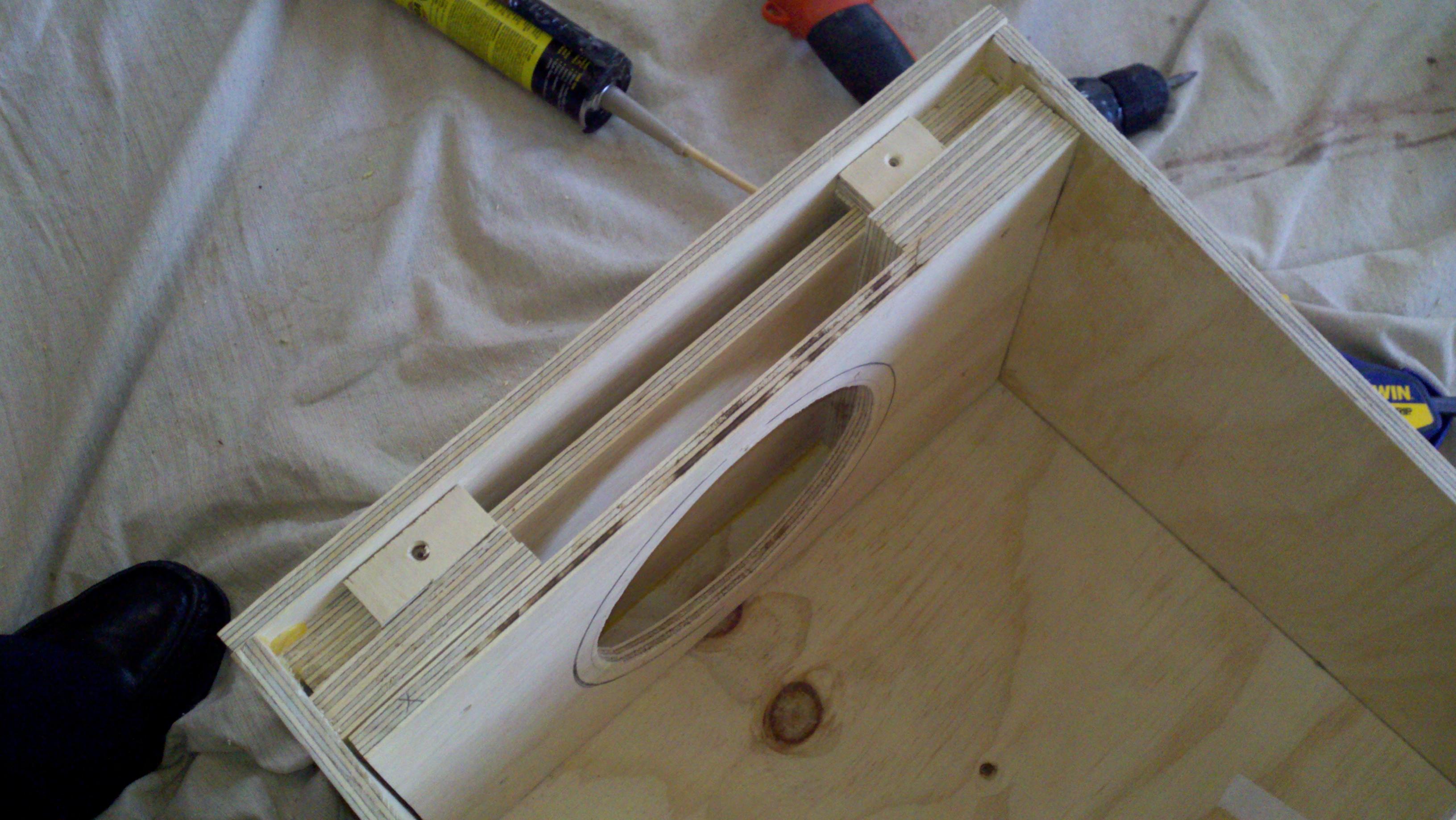

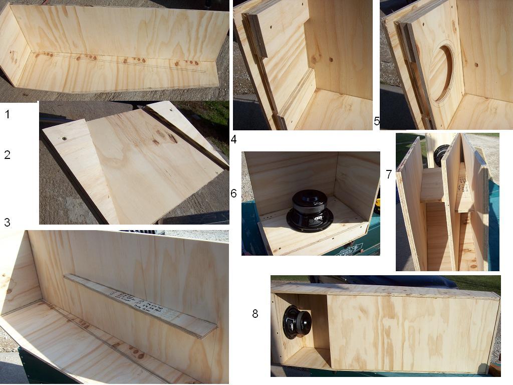

I'll try and find some construction photos from when I built my versions later tonight when I get home to make it more clear. The most complicated is how the compression chamber feeds into the balance of the horn.
Joe L.

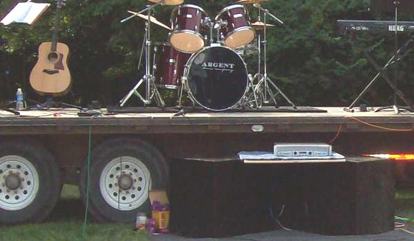

Exactly as I used them post #4 in this thread. The floor was the bottom plate, the fronts of the 4 subs the top plate.
I used them without side plates. ( I was supplying ballroom dance music in a conference center ballroom. I did not need the sub 50 Hz response or high SPL you might need for a younger crowd. )
I did nothing to seal between the subs/floor or each other.

This thread is describing the space-saver concept of a pair of subs used with a top plate. The final horn segment being made from the adjacent sides of the two subs.

@J.L Thats a good thing with the weight low. On my phone I cant see from the pictures if two bass-sticks forms a very broard horn together or if each are a horn by it self. For a very small venue or home you only need 1 stick for 2.1 stereo?
