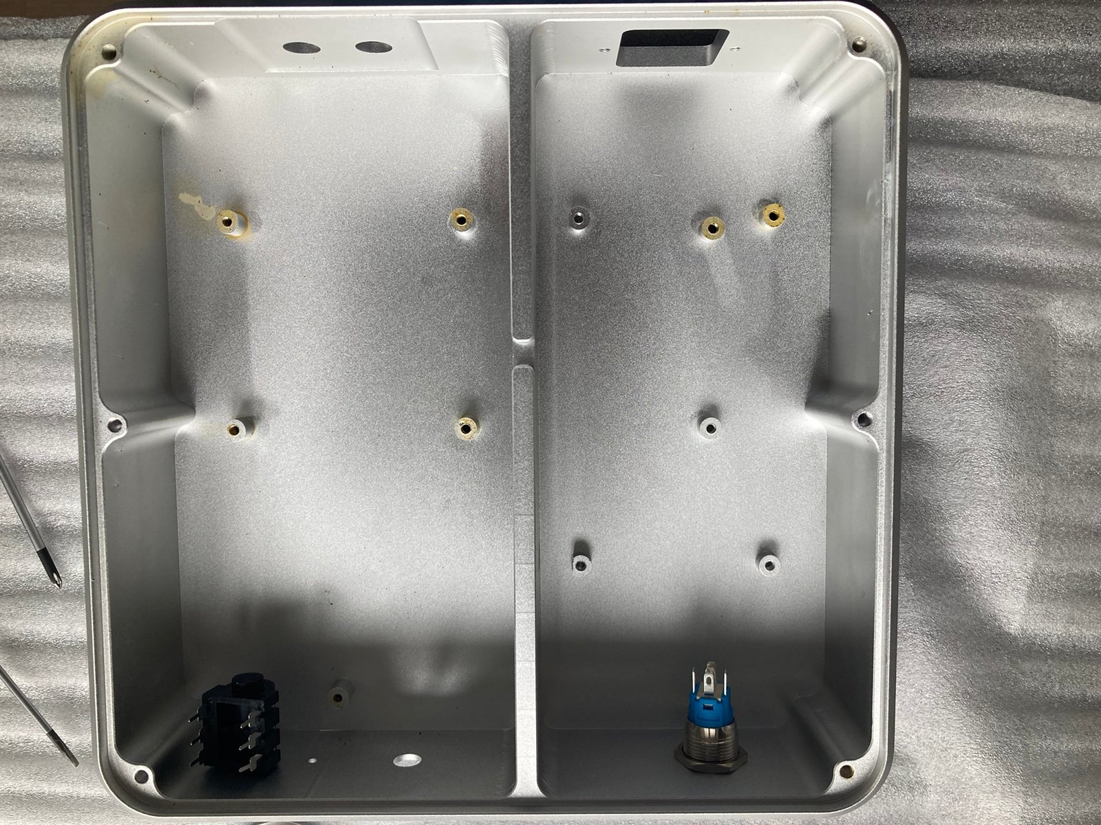

In my device, I used a custom CNC-milled aluminum enclosure. If you put a cell phone inside such an enclosure and call it, the call will not go through because the enclosure is capable of completely blocking incoming and outgoing radio waves. Ordinary enclosures consisting of separate panels connected by screws do not have this ability.

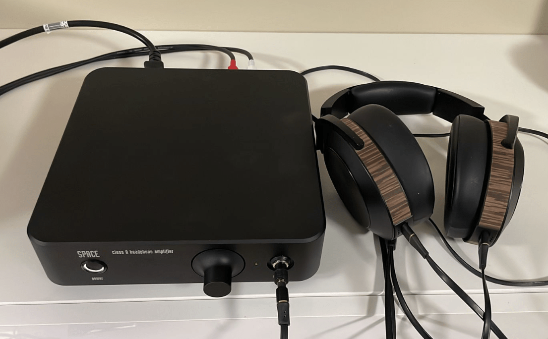

The listening experience of the device revealed the following distinguishing features:
Tech specs:
Input connector type: 2xRCA unbalanced
Output connector type: stereo 6.5 mm
Input impedance: 10 kOhm
Output impedance: <0.8 Ohm
Frequency response: 5-30000 Hz (-3db)
Gain: 10.8 dB
Channel imbalance: <0.2dB
Max output power: 200mW at 32 Ohm
- At first, the sound may seem uncomfortable, and adaptation is required.
- After adaptation, the amplifier encourages increasing the volume more and more. The most exciting sound, in my opinion, is achieved at SPL above 90dB.
Tech specs:
Gain: 10.8 dB
OK Skippy, is there a circuit or should this be a preamble in the Vendors Forum ?
