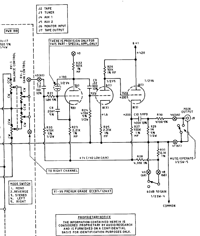

Several years back I made a set based on the Audio Research SP-6 circuit, using ECC82's. It worked fine but I settled for something else at that time: I dumped it in favor of a 6J6/E90CC amplifier that only had 12dB of feedback. A winner apart from the microphonics of the input, the reason I discarded it after 15 years of use in favor of the Aikido.
• Original SP-6 line stage:
So I reverted back to the concept of the Audio Research SP-6 line stage. I redesigned it to amplify just 12,5 dB instead of 26,4 dB.

The basic SP-6 circuit.
The basic topology of the SP-6 has two stages and an output buffer. In contrast to other circuits, there is a DC feedback from the output to the first stage. All others have a DC-blocking capacitor in between. This is a secret of the circuit.
What can be improved or tweaked?
  1. First of all the stock SP-6 amplification is quite high, 26 dB (100k/5k). We nowadays like a lower one, like 15 dB.
  2. It runs on an unhealthy 420 Volts (jach) and needs a lot of regulation. Too much for me. I decided to use 250V max (because the existing HV PS of my Aikido already had that). But I want to keep the high output of > 20V RMS at < 0,02%. I like a high driveabiliy – a DAC can provide max 2,2 V RMS but a RIAA preamp can surpass that easily. The F5 with its +15 dB needs this high drive.
  3. The output impedance is rather high, even with all the feedback (100k current source).
  4. The coupling between the two stages makes a difference. The C22 used something like 22nF here and Hiraga 33nF in his RIAA instead of the stock 220nF. It influences the low end.
  5. The RIAA stage has a 20 pF cap between anode and grid; the line stage does without. With all the feedback and inherent this component is essential.
  6. And the stop resistor (1k8) in the stock line stage needed an experimental review of the value because of the trim cap I added.
  7. The grid to cathode cap of 20pF is part of the design; I wanted to see if it has impact.
  8. Some designs like the McIntosh C22 have a positive feedback to the second stage. It is claimed to give higher dynamics. I decided to test that too. It does of course decrease the anode current and increases the output DC level.
  9. The ECC83 has too high an amplification, so there is need for lower mu tubes like the ECC81 or even ECC82.

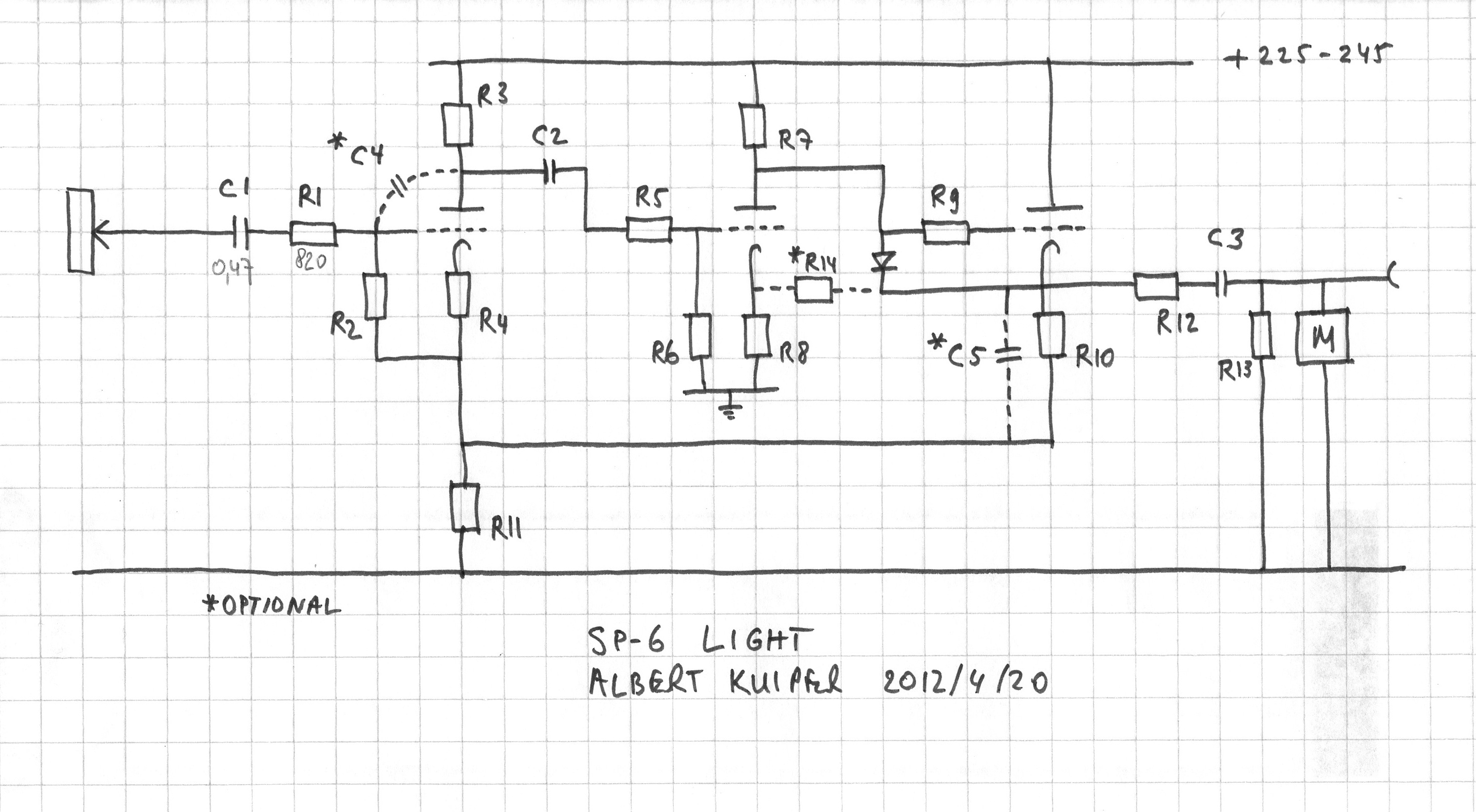

Final SP-6 ECC801S Light schema

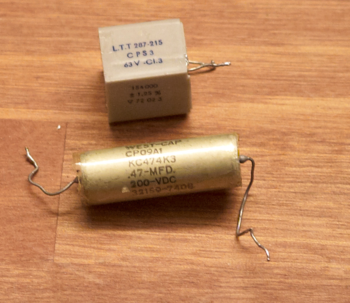

C1 - Input: 0,47 Westcap PIO or 154 nF Styroflex.
C2 - Coupling cap: 100nF 400V or 220 nF 250V I choose Philips MKC.

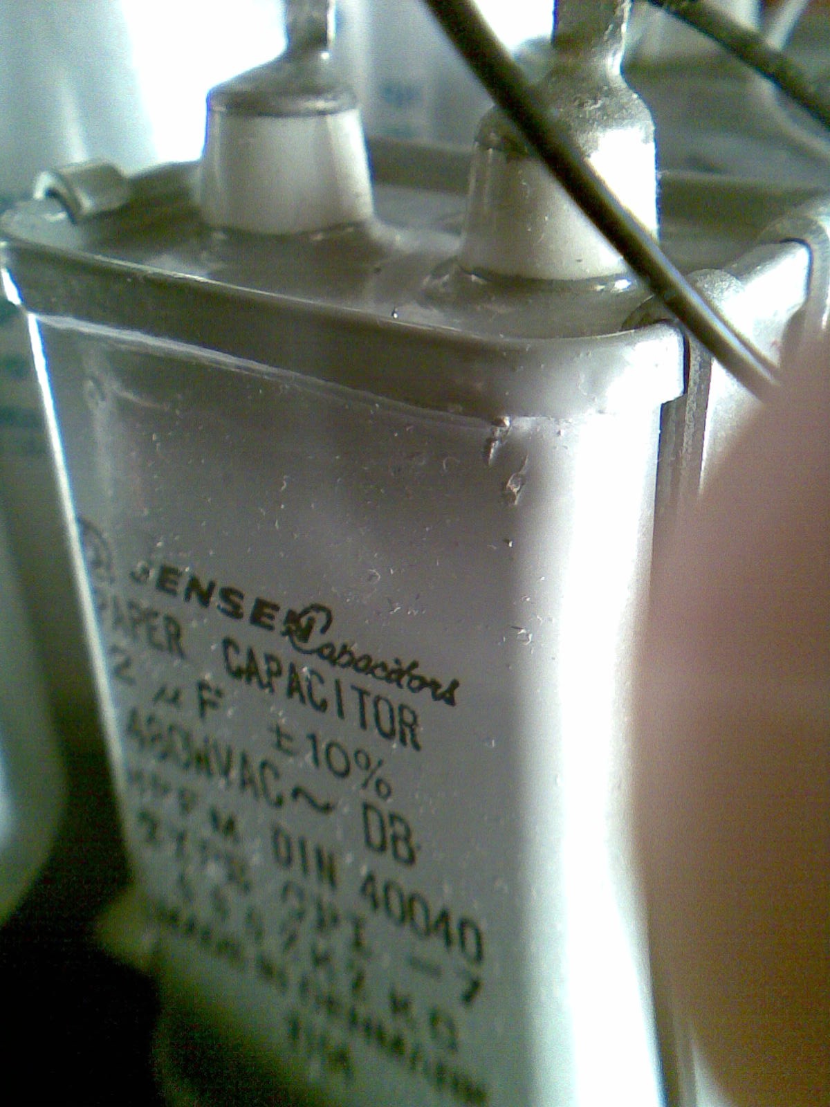

C3 - Output: 2 muF 600V Jensen paper in oil. Take the best you can find. High voltage rating.
C4*: input trimmer 4-20 pF ceramic, trim for best square wave. (discarded in final version)
C5*: Feedback cap. Originally tried 18 pF 250V styroflex for a 250 kHz roll off. (discarded in final version)
R1 - Stopper resistor : 820 ohms, carbon film, low inductance.
R2, R5 - Grid leakage: Dale 1M
R3 - Anode resistor: 94k. Needs to be low noise.
R4 - Cathode resistor: 2k2, metalfilm, low noise
R6, R9 – grid stoppers 1k2 to 1k5 non inductive Allan Bradley.
R7 - Anode resistor second stage: 51k Dale 2W
R8 - Cathode resistor second stage: 820 ohm, metalfilm
R10 - Feedback: 33k 5W Allan Bradley pressed carbon
R11 - 10 k metalfilm 2W. Can be changed to get desired amplification.
R12 - output damper: 300 ohms, Dale 1 W
R13 – 100k earthing
R14 – optional positive feedback, 330k
T1 - ECC801S. Long life version and gold pins.
T2 - ECC801S
T3 - Output Buffer high mu: PCC88 or ECC88 only use section 1 (pins 1/2/3). PCC88 is similar to ECC88 but has a higher heater voltage and a higher Vfk. A PCC88 or ECC88 (like PCC186 and similar) has two unequal halves. The sections differ in the max Vfk: the filament to cathode voltage. ECC88 section with pins 1/2/3 was designed to be the top of a cascode with a Vfk of 150V; the section with pins 6/7/8 are designed for the input of a cascode with a low Vfk voltage at 50V. So I use section with pins 1/2/3 only as buffer.
D1 – 1N4001 pass diode for start-up. In the SP-8 Audio Research did not use a diode but a JFET connected in a special way: S+D to grid, gate to cathode. Might be a sonic improvement.
M1: mute circuit 2k, IRF640 drives a relay. Delay 10 sec.
The C2 coupling cap has a big impact. Various types differ in the amount of ringing in the ultra high frequency range. Take a small type. A small size to fit on the socket itself.
The R3/R7 anode loads have to be good, low noise. I use 5 watt carbon resistors. But I might settle for even better WW
The R10/R11 resistors in the feedback (43k or 33k/10k) made a difference, but layout issues I found out about later made me aware of stray capacitances in this design – touching a component brought some ringing or damped the square wave. I like non-inductive types here as they set the poles directly.
With R14 I tried the positive feedback. With a 330 k resistor from the output to the cathode of the second stage, the open loop bandwidth lowered from 62 kHz to 55 kHz. I also tested this option with the distortion meter. Distortion rose a bit! In circuits like McIntosh C22 and Hiraga RIAA it is 330k, although the output buffer is at 200 volts in those designs. I did not seek an optimal value for the feedback resistor, I just left it with the value of 330k and a cathode load of 820ohm like in the C22.
I initially had a styroflex capacitor on the input, 63 volts, 153 nF, enough to give <2 Hz low end bandwidth. I later used 0,47 muF. It could be the Westcap is slightly bright.

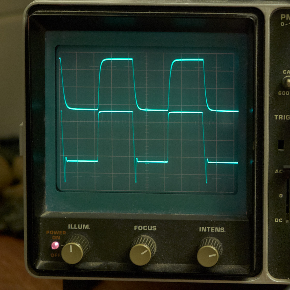

Bandwidth stays rather constant with a potmeter of 50k: a very good sign. This implies the sonic signature stays constant (unlike other topologies!).

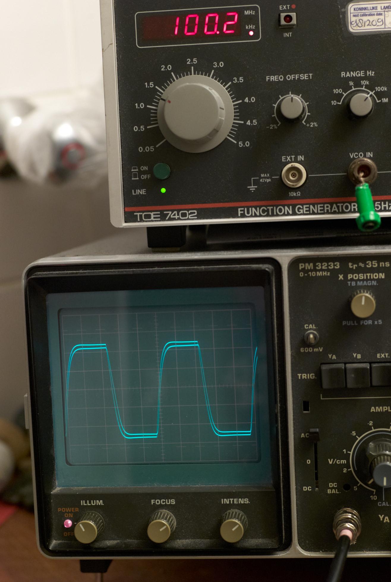

Square wave 53 kHz with 18 pF feedback (top trace):
SP6 with:without FB cap51.jpg

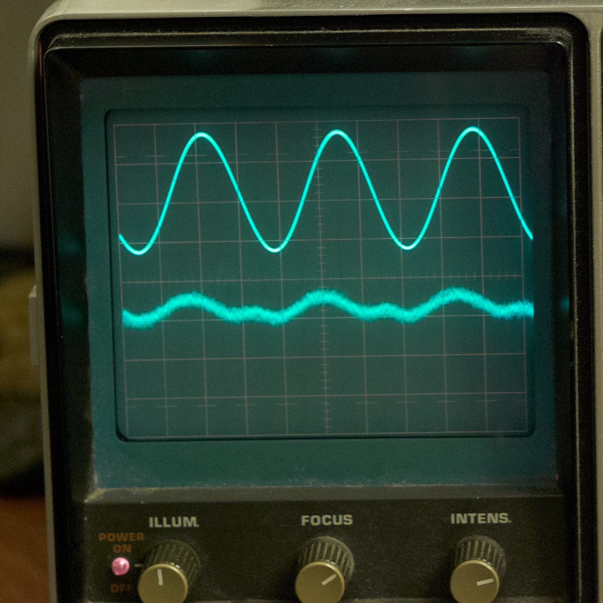

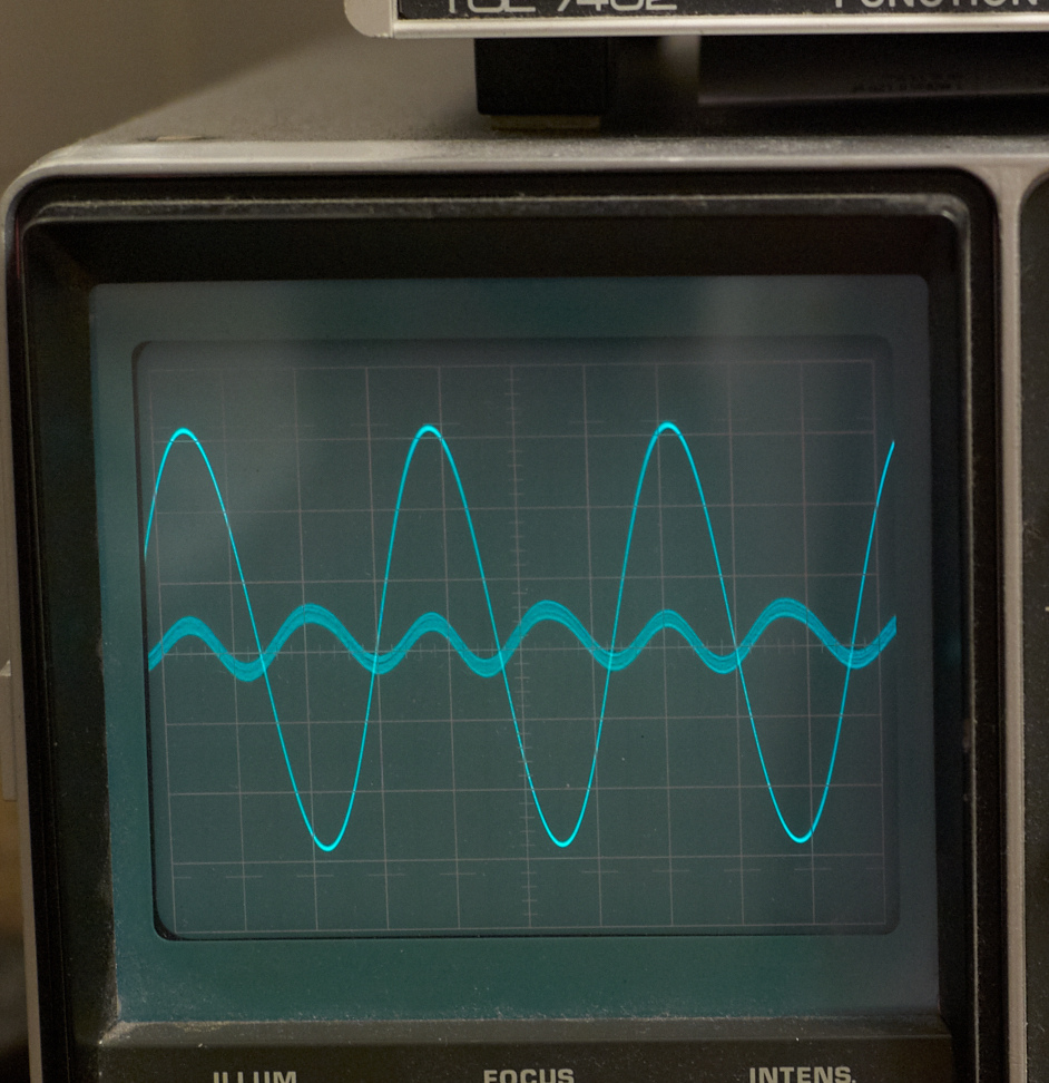

Distortion
Distortion measurements, prototype with/without HF roll-off in feedback and on anode/grid:
Generator 2.965 Hz
+ 20 dB 7 V RMS < 0,02%
+ 10 dB 0,7 V RMS 0,008%
with positive feedback applied, 330k between cathodes: 0,02% (increased)
With 18 pF on 33k feedback: less noise visible on screen and the distortion dropped. It was visible on the scope (the difference signal from the distortion meter).
Visibly, but unmeasurable, there is a hint of 2nd harmonics.
I conclude that it is not needed to use the positive feedback. So I dropped it.

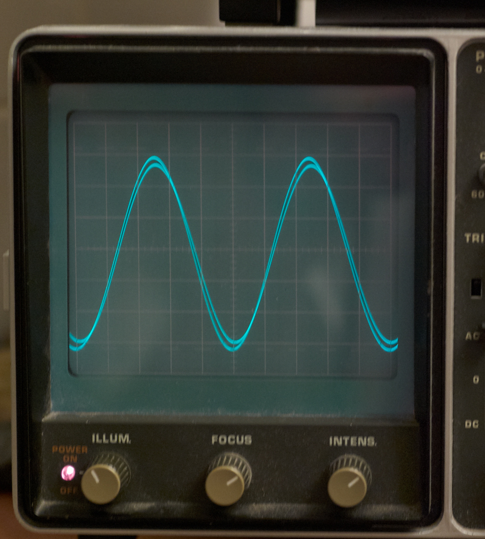

Distortion at 2 volt RMS out, <0,01%
The SP-6 Light can easily output 20V RMS without clipping.
Without the HF compensation, the distortion at mid frequencies 2.965 Hz did not change. So I stopped with the compensation al together. I found this improves the sound!

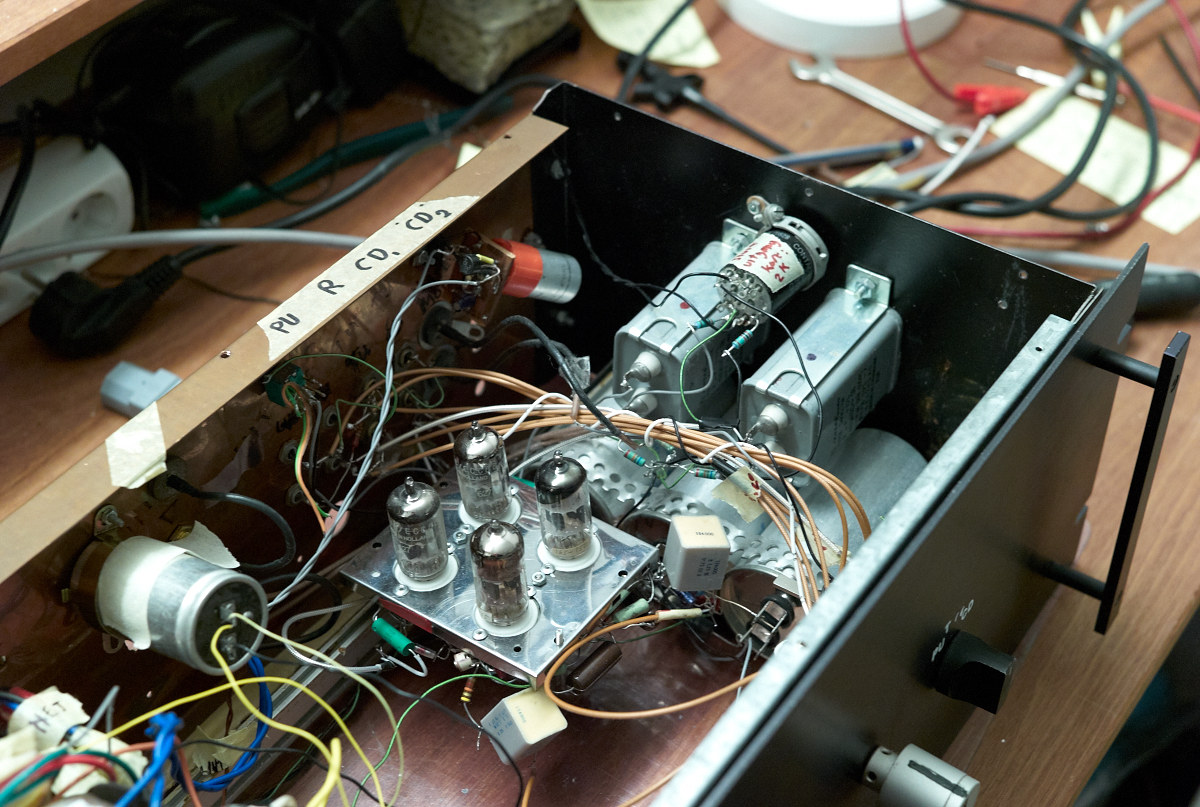

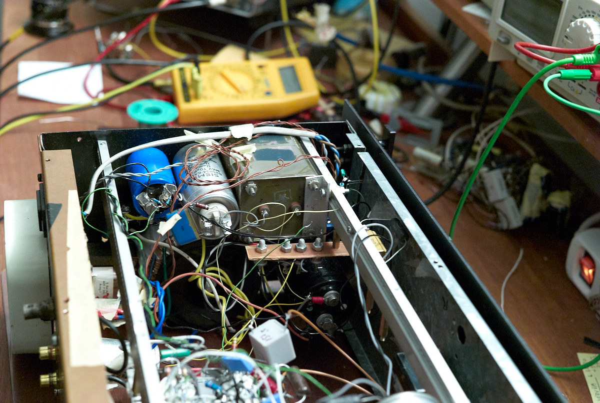

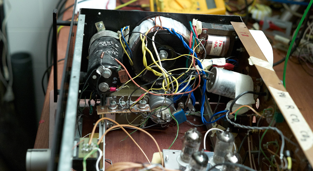

A top view of the SP-6 circuit in my existing cabinet.

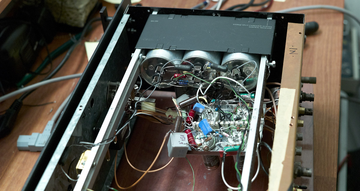

The bottom of the amplifier. Now this is point to point soldering! (apologies for the mess. This is what it looks like while experimenting . . .)
To the side there are three 40 muF MKP capacitors that form the final stage of the power supply.

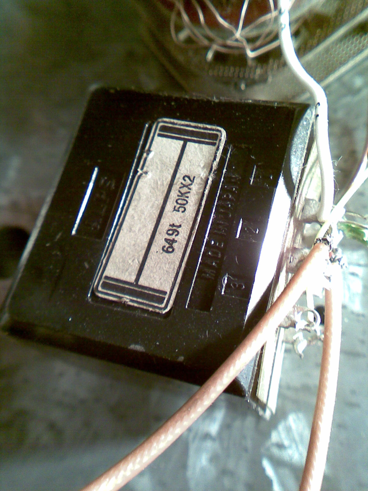

The output caps

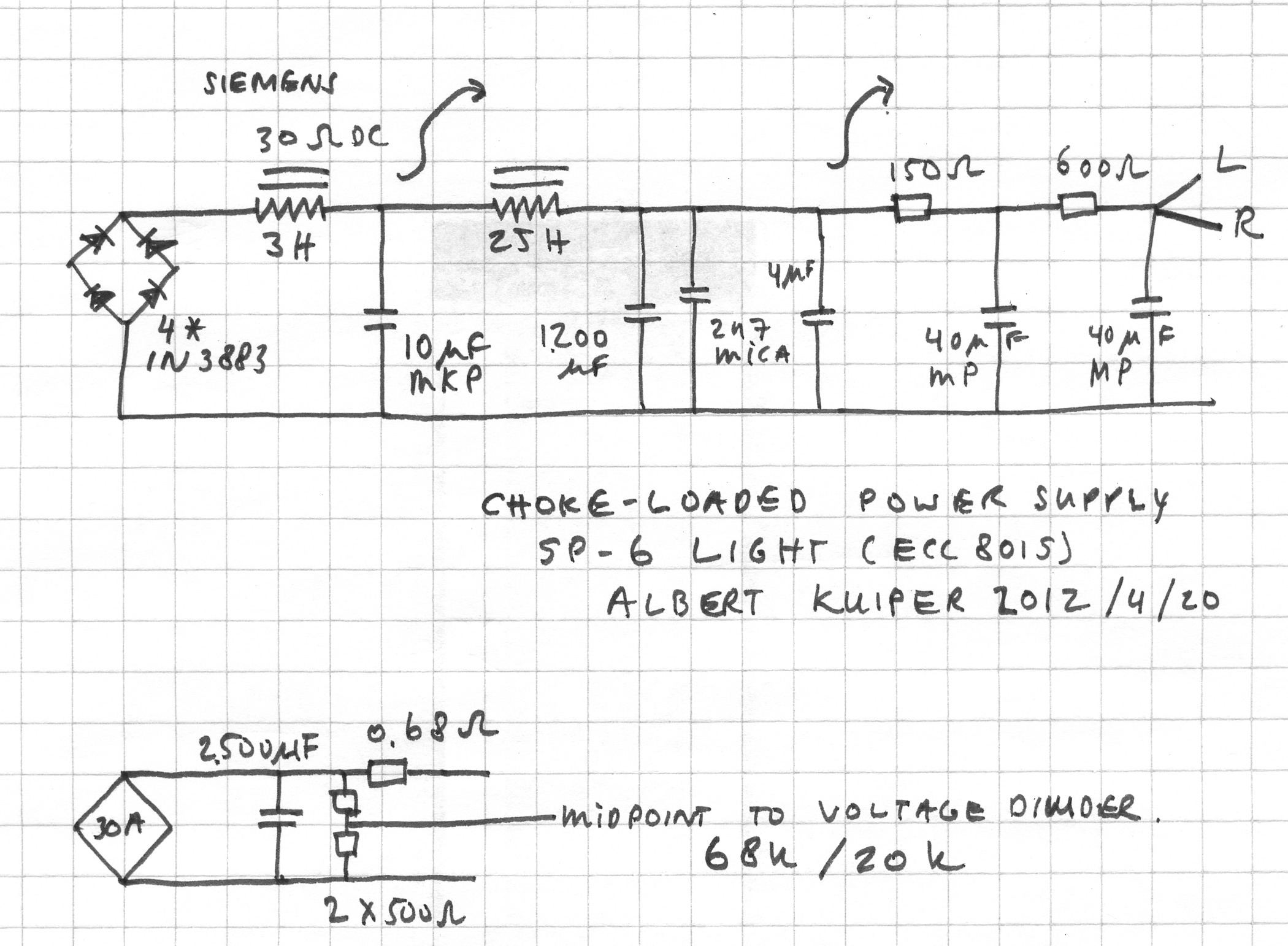

The power supply for the SP-6 Light
Power supply SP-6 Light
I reused the components of my Aikido (everything was there already) but I changed the configuration dramatically: from a traditional CLCLC (10mu/25H/1.200mu/3H/10mu) to a choke loaded circuit LCLC: with a choke up front.
Advantage: you get reduced ripple, low load on the trannie (you can't get saturation this way) and load regulation all at once.
I took the 3 H (70 ohms DC) choke directly after the rectifier, then 10 mu, subsequently the hefty LC pair of 25H/1.500 mu. While in the old configuration I had a lot of mains residue, now none was left!
On my B&K: 2 volts RMS in cell 1, 2 mV cell 2 (with 3-5 mV line fluctuations).
And this configuration provides regulation, with 225AC in I get around 245 plus or minus 5 volts out for a range of current.
Heaters are DC. The 0,68 ohm drops the 7V to 6,15 V. With the PCC88 I will connect directly to the +7V, and increase the series resistor to 1,2 ohm or I will insert a transistor.
Not shown, a muting temporization circuit (using IRF640 driving a relay and a slow start delay of a resistor and capacitor that shunts the output with 2k for 10 seconds) is fed from a 12V winding.

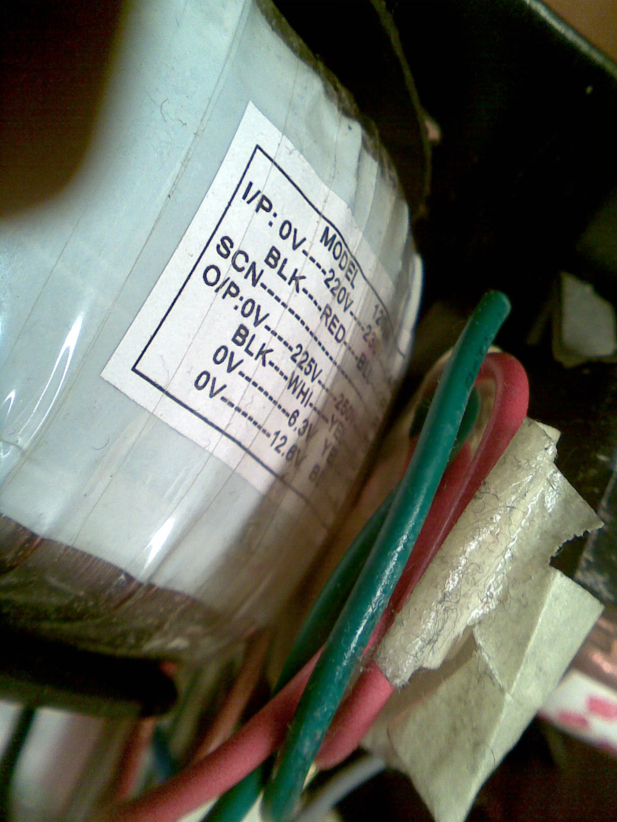

I now use a 225 AC winding; my transformer has a 250V and 275 V winding too so I plan to add a tube rectifier and use this as an additional slow start option.
The transformer (Yes it is BIG)
The power supply. The 3H choke for the choke loading is on the right top.
The bottom of the power supply. You can see the array of the 1N3883 power diodes and the 25H second choke as well as the Felsic 1.500 400V electrolytic.

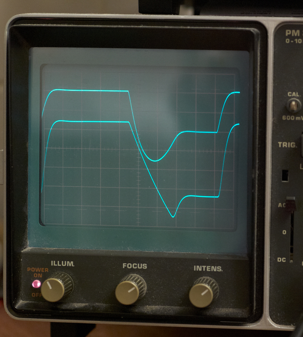

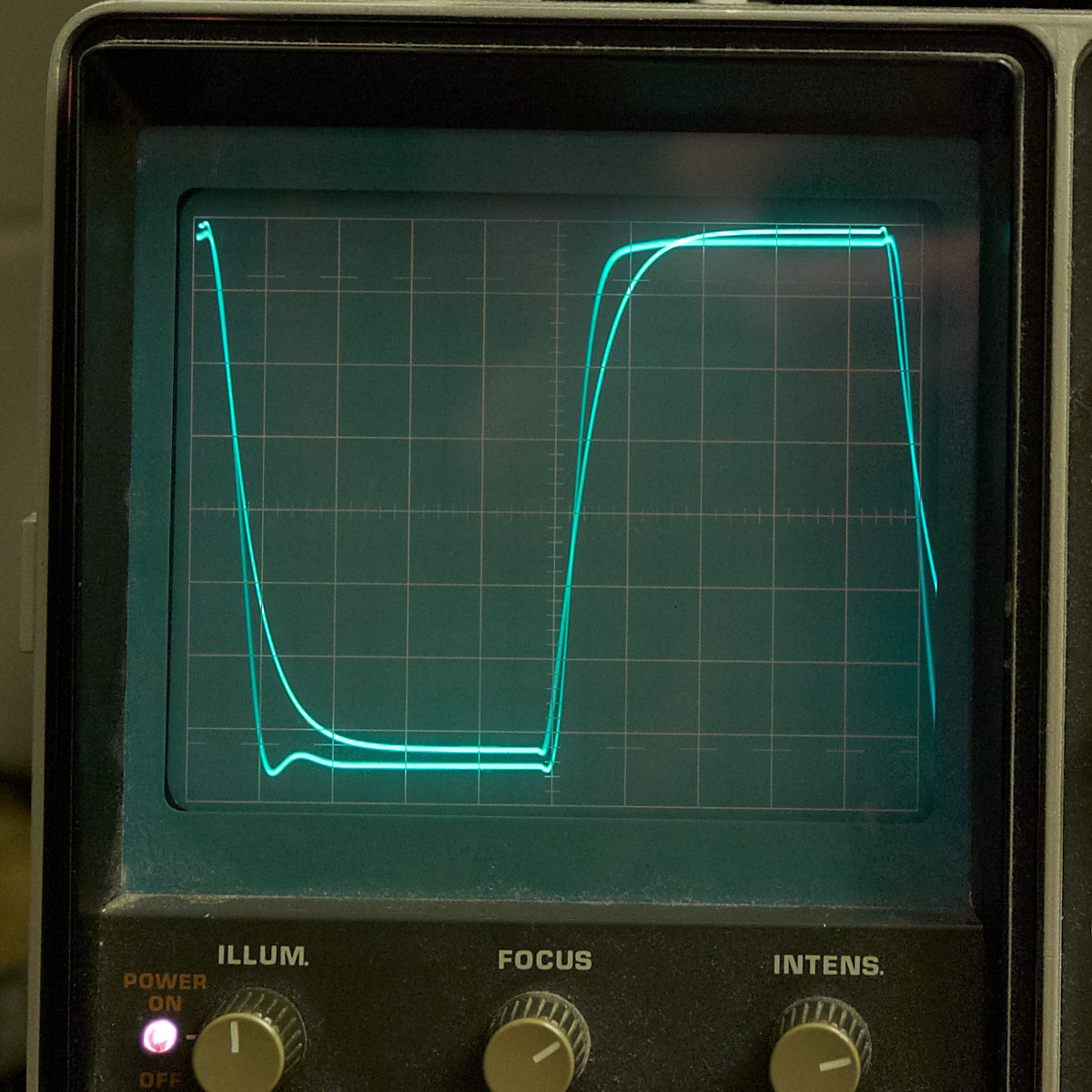

Overshoot

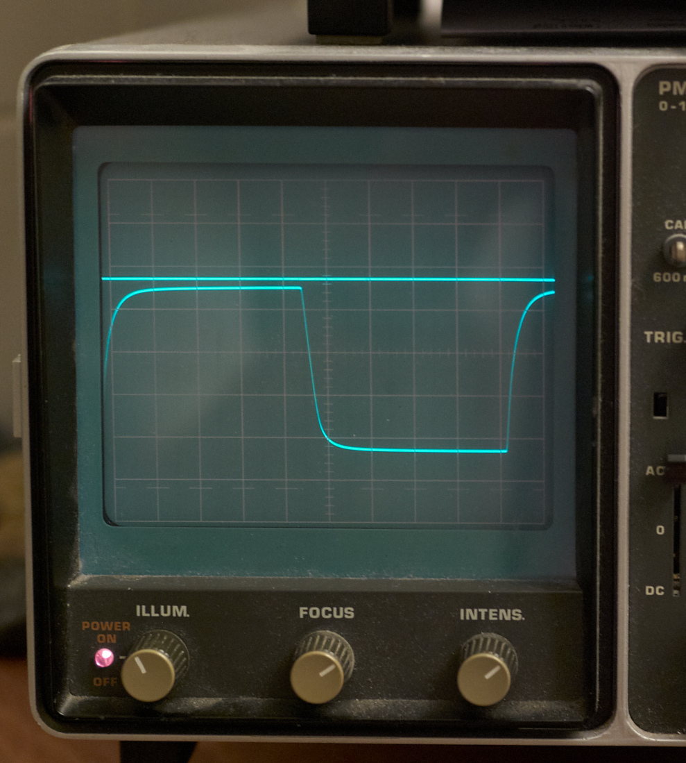

My initial prototype had enormous overshoot as well as motor boating. I could not get that out of the system, I once even got HF oscillations, but that helped me find out why: with little steps of improving the layout I got the configuration to work. Besides layout it was the output buffer in one channel.
The first prototype stuffing was with 10nF/1M intermediate stage, no input stopper, and had a lot of overshoot in both channels, but most in one channel: on the downward slope, so I almost discarded the whole idea.
Severe 'down-shoot' on one channel, bottom trace
I added the trim cap (5-45pf) and could influence the rising edges of the square wave a lot, but it stayed awkward.
After days of experimenting I found out a first reason for the bad behavior: I had no stopper resistor so the signal generator bounced against my input. The circuit has 1k8. I tried 20k and 2k and finally settled for 12k as a nice value that gave me ample space for trimming the square wave.
The result was now as follows: one channel with 18pF and the other the input trimmer optimised:

Solving overshoot?
There is an input cap C1. I first had this cap directly on the tube pins and in this way placed in a crowded environment between the other components – in that way I found out it gives stray capacitances. I then placed the stopper resistor of 12k on the pins getting the input cap outside of the component board. This was my most important change!! It solved most ringing problems. But it stayed in one channel. The change meant that the input cap did not have a proximity effect anymore (pick up stray airborne Heaviside radiation. Heaviside said around 1910 that there ius more energy outside of the conductor than inside . . .).
I can imagine a PCB implementation that is completely perfect in the placing of components.
The coupling cap C2 between first/second stage did seem to matter too because the various types I tried had quite different amounts of ringing (but the problems I had could afterwards be due to proximity coupling with the input cap, see above). For instance I had the counterintuitive result that a 10nF mica hade more ringing than a MKC – but that was standing out from the socket with 4 cm. Stray radiation again?. I added a 1k2 stopper resistor here, but that had no visible effect. Anyway, at the end I again settled for a 100nF/1M coupling.
I used a 18pF cap on the feedback resistor. This reduces the bandwidth to something like 270 kHz and gives a smooth square wave. Without it I can trim the square wave with C4 and get a minuscule ringing (overshoot) around 400kHz. (See picture above).
The components in the feedback also seemed to matter (but again - I had initial layout problems and a buffer issue). I tried 37k wire wound NI but this looked worse. So I settled for carbons.
But looking back the bad effect I thought it might probably due to a worse alignment of parts.
- - - But I will revisit this ringing again . . .
(at the end I found out the ringing in the left channel came because of a bad buffer tube – not bad layout or components!!!)

21/4 So after a lot of tampering, one channel is very good, square wave without overshoot, no trimming caps and no feedback caps. The other channel however still has a 5% ringing in the 3 Mhz area. The down-shoot. See picture above, bottom trace. I can’t get that out!
Tried other interstage coupling caps, other stopper resistors. No improvement. Tried reducing amplification in second stage – no effect. It must be a layout problem?
Rolled tubes and that way found out: the overshoot comes from a bad ECC88 in the output. One had a problem. This made the large overshoot. Replacing the tubes with PCC88 (I don't have more ECC88’s) I have the same very small overshoot in both channels now. Maybe I should try another output tube.
Tried ECC82. Did not look better on the scope. Does work though.
Have now Westcap fitted input cap 0,47 muF. Might be bit bright.

I mentioned a slight brightness in records: It could be the Westcap (bottom) is the source of brightness? Should I try the Styroflex (top) again? First I will check my RIAA with an anti-RIAA circuit.

Today I rechecked the implementation.
I implemented a 6SN7 version: same phenomenon as above though less exaggerated unless pushed very hard.
I saw that the second stage overloads the output, when this downward sag exists. This is even better visible with the 6SN7.
As I stripped down the circuit I found out that the circuit sans the cathode follower was OK: flat to 320 kHz. At 10 V RMS out. Perfect square rise times, maybe not wholly symetric, but very good.
Then I reinserted the CF, and added a parallel load resistor of 18 K. This solved the whole problem. The issue came from starvation of the CF!.
Now there is no overshoot, the circuit with 6SN7 is flat from <2 Hz to 380 kHz. :)
And very dynamic I expect.

6SN7 version, pictures
To start off, I have a picture of the problem area of the first config. This shows the output (53 kHz, 10 V RMS) at the anode of the second stage and the output of the CF: it is clear the CF is starved, the driver overloads it.
So I just added a resistor to earth, with a dummy load of 5 mA, and this solved the whole problem:
Here you might suspect the falling edge to remain a little bit constrained (straight line). I checked that with a 100 kHz square wave of 10 V RMS out, to review the alignment.
A sine shows the lines are perfectly aligned now, there is only a bit of phase lag and the odd dB of insertion loss (that is normal for a CF). The HF roll off is above 380 kHz. It is very smooth, no artifacts.
This definitely is promising isn't it?
Pushing the limits of the E801S version
After this succesfull experiment with the 6SN7 I reverted to the version in the living room to adapt what I just learned with the 6SN7 experiment: get a higher current for the CF. 3 mA plus looked rather good to me as it was, but I added a dummy resistor also here to earth, that consumes 2,5 mA.
This gave more air definitely. The - 3 dB bandwidth is now an astonishing 687 kHz. This limit is clearly slew-rate limited (downward slope), so the buffer can be optimised further. The bandwidth could then reach 1 MHz easily ... No overshoot on the square wave, a slight nervousness can be seen on the settling edge (not an oscillation). With the 6SN6 you can see a relaxed settling, here with the 801S it bam locked. It is the higher feedback.

The square wave of 100 kHz: pure music.
This is nice behavior, no RC in the feedback, no HF shunt in the first stage . . .

I have implemented a shunt DC for the heater of the 6SL7 tubes. It has a slow start with an idle current of 120 mA for about 5 seconds, before the voltage is slowly increased. This way, there is no surprise for the tubes.
View attachment Power Supply RIAA V3.pdf
The result is excellent. After about 15 minutes of warming up, the amplifier is full and warm blooded.
I have the 6SL6 in series because the winding I have is 12.3 V nominal (actually more than 13), so I could have cut the winding into two parts (the winding of the center tap is available), but that would double my components...
The schema works at this lower voltage too, but resistances have to be adjusted for 6.25 out.
The drop over the slow start FET is < 0,1 V. So it is negligible. This FET does not have a heatsink.

I see I left some things to the imagination:
http://www.diyaudio.com/forums/atta...1335184329-sp-6-light-ecc801s-sp6-final-2.jpg
But I omitted C4 and C5 altogether. Also I did not use the positive feedback of R14. At the end on the distortion analysis I think I did not like it; but audibly I heard no high extra dynamics. So conclusively I decided for keep it simple.
The value of R14 also has impact on the setting of the whole amplifier and would have required too much experiments to get a good value where its effect is audibly positive. I think with all the feedback its impact is also negligible and thus might result in higher order distortion, invisible for me.
I must say I have an old fashioned distortion meter and can not see more than about third harmonics.
I might have a look again at the final resistor values (R10, R11) what I finally did use.
hope this helps you
albert

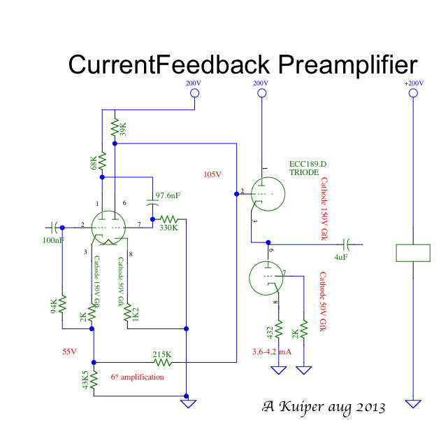

The new Current Feedback preamp with ECC88.
I found I had some rectifier sound in the output. When I connected a Lowther to my power amps (PP 300B) there was a big 'buzz'. And there was a also some hiss. Without the preamp the power amp was completely silent. Even with the 5V filament in AC...:)
So I went ahead in fixing the preamp, and in the mean while - - - I redesign the whole lot.
  • A first design decision was, that if I wanted to get a preamp with the lowest noise floor, I should revert to E88CC or even E188CC in the first stage.
  • I would need a very silent HV, so I installed a Salas HV at 200V.
  • Noisy ECC88?? Well a subsequent find was that the heater influenced the cathodes. I had the heater at plus 50 volts (I thought) but measuring, it was lower (20V), so something was wrong. I connected a mA meter and found some 3 mA were dumping in the cathodes. The heaters were at a divider of 68K/20K. It just disappeared when I connected the heater center to earth. Then also the noise in the tubes disappeared (for a large part). I found the tubes to be most silent when I connected it with 20K, bypassed to earth; the current was then 0,0145 mA.
  • I took all care to get a star ground. Both halves and the output stage are connected separately to the ground and plus.
  • I also decided to omit the feedback from the cathode follower and revert to a proper line stage feedback, directly from the first anode to the input cathode. I had seen before this gives no overshoot, is perfectly stable and is wide band: from < 1 Hz - > 350 KHz. So all problems I had of loading the output before, from slew rate limiting are gone all at once.
I tested the input with a LED as current source at the cathode. But this was very noisy (the LED's zener noise is amplified...); even connecting a cap across it did not help. So I selected a resistor to give the same 1,88 V drop (1,8-2 k).
So I have simplified version here that I like much again.
Note I have reverted to ECC88's and I must mention the two halves are not similar! The first triode half (1,2,3) has a Vfk of 150V, the second one (6,7,8) of 50V. So I must use the first one in the entrance because it floats at +55V ; the second one is used for the second stage. In the CF output I have (1,2,3) on top of the cascode-connected CF, and the section (6,7,8) as the constant current source. Because of the CCS I do not need a diode safeguard between the top grid (2) and the cathode/anode (3;6). I always suspect these diodes of some sonic effect.​
  • Preamp CurFb.pdf
