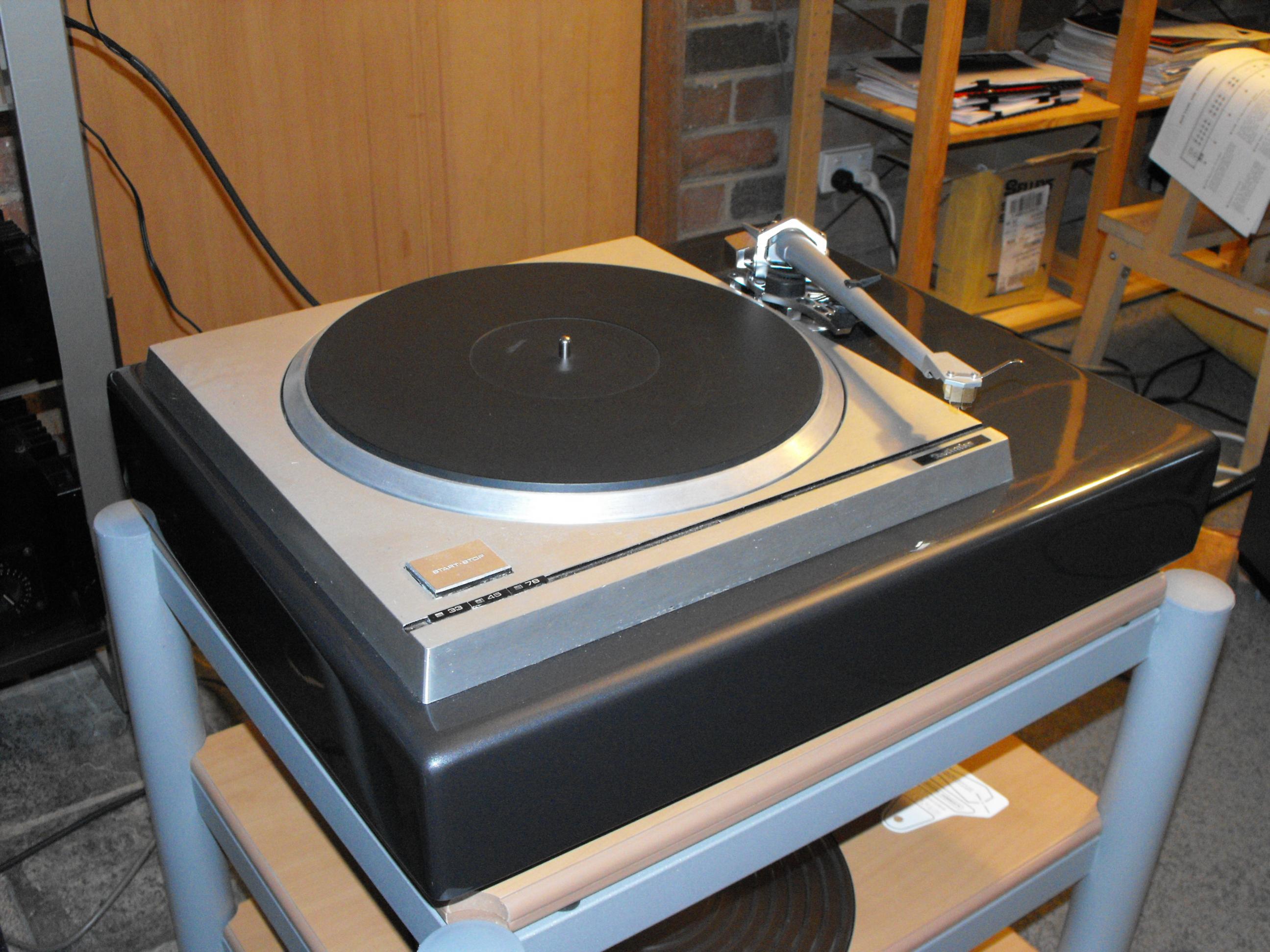

I think Cats Squirrel's comment is very relevant. How and to what you drain is important. I have used SP10 mk II as my main TT's for 15 years and currently have two operational, another two in storage and one incomplete as a parts donor. I noticed early on that the main bearing cap is just about perfectly flush with the rubber membrane that covers the hole in the base cover casting. When the chassis is sitting on a flat surface, the rubber membrane/bearing cap sits flush on the surface. I have always mounted my SP10's sitting on one or two sheets of lead. My preferred cast resin plinths have internal depth calculated to accommodate the lead sheets. The resin plinth are superbly damped anyway and the lead is just icing the cake. I would be very wary of spring loaded coupling of a drain component. This just introduces a potential vibrating component just where it can do the most sonic harm.
On a general note, the bearing material test results seem to indicate that the bearing material is not a limiting factor in the SP10 mk II performance, as it is currently set up. I take this as encouraging. My experience is that plinth materials and construction do make audible differences to the performance. Maybe your measurement methodology can be applied to evaluating differences in plinth construction. I am in the high mass + stiffness + damping camp with cast isopthalic resin/fibreglass strand construction.
Polyester resins, most used resin systems, particularly in the marine industry

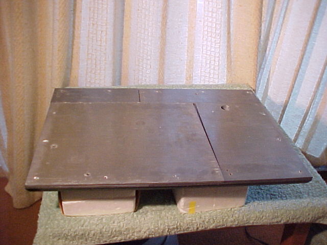

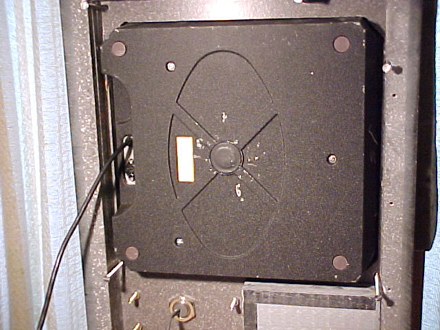

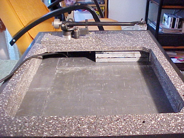

The first four pictures show my original Corian plinth with lead sheet damping. The last photo is of my resin/fibreglass plinth, base thickness 30 mm. Both unloaded plinths are approx 30 kg weight.

excellent work, bon, to be taken seriously. But I have found Corian not to be good at damping, whereas the isophthalic polyester resin, in combination with the right materials, is very good, unusual in a stiff material.
I am in the 'damping first, stiffness and mass second' camp. :)
"Taking moderation to excess..." :cool:
Then the others who read these threads, try it and aren't so particular about how they dispose of the excess shot. etc.
I bought some 0.125" sheet lead to provide plinth and dust cover damping and isolation from the environment, both mechanical and air, as much as possible for my LP12. In effect, I greatly improved the isolation between the environment and the spring suspended element which includes the motor, platter and tonearm mounting. I put a sealed lead core in my version of the turntable bottom plate (& also used that to balance out the turntable mass irregularities - important because I am suspending the entire turntable and its base on four "Airpods" which are magnetically suspended air barrier isolation stands.
I sandwiched most of the remaining lead sheet between wood panels at the sides of the dust cover which added considerable mass damping without inhibiting viewability. The dust cover front and back panels are 0.25" plexiglass and the top is two sandwiched 0.125" thick layers of plexiglass. I hear a real improvement in detail at high SPL levels with this approach when the turntable is in the listening room.
I melted down all the remaining lead I had left into molds and used them as anti-rocking weights at the tops of my HT speakers. Basically, no waste lead left:)
