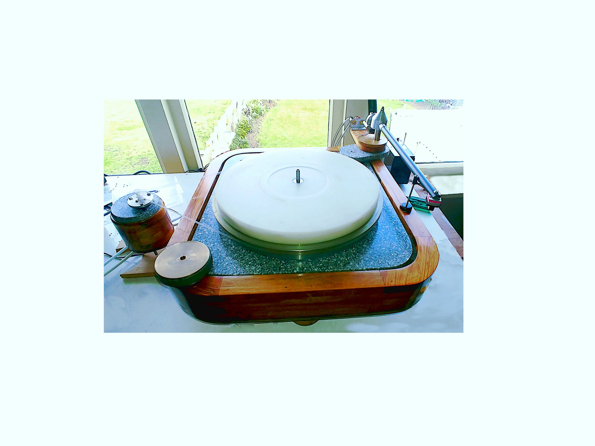

Photo Attached is a T/T I made up using off the shelf parts from Lenco & TemaadAudio. The T/T itself sits in a sand plinth & uses a Lenco L78 (balanced) platter & refurbished bearing (Wakefield UK- 301/401 refurbisher)It is driven via a separate DC motor pod & uses a readily available DC motor. Although mine cost more than $1000 to build, it can be build for around a $1000 by using Temaadaudio kitset 12'' arm option.
The performance level of the T/T completed, if you bought commercially is around $20,000, (yes I kid you not)
link for build - https://www.lencoheaven.net/forum/index.php?topic=39281.0

Have you measured the rumble and wow and flutter?The performance level of the T/T completed, if you bought commercially is around $20,000, (yes I kid you not)

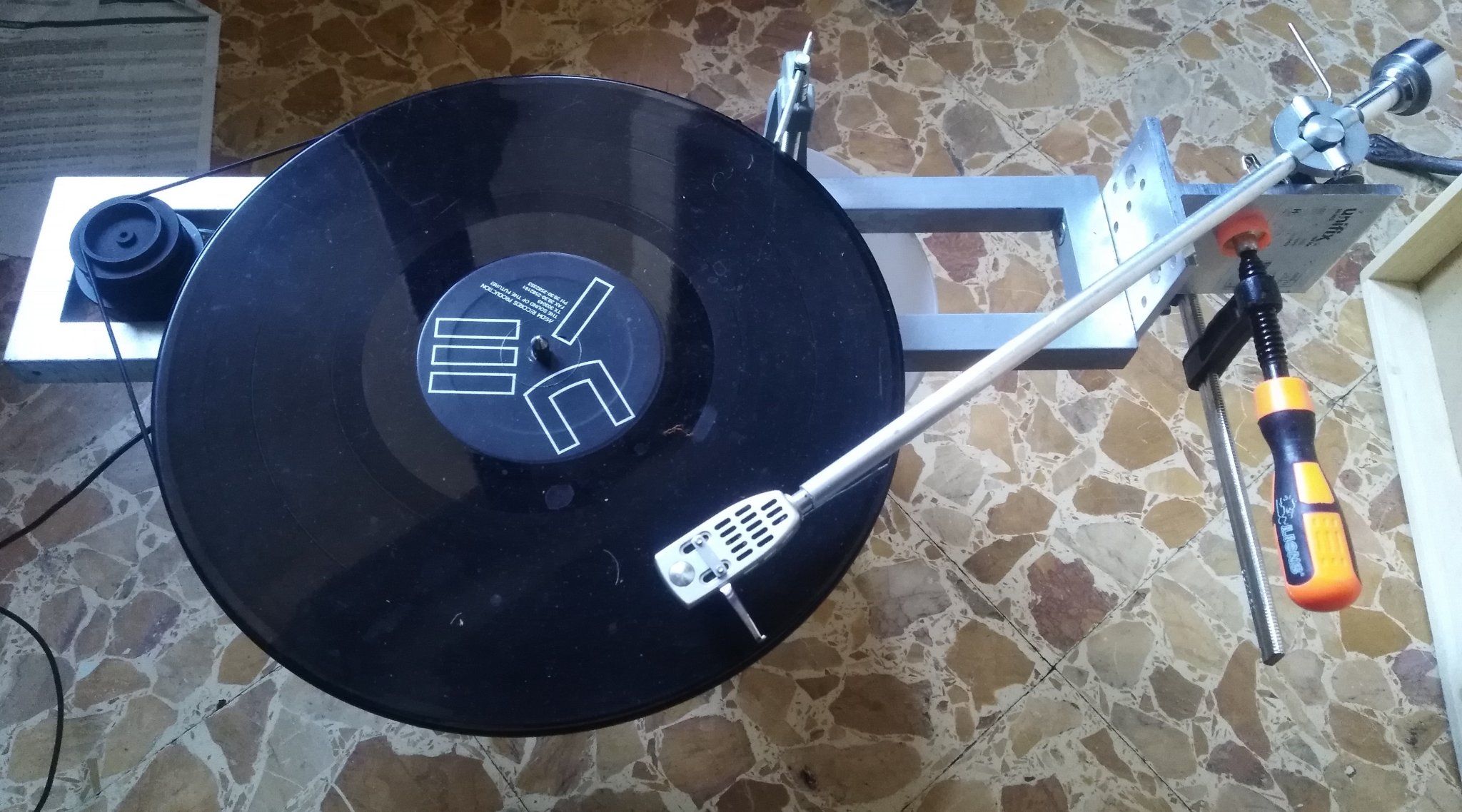

Rather impressive machine! The tonearm bearing assembly also is from a Pioneer PL 12-D, isn't it?Not the bearing, but the motor and the belt...( my attempt to a 10 " tonearm, platter&bearing from Pioneer PL12)View attachment 1020847
Best regards!
Hi Johnmath. The T/T was developed with have a fully refurbished Lenco 75 & Technics SP15 as a comparison. Both my re-versioned Lenco & the SP15 have a W&F of 0.04, the refurbished Lenco 75 is higher at 0.07. Rumble & low level hum of the 75 is discernable, but not on my L78 because partly because the bearing is sitting in a sand filled plinth no discernable rumble. Also SP15 as would be expected has no discernable rumble. Hoever using the same arm/cart my re-versioned L78 is easily the best of the 3, by a considerable margin.

Rumble generation occurs in the bearings; it's not clear to me how an external sandbox can contribute to reducing bearing rumble.
A turntable transport has a fairly simple purpose, namely to rotate the platter at a constant speed without fluctuations or noise, and without eccentricity in the vertical or horizontal axis, whilst providing isolation from structural and and acoustically induced interference. All of these performance criteria are quantifiable and therefore objective comparisons can be made between different models.
I am well aware that many brands of vintage turntable have cult like status and consequently proponents with single minded zeal. I am not blinkered by any allegiance to any particular manufacturer or model, or even any particular fundamental design approach, which perhaps allows me to a little more objective about the particular merits and pitfalls or individual turntables.
Hi, Yes rumble occurs in a poorly designed or implemented bearing, Correct, my use of the Lenco bearing was originally just a trial, as anyone who knows that bearing will agree, it does not inspire confidence. However once install with the sand filled plinth the results where so drastically superior to my original Lenco & SP15, I can see no reason why I should change.
