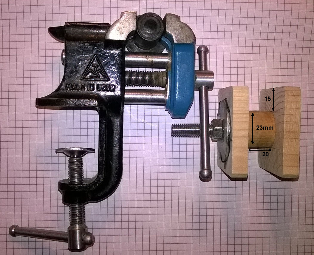

Thanks. I suppose I could wind my own inductors. I have a metal lathe that can be run at very slow speed (<<1 RPM). I could easily make formers to wind the coils on.

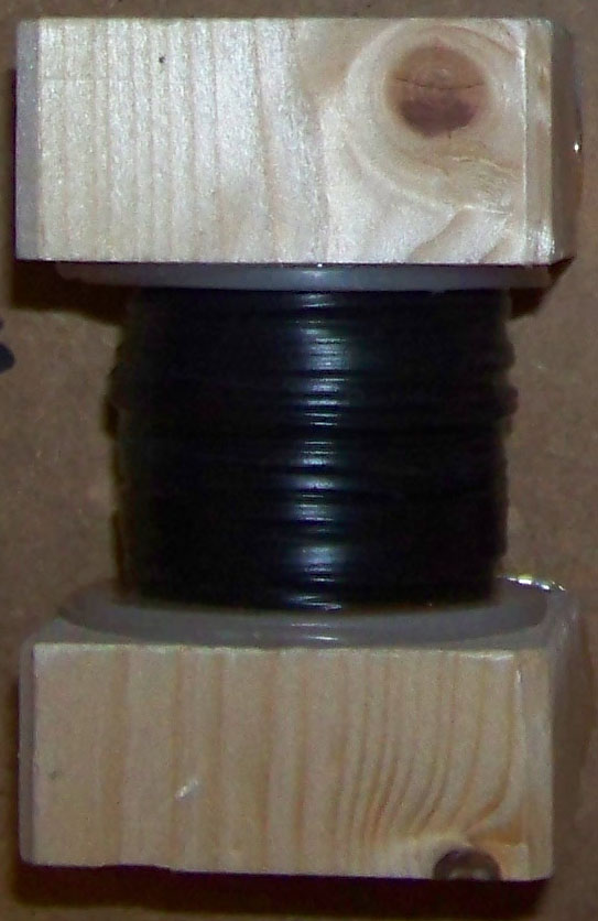

I mostly buy the 20AWG Jantzen air cores and the 18AWG ERSE I-cores from parts-express. Shame about the AUD-USD exchange rate at the moment though. From time to time I wind my own (on wooden bobbins or plastic bobbins from reels of solder/wire), or overwind/unwind what I already have to suit but I find it a chore so unless it's only a small inductor I need to make or a minor rewind job then I'd rather just buy a new one.

I also built my own coils. http://www.diyaudio.com/forums/blog...g-your-own-adventure-coil-winding-part-i.html
I would think with those two options you could make your crossovers for a lot less than $300 I think I paid about $50 for the magnet wire (14ga equivalent) but that was when copper was at its most expensive, should be a lot cheaper now.

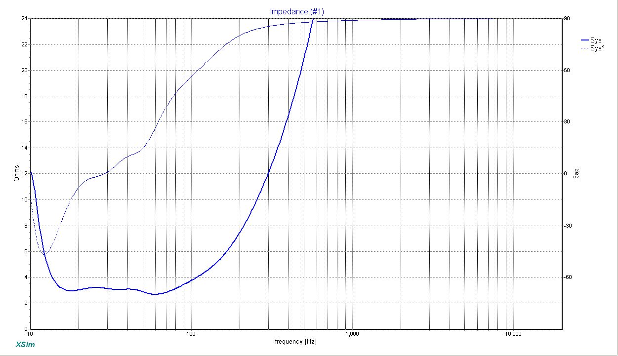

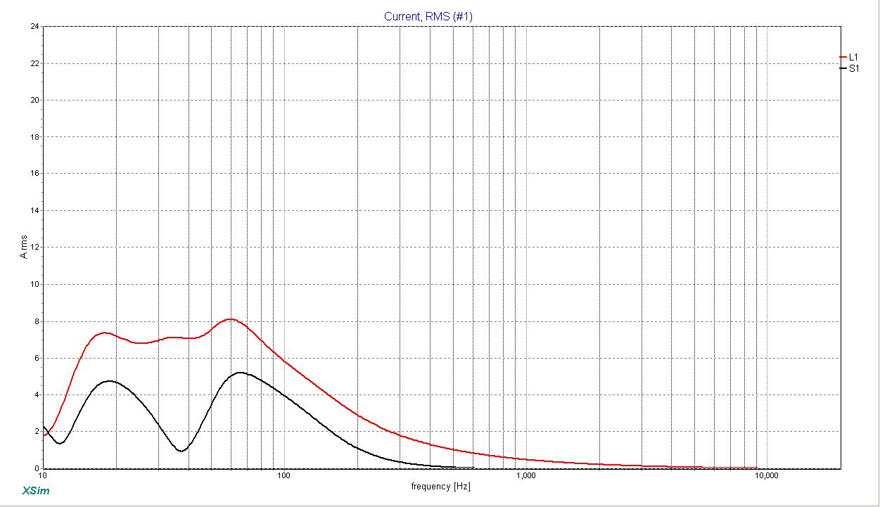

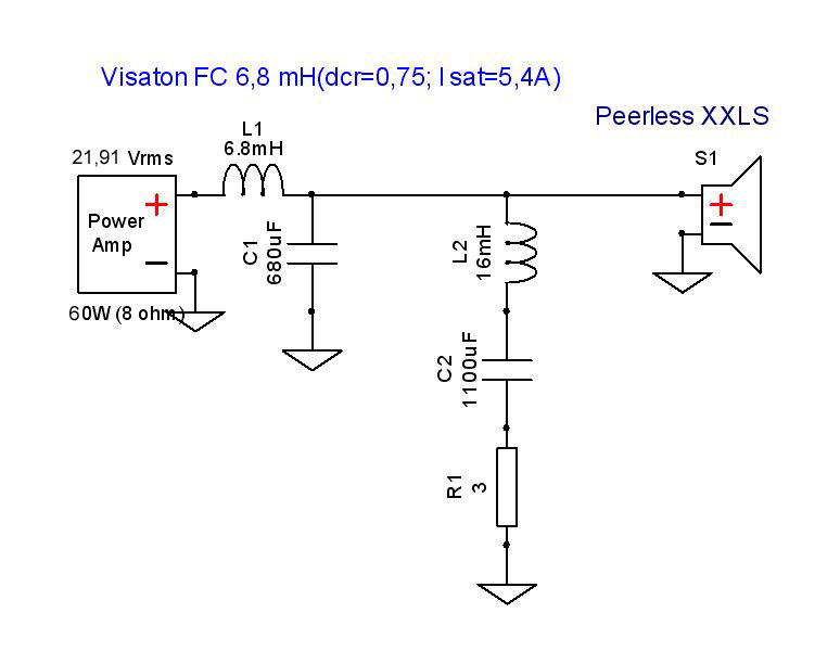

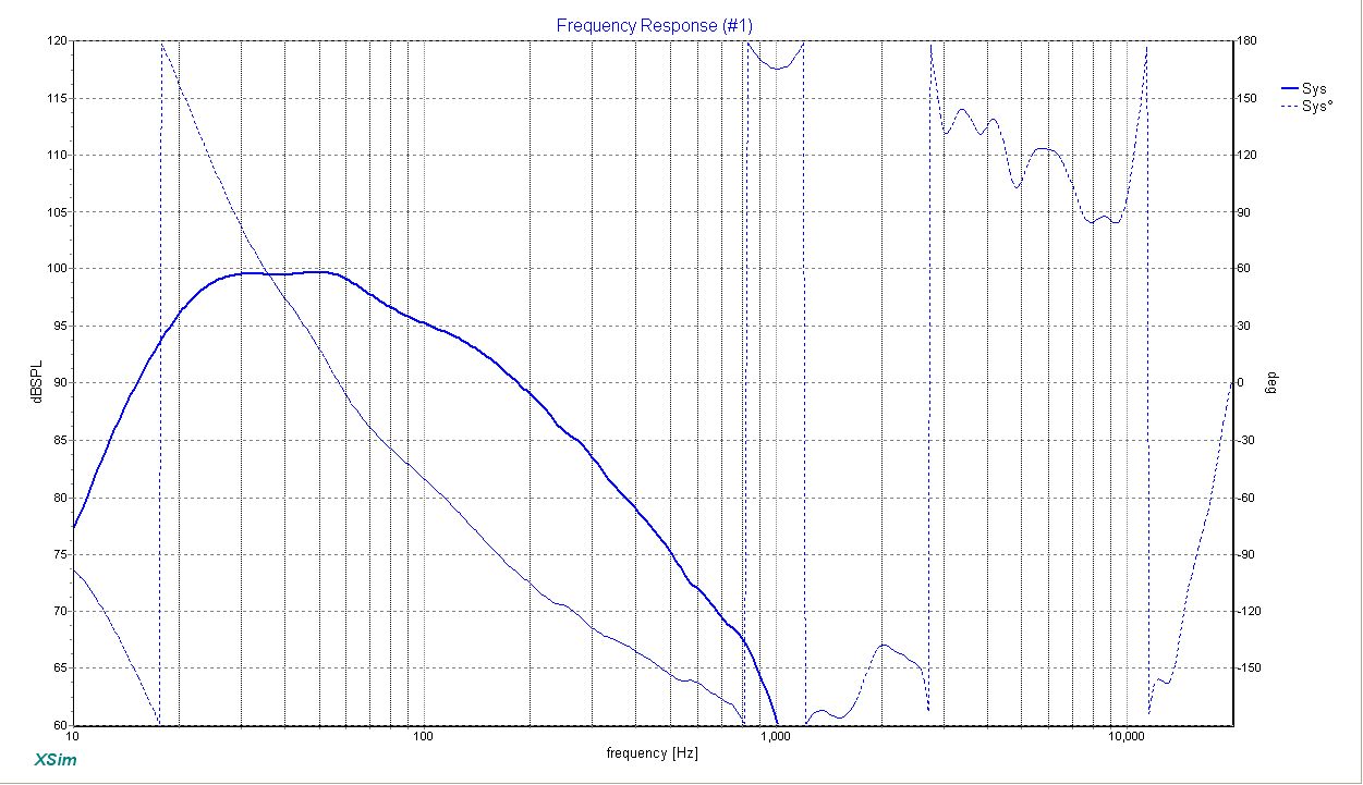

It depends on the implementation. Very interesting as an excercise
is this sim of the Peerless XXLS in a 100 litre BR cabinet. Although
Bill's XSim shows Current peak by default, I have modified the voltage
input to meet the Current graph show actual Irms values. The red curve
represents ferrite inductor Visaton, the black a driver. It took only 60W
to get 7 Arms through the inductor.
