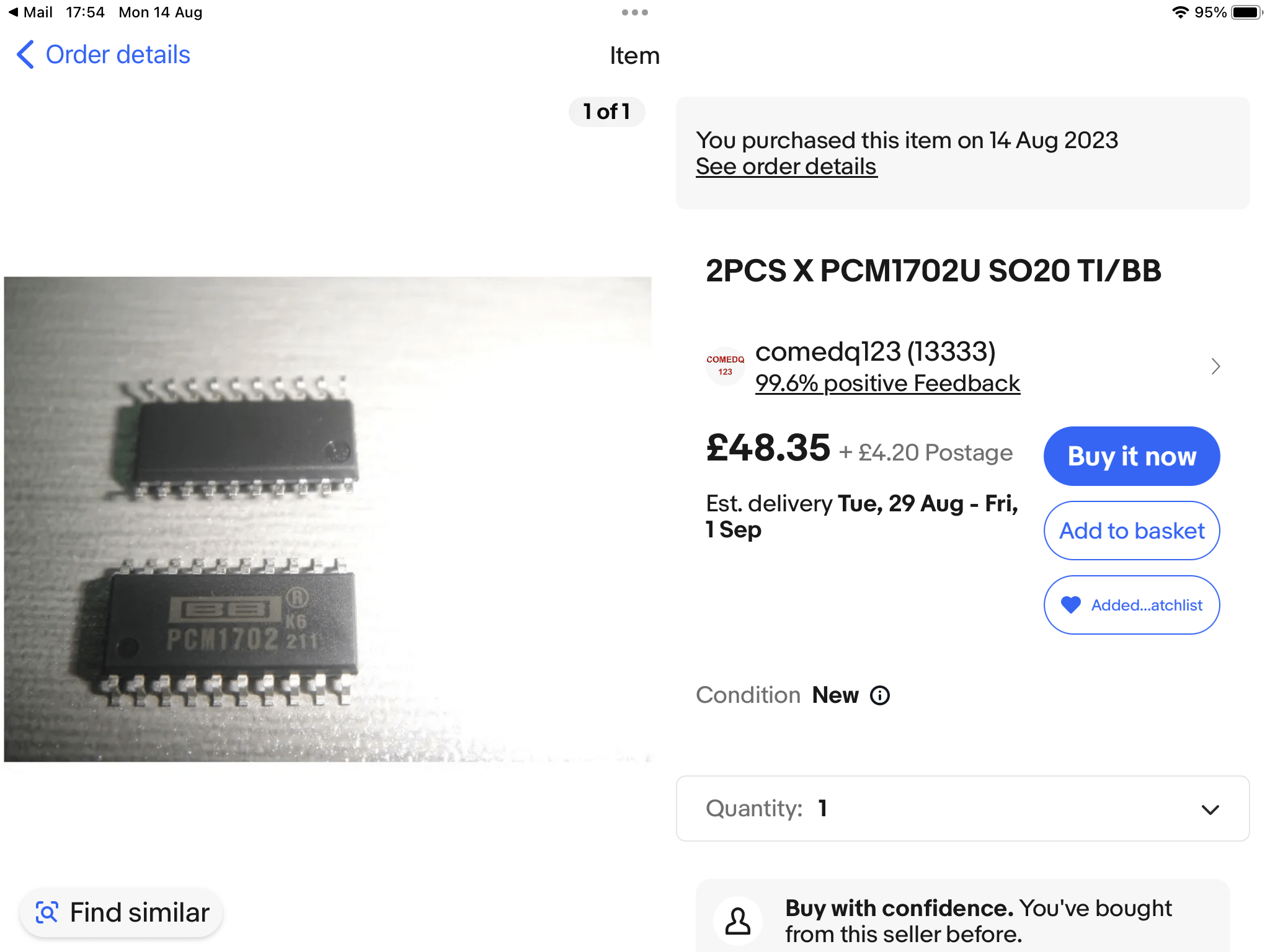

I'm looking to obtain one or two PCM1702U chips ideally U-K, after researching I understand they are obsolete. I have looked at obtaining an Denon DCD to strip out the original BB 1702. However I subsequently confirmed they don't actually have 1702, a couple of web sites had suggested that they do 🙁 Looking at other devices that might have 1702 its clear they are only on top end kit and as such its not cheap to pick up a retro device only to strip out the DAC's...
I'm based in the UK, has anyone had any luck obtaining copied chips? and if so please let me know.. or does anyone have a couple that are known to work?

Your only choice is checking swap meet here, or any other forum market, and ebay (and the likes). There is no guarantee you will receive a working chip for ebay, especially U variation as smd ones when desoldered (with bad skills, as it usually is) are broken.
That chip is current out chip, and signal is transformed to V via resistor and active stage in your case, opamp. Unfortunatelly you cannot replace it with many (pcm63 yes with an adapter board, but it is even rarer chip).
My suggestion is to look at @miro1360 topic with r2r dacs he created, and go for ad1862 as it is on pair quality chip, which is still available to purchase trough legit channel.

Good point about the U and desoldering 🙂 I have opted to try out ebay… fingers crossed. However the sellers has sold many IC’s and the feedback looks pretty good. Considering some that I have seen. Here’s the details.. I’ll feedback on the quality once installed…

The schematic you posted is the same as I have in the service manual of the Yamaha Clavinova CLP-970 digital piano that I'm trying to repair.
I've ordered 2x PCM1702U on aliexpress before Christmas, received them, and now I'm going to have them soldered by a professional (I'm no good in soldering SMDs). Let's hope this solves my problem, as the full motherboard (DM board) is obsolete and not available anymore...😢
