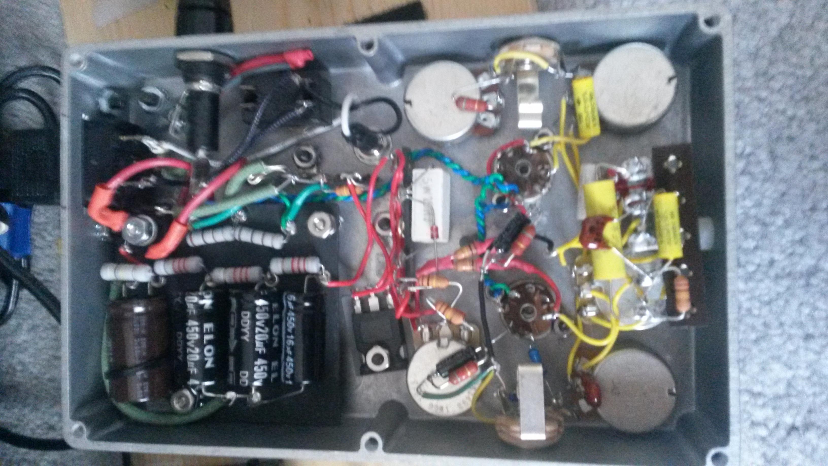

I'm building a fender style tube-preamp with a Hammond 269bx PT, which is rated for 300v at 86ma on the hv secondary and 6.3v/2A on the filament winding. All in all it is up and running great when plugged into my 3 watt hi-fi tube amp. Now, I'd like to integrate an overdrive circuit that will require 9 volts, and would like to source it from one of the PT windings, both of which are underutilized as the only load is two 6av6 tubes (basically a 12ax7, but in individual tubes and not a dual-triode, so just a few ma on the hv and 600-600 ma on the heater winding). My overdrive will only require 4-5 ma. I was thinking of tapping the 6.3 volt winding, possibly with a voltage doubler, but if there was a way to use the main supply without having to drop voltage across a high value resistor it would be great. Best still if the solution has the smallest possible footprint. Any suggestions?

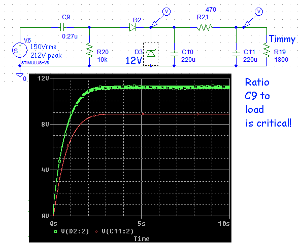

"1800 Ohms" is 9V 5mA, an approximation to the Timmy circuit.
Sleeping on it, I realize the LM386 is not a constant resistance. About 20% of the current is resistive, but maybe 80% is "constant current", the power stage bias which is not real supply-sensitive.
With a steady voltage supply, this does not matter. But this capacitor-feed scheme is more "steady current".
The worst feature of the steady-current approach is that if the load is disconnected, the output SOARS, to over 200VDC in this case. Current available falls as voltage soars, so is not a serious shock risk, but the caps could burst. That's why a 12V Zener. With normal load this never does anything, but with light load it keeps things un-soared.
The LM386 is happy from 4V to 12V supply (with varying clip-level) so I'm not worried about it or the JFET. But it is never going to hit "9.0V" except by accident.
"C9" must be very generously over-rated. 400VDC rating may not be enough for 150VAC with steady high current (heating) in the cap. 0.27uFd 600V gets to be a fairly expensive part(s).
After sleep, I do prefer the Power Brick approach, a known-good low-risk supply.

Thanks for putting so much thought into this. I was leaning toward the brick myself. Attached is a pic for reference. Right now there is no bass pot (fixed 20k resistor instead) , but I'm putting that back in, and moving the mid pot (the one with a single yellow cap above its terminals) to where the little red switch is (from my other thread, it adds the .047 in parallel with the .022 tone cap to shift the scoop from 700 too 400hz approx). Then, I'm going to put that cap mod on a slider switch on the front of the "pedal" and if I'm successful with the overdrive circuit, put that on another slider on the front (the two will be to the left and right of the nylon nut holding the tone stack terminal strip in place). So real-estate is at a premium, and the brick option will work very well in that regard.

Thanks for the tip! I say it will live on my board, but it's just a convenience board. I'm not an actual gigging musician, so a slider switch will be fine in my apartment, and one less patch cable to ocd over. FWIW, I'll be using an LM1458. It and the JRC4559 are, as I understand, the main ones associated with the Timmy but this project is my introduction to op amps and, for that matter, solid state devices in general other than using MOSFETS for VVR (which you may have spotted in the picture) so I've quite a bit to learn about differences there.
