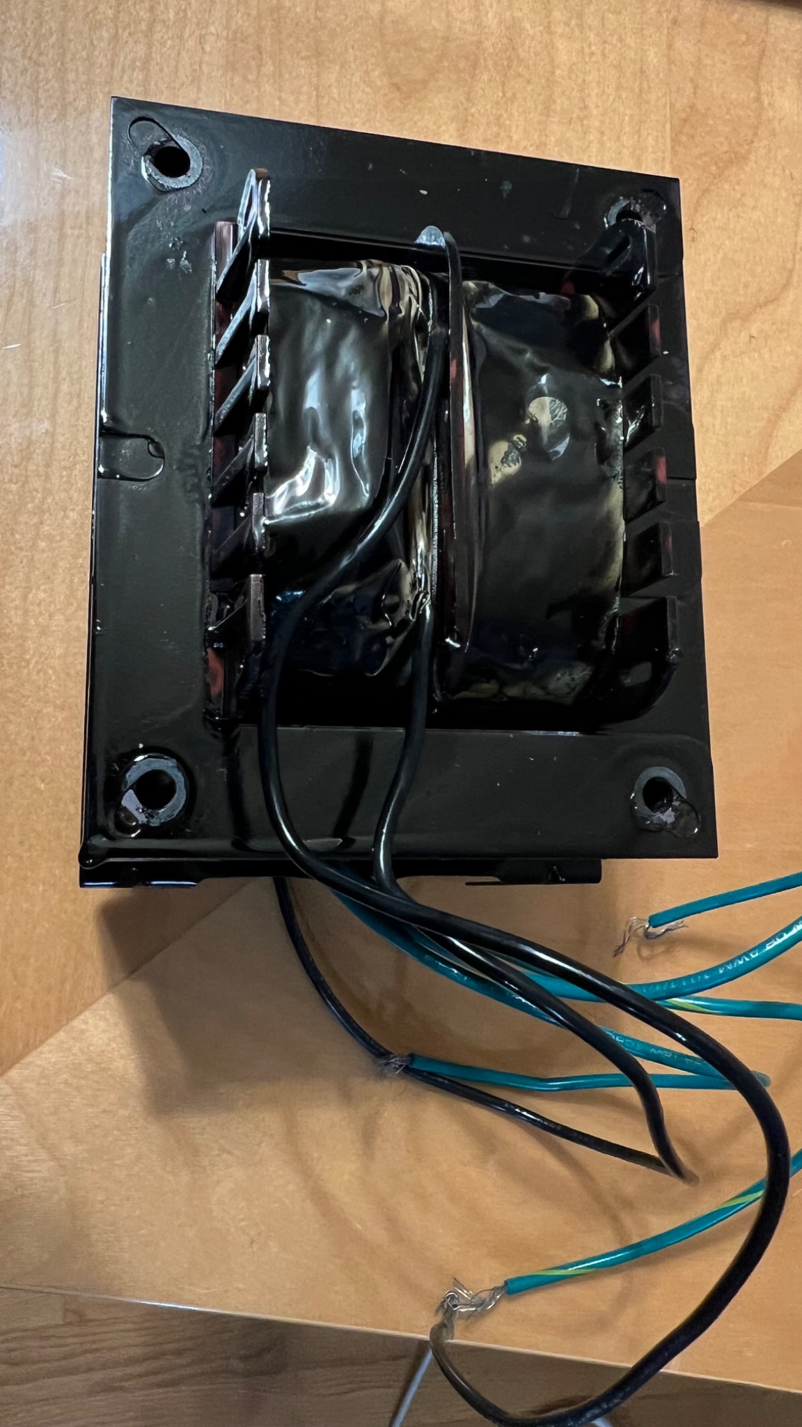

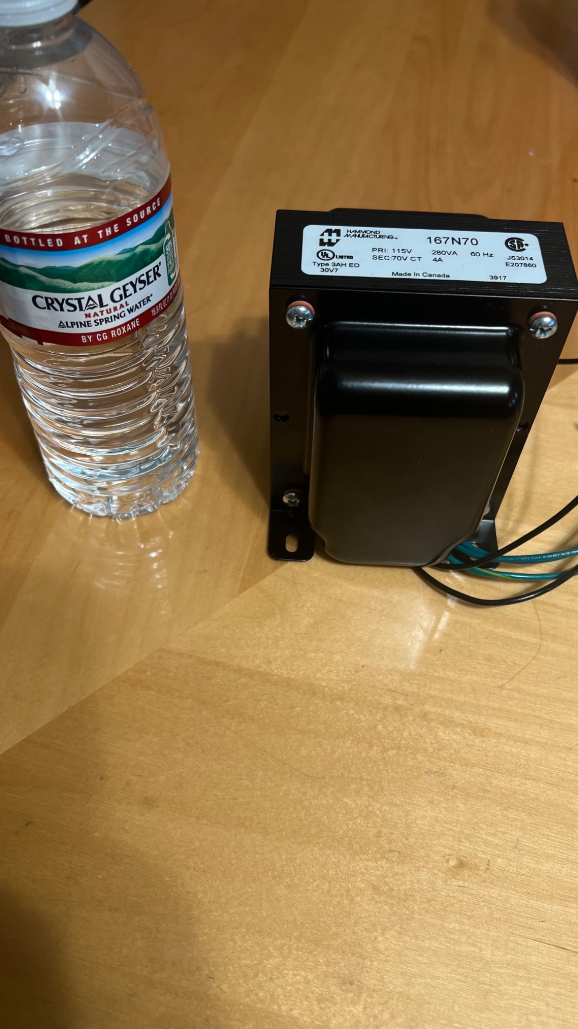

Sources for EI Transformers, 22V x2, 300-400VA?

Thank you so much for taking the time to reply! I’ll have a look.
Viewing their datasheet schematic, the secondary is center tapped (C.T as they label it). I take it that indicates 22V C.T is “11V-0-11V”, or am I mistaken here?
Triad makes those split bobbin transformers too, and may have a decent size 44VCT. The quality isn’t bad, but the regulation is poor. Difference between no load and full load is like 20%, even for the big ones. Concentric EI will do better, but nowhere near the hi-pot capability.
YOU are correct, the transformer in the picture is 70V CT,
you have to contact them for the 44v CT. They are already kind of expensive, I can imagine that the custom ones will be at least double,
