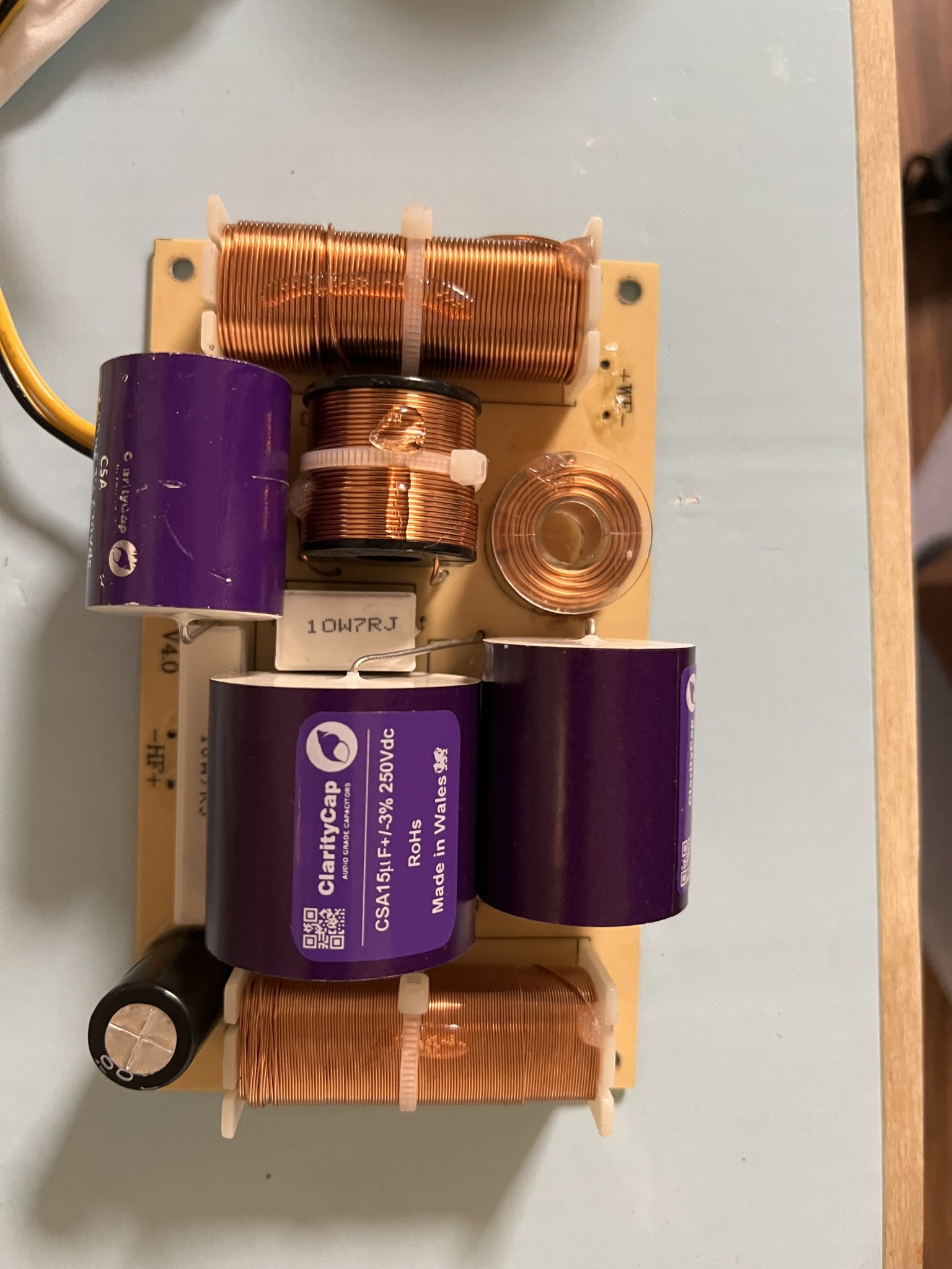

Any ideas for the smaller 2uF capacitor? The one in the crossover is so small and the ones that I find are so big lol
Potentially, smaller capacitors can be better, but in this case it’s not likely to make a difference.
I swapped out the main caps. There isn't really much room to change the radial for an axial one so I left it there for now. They all just fit on the board right now. I only got one speaker swapped so far, will have to do the other later tonight. One thing I came across that I didn't expect was everything was glued to the board so I had to buy a heat gun to get the stock caps off.
Before doing the other speaker, I would compare the re-capped loudspeaker with it to gauge the extent of the audible improvement.
Do tell us what your listening reveals.

Surprised to see the same value Jantzen for less.I totally agree. Our friend driftingbunnies should therefore search for inexpensive MKP capacitors to replace the MET types currently fitted.
I would not regard the 68 uF Solen MKP capacitor you pictured as being cheap at around $25 a pop, but needs must!
https://www.parts-express.com/Audyn-Cap-Q4-68uF-400V-MKP-Foil-Capacitor-027-123?quantity=1
https://www.parts-express.com/Jantzen-0286-68uF-400V-Crosscap-Capacitor-027-952
Would have to keep the XO external if I wanted to fit that 68uF cap in there. It's already a pretty snug fit with all the other ones
The most significant issue I see in the stock crossover is the steel core inductor in series with the woofer - the top inductor in post #26. Changing that out for a heavy gauge air core inductor probably will make the most significant improvement to sound quality. Such an inductor will not fit on the PCB. I would add extension leads to it to allow it to be mounted inside the cabinet somewhere near the crossover. Keep it perpendicular to whatever inductor(s) happen to be closest to it. Just don't mount it with anything ferromagnetic. Maybe hot melt and a nylon strap of some kind.
