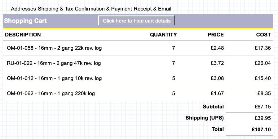

I've decided to build Steve Dove's 5 band EQ that was published in Studio Sound back in 1981 (Part Nine, Equalizers 3). But, I cant find a source for the potentiometers, dual, antilog, 10K, 22K, 47K and 220K. Schematic attached.
The usual suspects, like Digikey and Mouser, don't have. Any suggestions?

I recall that BI/TT electronics had some, but they might only be available from Mouser in 50k resistance.
Other (non-stupid) options are Omeg (https://www.omeg.co.uk/).
You can try State Electronics to see if they have anything suitable in stock, and you might be able to buy a small quantity at reasonable price. Don't count on it though - last time I contacted them the cheapest option was to buy 250 pots at a cost of $9,000. Not very friendly for a dude in his basement.

http://www.audiomaintenance.com/
https://capi-gear.com/catalog/
https://www.studioelectronics.biz/sunshop/
Good luck. This is probably the most difficult part to find if you're building an EQ.

www.audiomaintenance.com had all hard to find potentiometers.

Glad you found them, and for a reasonable price 🙂
If not, I would have suggested using easy to find straight Log ones, and reverse the scale on the front panel, easy thing on a DIY unit.
Another solution is to put the frequency scale on the knob, not on the panel. The scale looks right since it goes clockwise; I think I saw that on a function generator.
